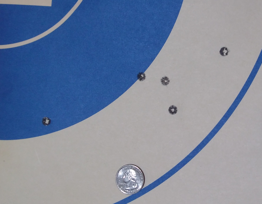

I have a Spuhr.....but I never use the level....I can't see it. I really have to bring my head up and look for it. Mostly hidden and hard to read. If I had to make weight...it would probably be the first thing I popped out. In the below pic....canting was not my issue....it was a tricky 7 to 5 o'clock 15mph switchy wind on my 1000 yard target. 300PRC shooting with an Atlas CAL and a PU ELR Bag.
