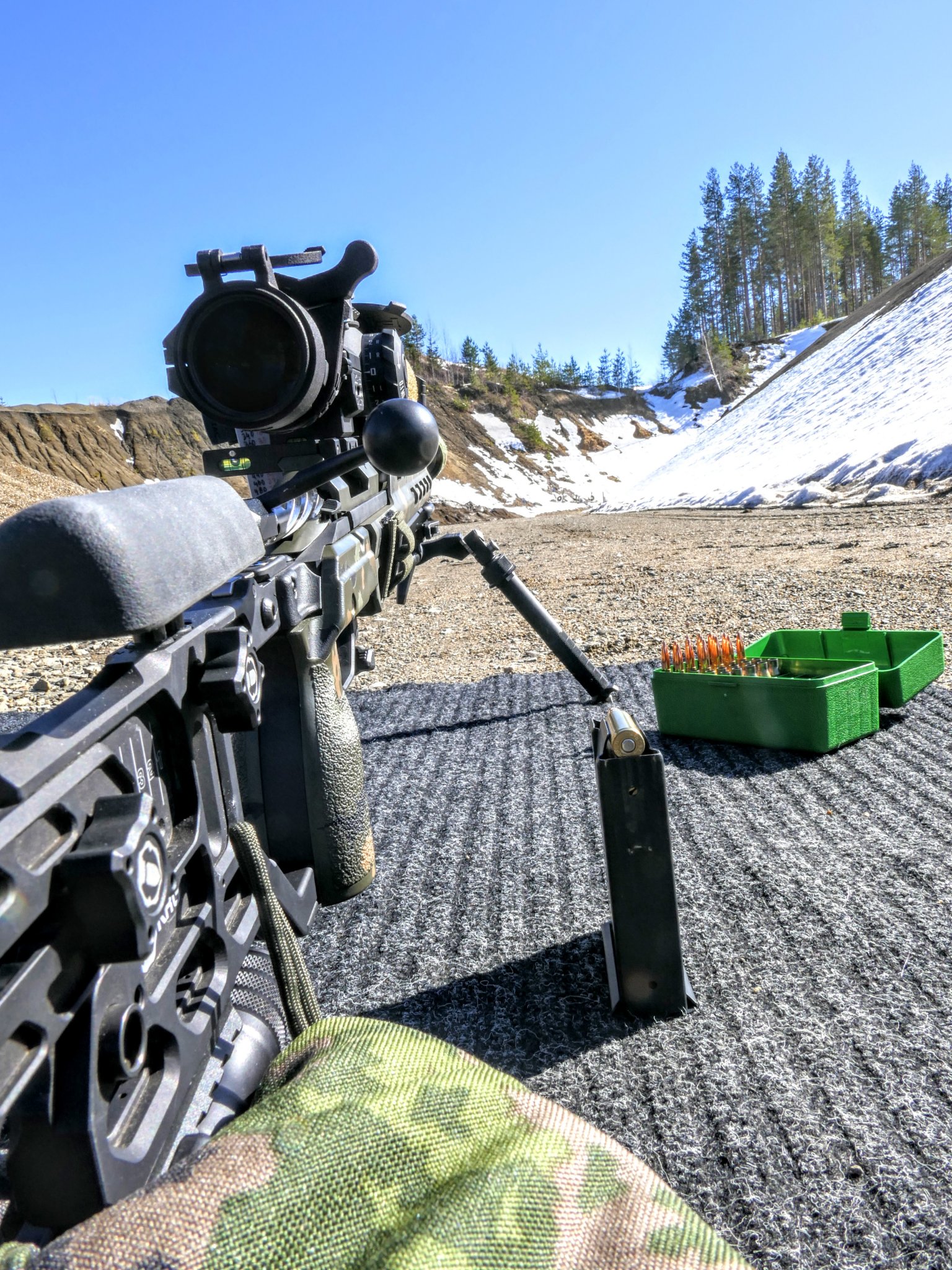

I even found my not-especially-massive MKM level to be in the way behind the turrets so put it in front. No downsides as long as it's designed for that (sticks out up at 10:30 or so) and should be easy to change. Just clamp up the gun so the current level says it's level, note HOW level (where the bubble is inside the ticks: there is some tolerance and the clamping likely is imperfect), unbolt the level, move it, and tighten, checking regularly that the new bubble position matches the old.
I'd also double check with a second bubble on the turret top, or so on, but should be easy. 2 minutes if you take your time.

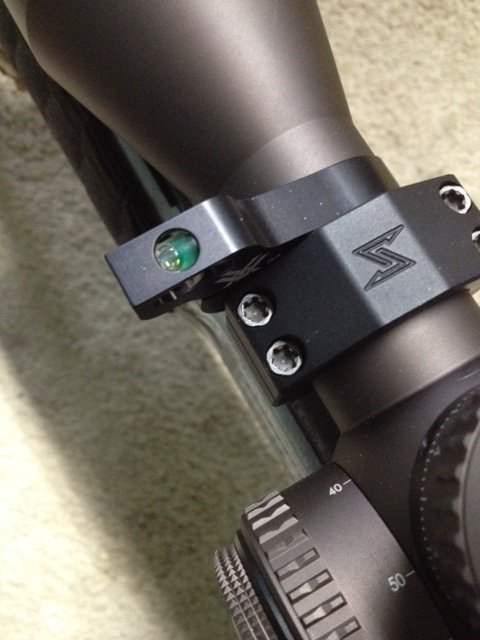

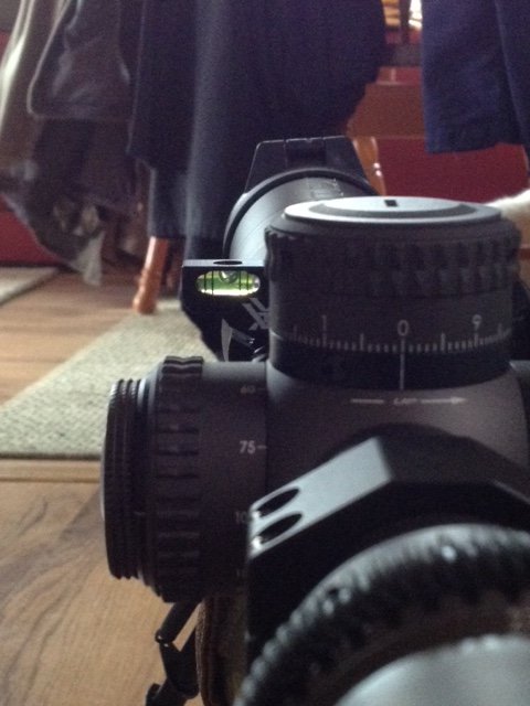

For the OP: I prefer the level out in front of the turret and further away from my eye, I shoot both eyes open and I think having it further away makes it easier to monitor the level just by switching my focus. I actually hate when the level is closer to the back of the scope.

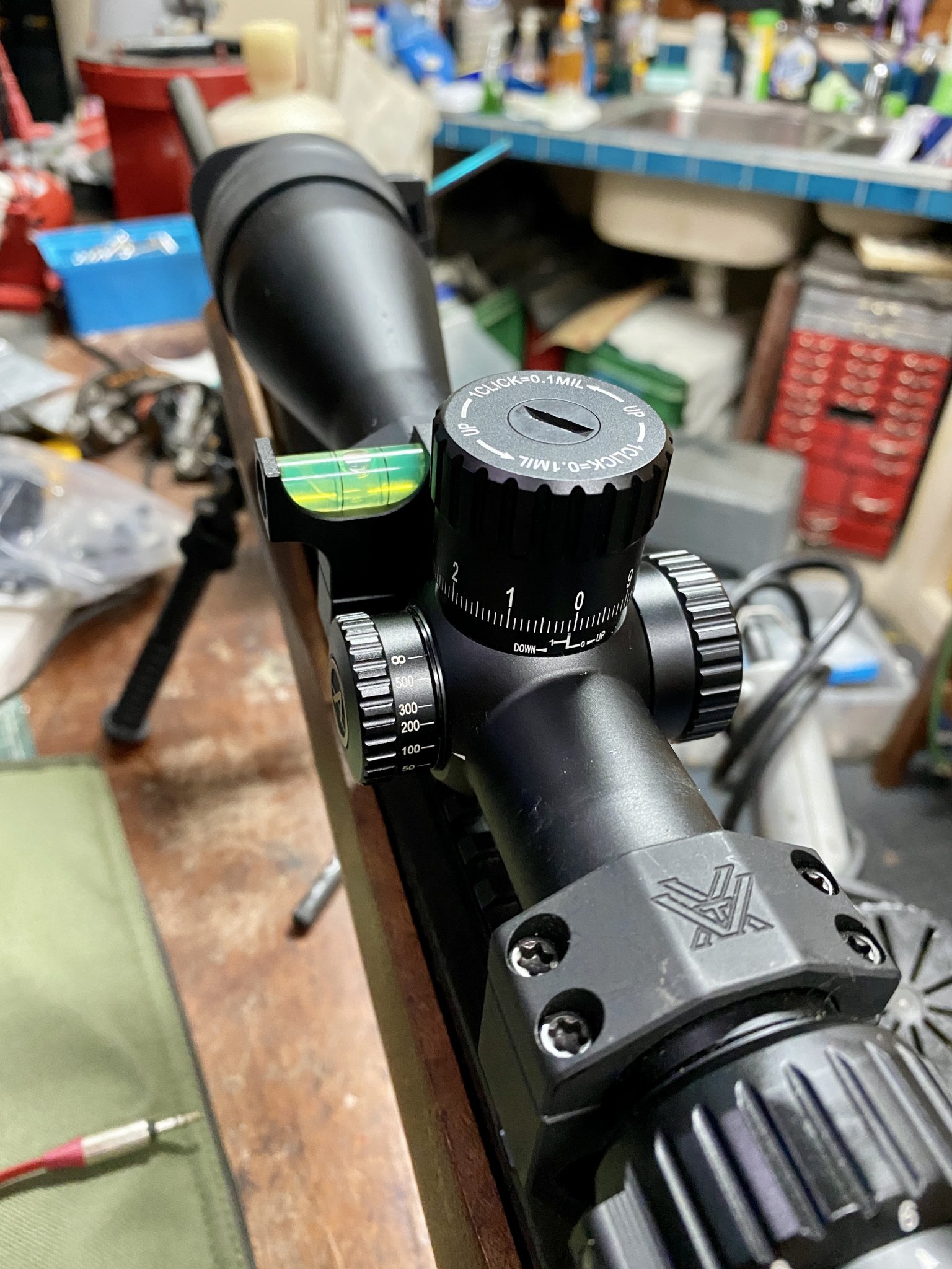

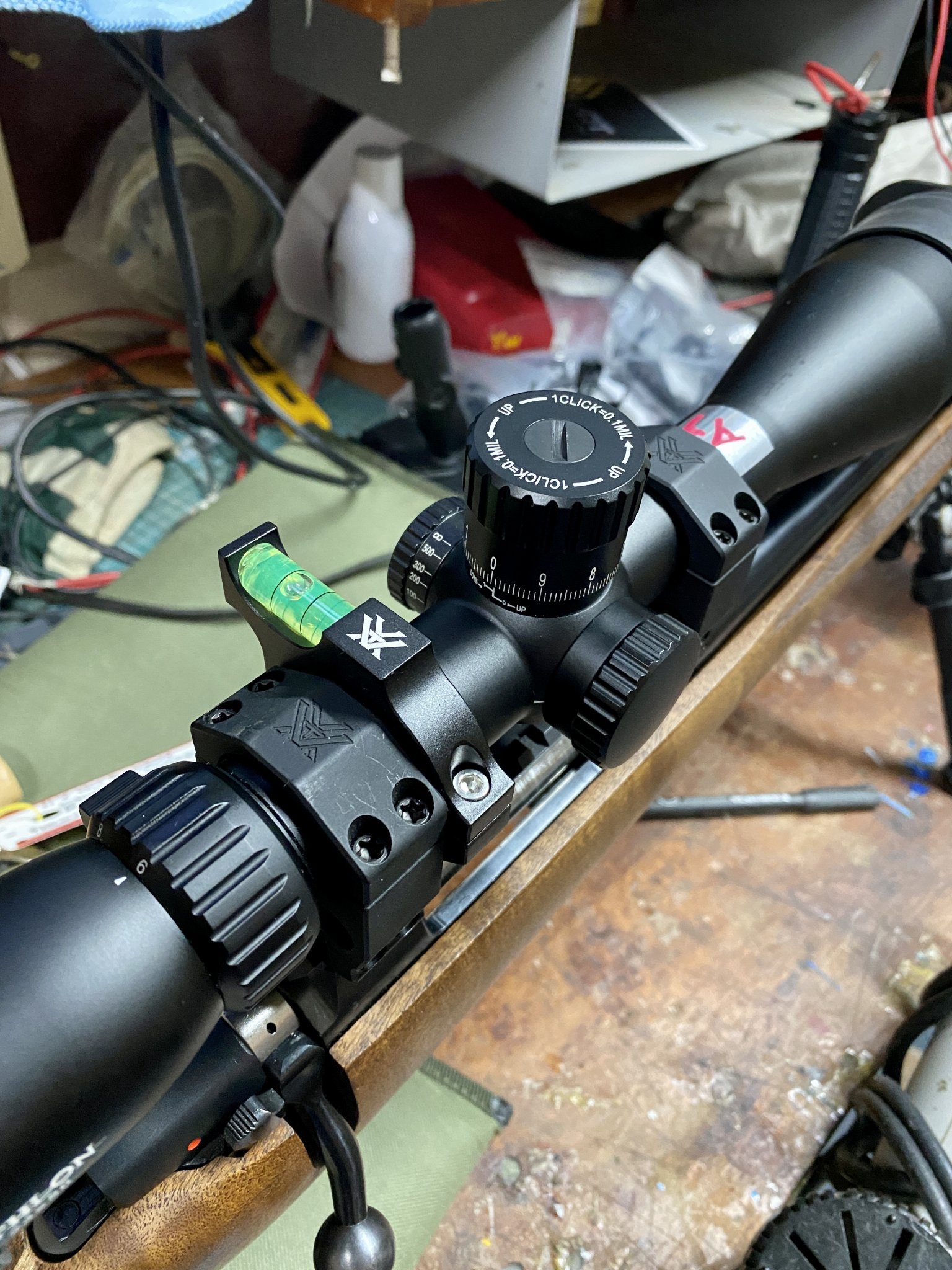

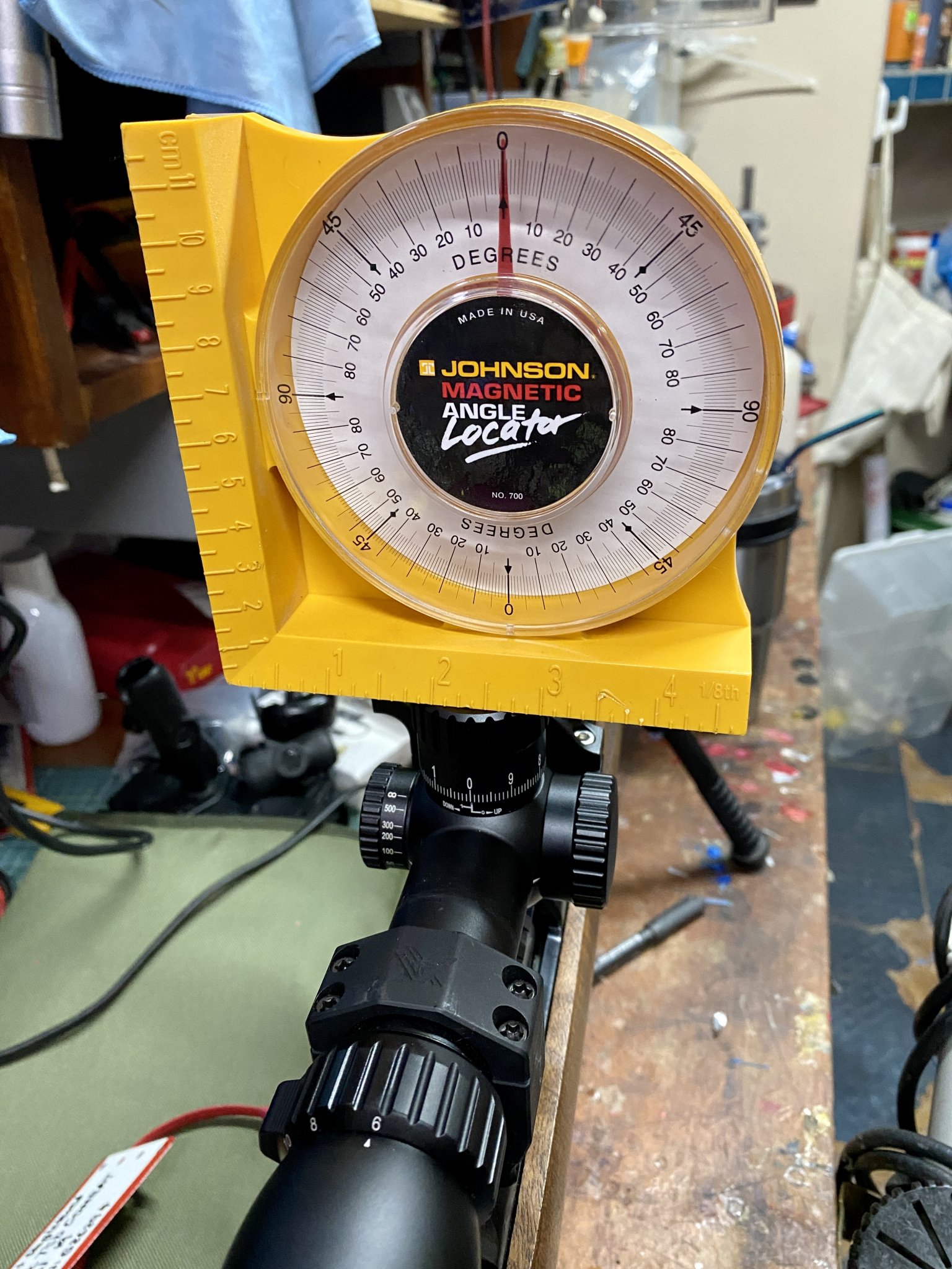

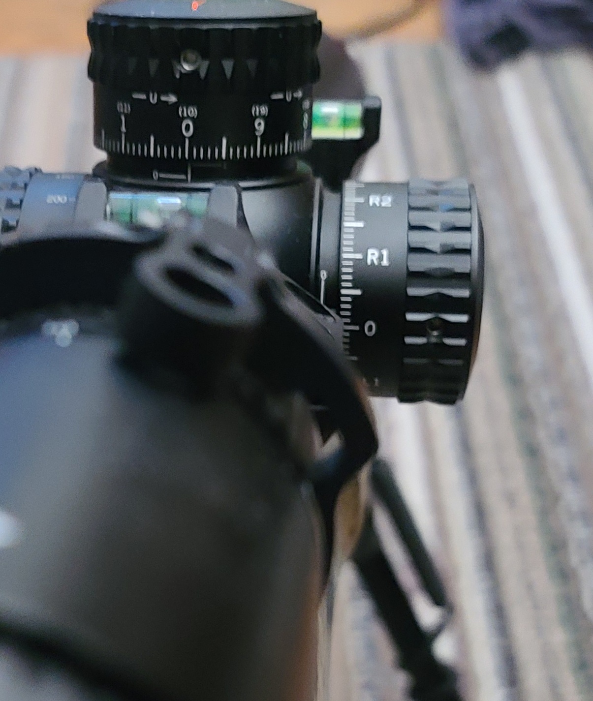

I moved it. The process requires care, but that's why we have rifles right? Pics are before, during and after.

MKmachining picatinny buble is also great, no need to be afraid to make the change on place of it.
Greatly told the cant and how it efect.
Check this video, different calibers on 1000 yard, how much does 1 degree makes on impact.

I put the full-size Vortex bubble in front of the turret - indeed, in front of the front rings, about 1/4" behind the objective bell flare. You'll be able to see it fine while you're fully in the gun because it sticks out so far. I put mine way out there because I've had cataract surgery; ideally the bubble would be out near the muzzle and I'd be able to focus on it more clearly...

You mean people actually put them blocking the turrets?
Yup. A lot believe that you can't see the bubble on the other side of the parallax knob or they buy shit levels that don't allow them to be seen.
Pointed this out in a few other forums where guys told me I was lying. One guy straight up got in a pissing match with me. I posted photos of how visible the bubble was and he told me I was doing trick photography to make it look better than it was. He then told me I would have to break my cheek weld to see it.
Ah, i have the billet alloy, that is death straight, i have Audere mount that has also a small buble, it is same lelel on MKmachining level as is the mount buble.
