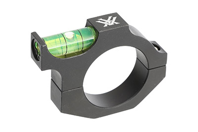

I've watched a lot of his videos, have followed his channel for several years. I don't think he's being deceptive, but he's also laying prone on relatively flat terrain, looking at a familiar view with lots of trees (good vertical indicators), with plenty of time to really stop and dial in his "vertical feel". If you start to take away those foundational things you start to erode your ability to get a true vertical.
As far as the "more accurate" part, I would point back at my comments about bubble level sensitivity and that you can't be any more accurate than you can move the gun. The bubble level he showed in the video wasn't the greatest design, nor was it in the right place to view without breaking a cheek weld. There are crappy bubble levels out there, and Frank is right to be critical of them. In my experience the plain jane Vortex bubble level is quite sensitive, easy to see, and is cheap.
Agree that to train, train, train is the best answer. But if you don't have a bubble level, how can you judge whether you are training to the correct standard or whether you are successful in your training?

I'll say this again in case anyone missed my first comment. The bubble level is just a verification tool. I verify every shot, Sometimes I am wrong, and that's why I verify. It's really just that simple.

I like it Sheldon, I think this is the most descriptive response I've seen to the subject, thank you for clarifying. It helps to educate me and others.

If nothing else, I recommend that you have a level attached to your scope tube in one way or another so if you move it to another rifle or you unbolt it and move it back and forth to adjust eye relief or whatever that you don't have to start over with another plumb line.
Do it with the plumb line the first go-around, attach a simple bubble to the scope and leave it. Saves future hassles.
Get a Sendit level. It has become one of my favorite pieces of kit ive bought in a while. I dont look at anything but my target and can tell you if im canted right, left, or im plumb.
