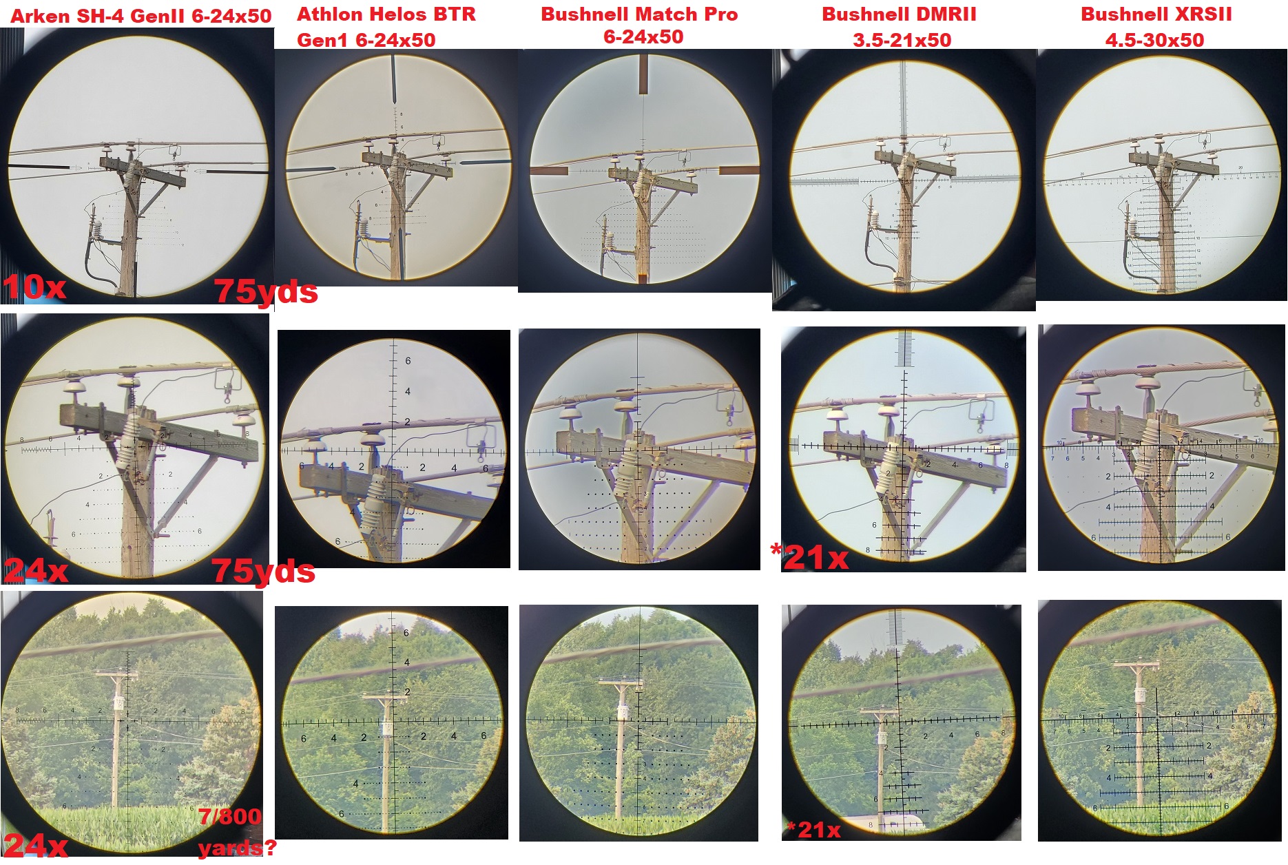

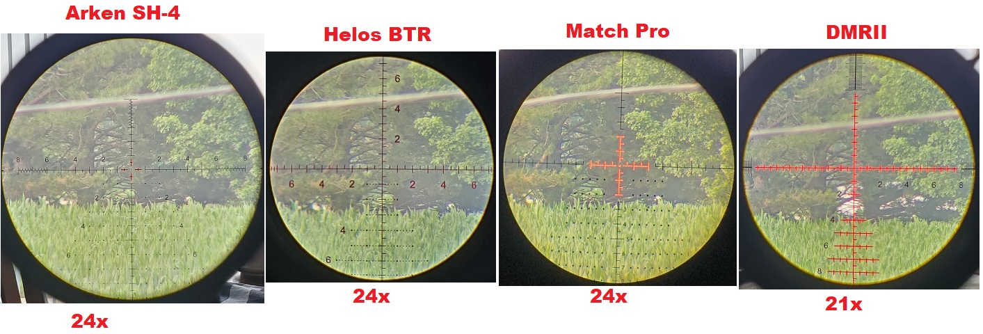

I have both scopes. I am not an optics expert, just a regular guy. I realize some of this stuff won't apply to the OP's needs, but I might as well throw it all out there.
Glass quality: Even
I can't definitively say one is far superior to the other, they're both pretty damn good for "budget" scopes. This is subjective and just my opinion.
Eyebox: Even
- Haven't noticed one better/worse than the other. Also subjective and my viewpoint.
Reticle: Arken (but would be personal preference)
- For precision work, due to thinner lines and smaller center dot. The Match Pro is a thicker reticle, but still useable.
Illumination: Match Pro
- It's very bright, some might consider it "daylight bright". I've used it during an NRL22 match with no issues. The Arken is only useable in lower light conditions.
Turrets: Personal preference
- Match Pro has 10 mil per revolution, adjustments are very positive/tactile, but the detents are also spaced very close together so it's fairly easy to over dial. They lock and are SUPER easy to reset to zero, but no zero-stop. The numbers are smaller and harder to read.
- Arken has huge knobs, only has 8 mil per revolution, adjustments are very positive/tactile and the detents are widely spaced. The turrets are non-locking, but there is a zero-stop. Resetting the turrets to zero isn't difficult, but it does require loosening/tightening 3 set screws. The numbers are huge and easy to read.
Parallax: Match Pro
- The adjustment goes down to 10 yards and the settings are true to actual yardage, but the dial is fairly stiff. The Arken only goes down to 25 yards, the dial is easier to rotate and the numbers easier to read, but they don't match the actual yardage for me.
Elevation (internal travel) : Arken
- Advertised at 32 MIL, but mine has 35.6 actual MIL. The Match Pro is advertised at 18 MIL and mine has 18.1 MIL.
Field of view: Arken
- 34mm tube on the Arken vs 30mm on the Match Pro.
Misc:
- I love the Arken flip caps because they have several notches and will fold completely flat against the scope, that's nice for NRL22, especially when engaging ladder rungs.
- The Arken magnification ring rotation is backwards from my other scopes.
- You have to buy the sunshade and flip caps separate for either scope. The Arken does come with rubber bikini covers though.
- Arken sells a nice aluminum throw lever that fits/functions great. Had to go aftermarket for the Match Pro with a MK Machining lever and I had to add a piece of electrical tape on the inside to get a tight fit on the magnification ring.
If I think of something else, I'll revise.
Pics below are with a smartphone camera and the brightness of the image can be deceiving due to how the camera was positioned.

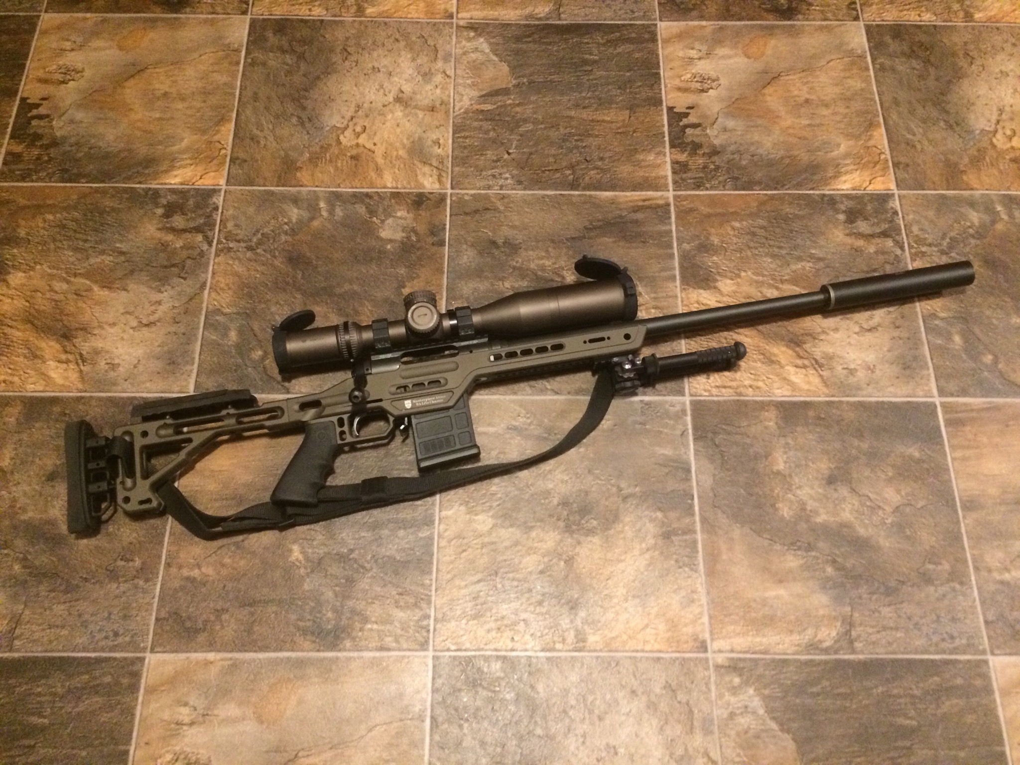

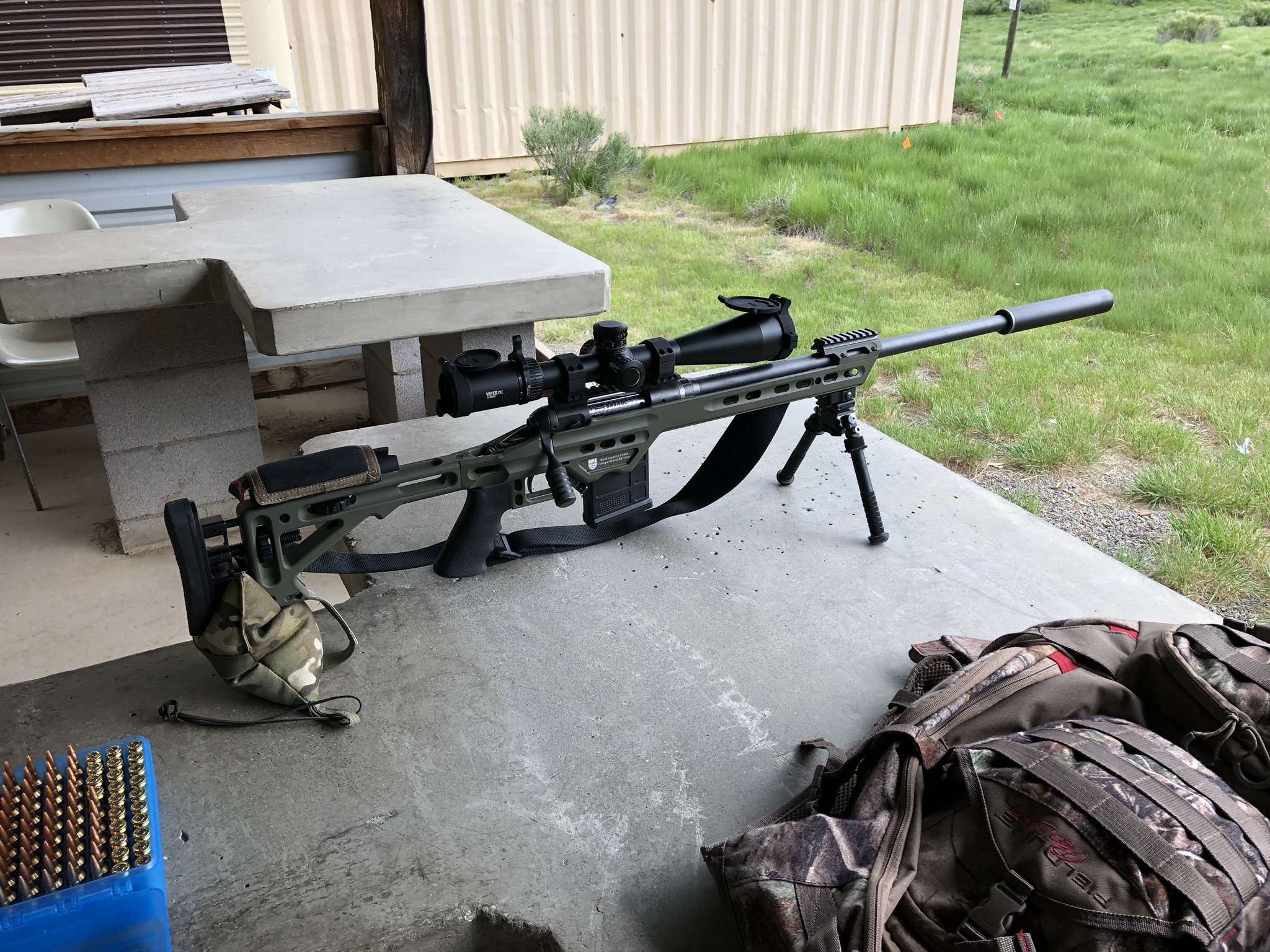

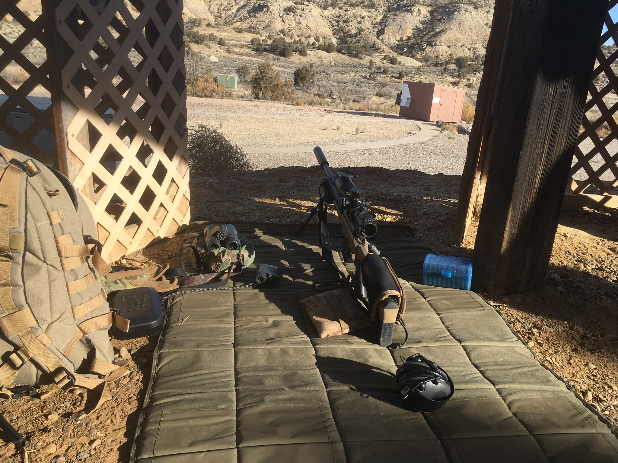

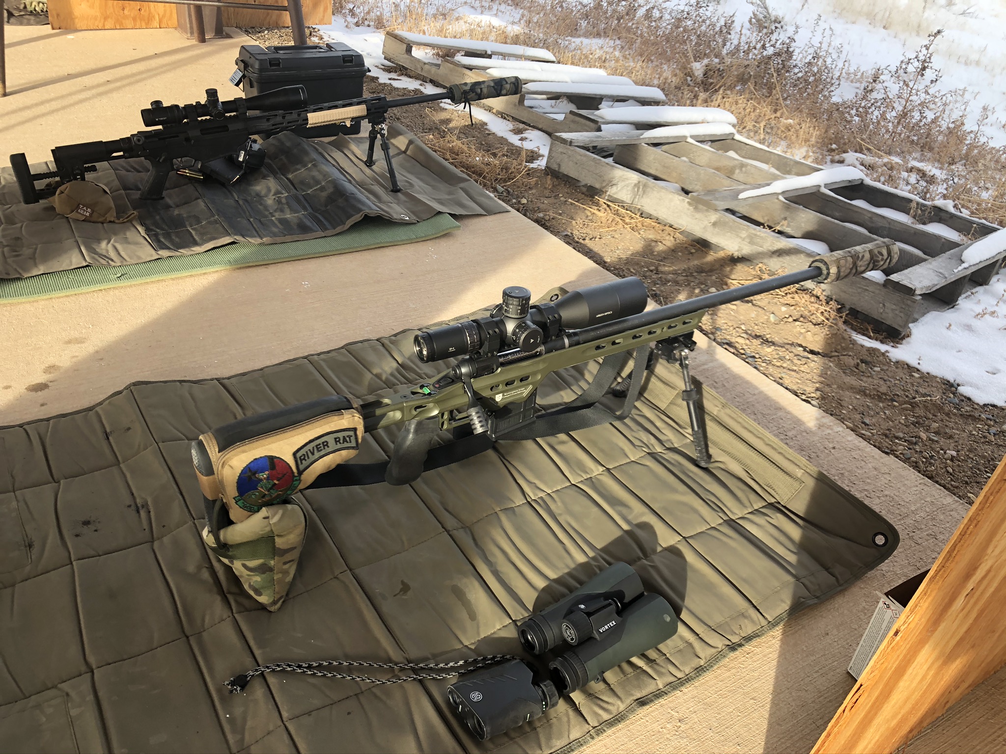

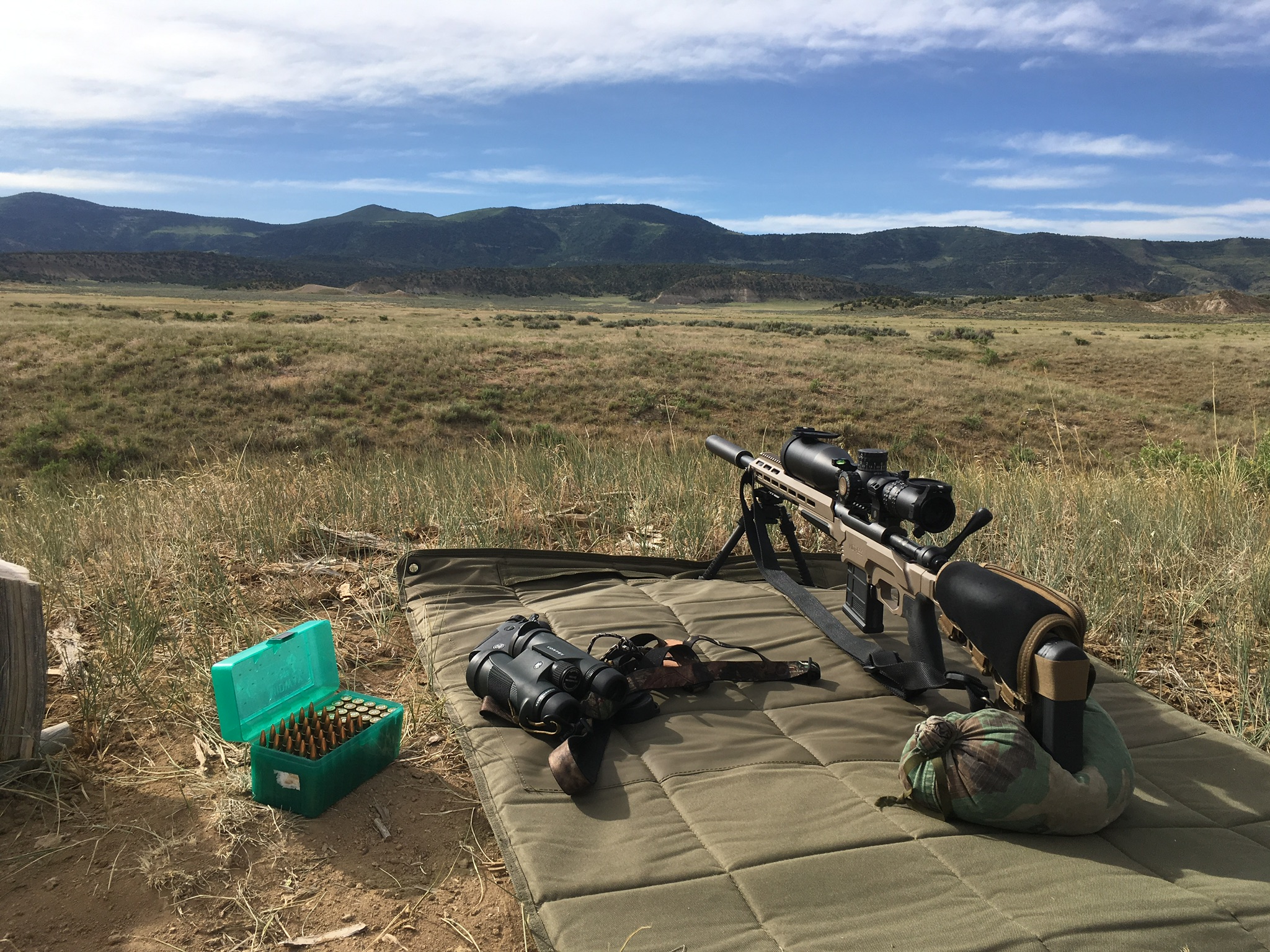

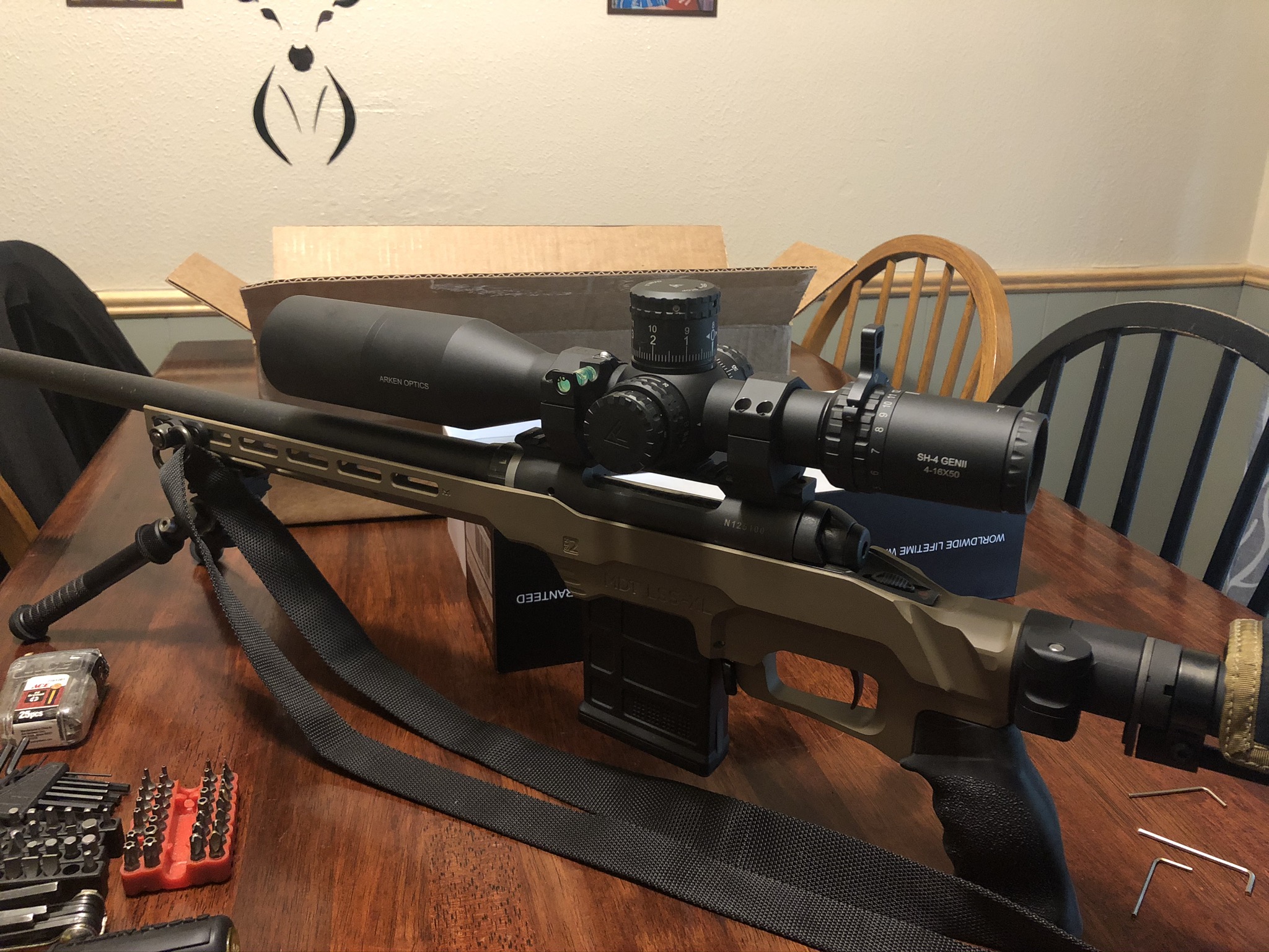

Since you doubted that I have owned all of those different tiers of glass…
And now I own Arkens. My dime, my choice.
