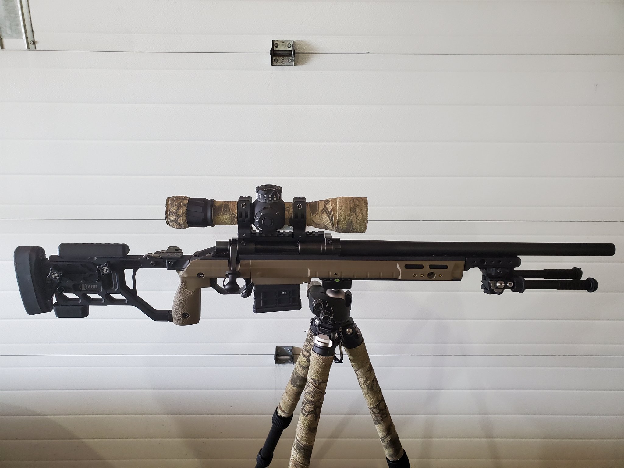

If it helps at all, the rifle pictured here is an ARC Nucleus 1.0 with a 20" IBI 223 rem Savage prefit barrel finished at 0.86" at the muzzle. It comes in at around 13-13.5lbs without the bipod and a few things added to the ZC420 (caps, level. sunshade). Iirc, the KRG W3 is around 4.75lbs with the arca rail and spigot on it. This same rifle with a Gen II on top comes in at 14.8lbs. Could easily chop 2-3lbs off with a slightly thinner barrel and lighter chassis.

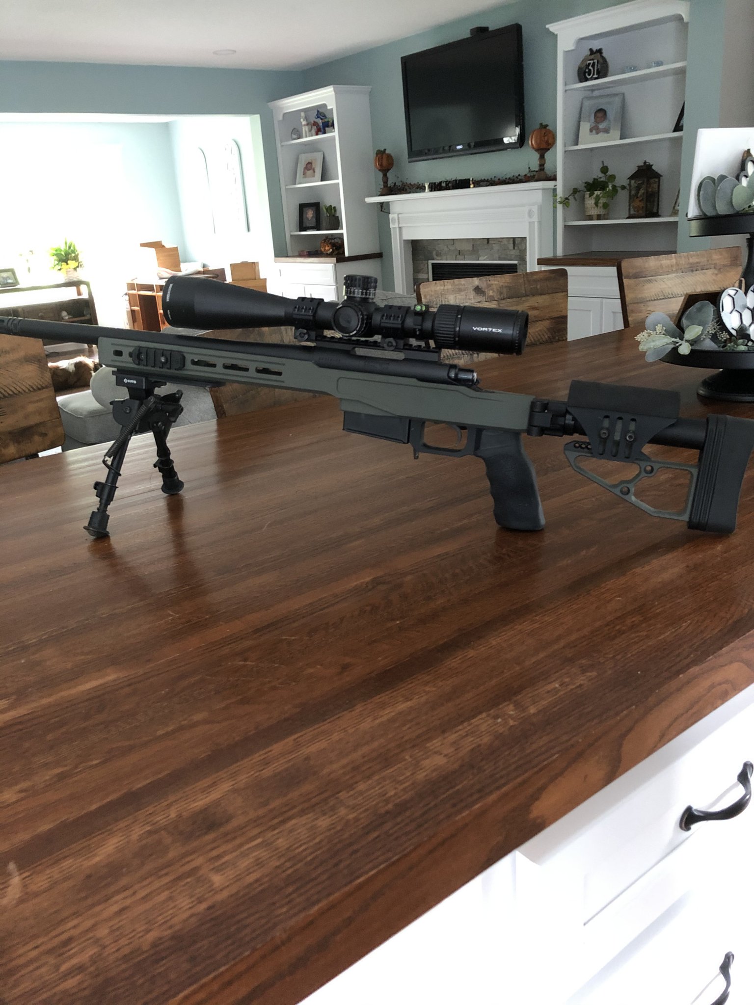

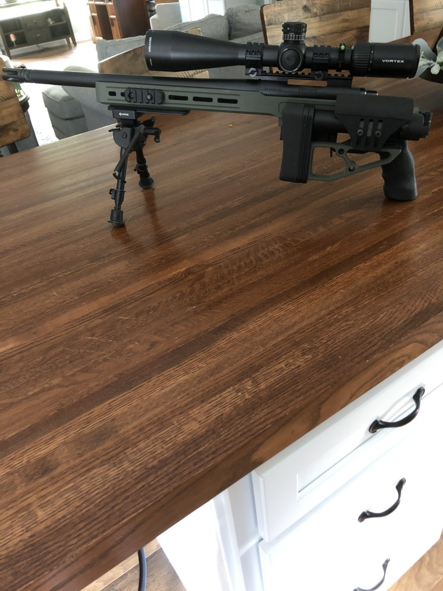

I just did a father/son gun for my oldest (7). It scales at around 9.5 lbs, so it's a heavyweight for him and a middle weight for me.
ARC Nuc G2
Manners CS-2 CF (elite) - this right here is money; adjustable LOP all the way down to like 10" or AR length gets my son comfortably behind the gun
Proof CF 6.5 CM @ 20", PBB Steel (chambered/threaded by DST) .223 Rem @ 18"
Trigger Tech Special, 2-stage
The stock is back at Manners right now to have a mini-chassis put in. I had some issues with the bedding, decided "to hell with it" and changed directions entirely on that. Whether on bags or off the bipod, the CS-2 (really just a T2 with adjustable LOP) is great to work with. Plenty of real estate up front, weighs "only" about 2.75 lbs. Only grip is that a CS-2 and CF barrel leave it a little rear heavy for me. That does, however, make it easier for my son to maneuver. A steel tube likely puts you in around 11.5 - 12 lbs for the same gun (assuming you've got around 34 ounces into the optic and rings, which is the same direction I went).
