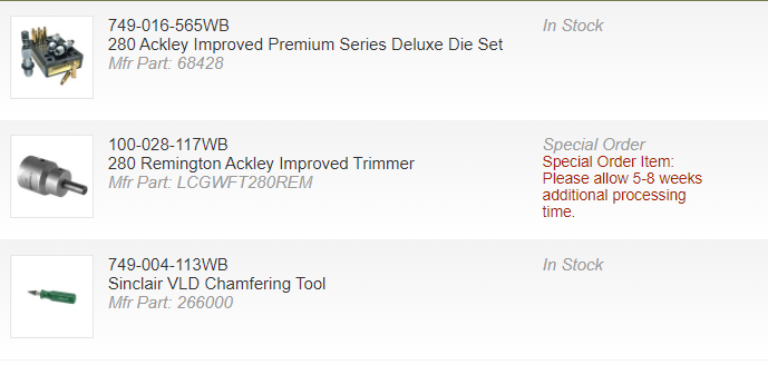

    Here is a picture of what I currently have in my cart on Brownells.

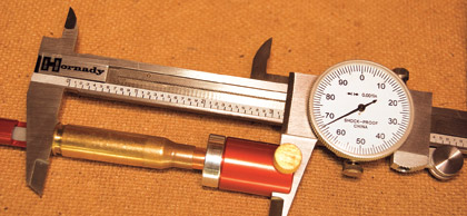

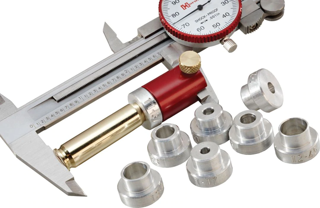

    1.) Yes those are the headspace inserts. So what you need is ONE comparator body, thats the red thing with the brass knob, this goes on your caliper blade. The following inserts go into the comparator body. You need ONE headspace insert for 280 remington or similar case. The headspace inserts are not individual per caliber, they're based on case shape. You need ONE bullet insert, this is caliber based. You'll want the insert for 7mm/28 caliber. You DO NOT need the whole set and you can buy them individually. IF you wnat the whole set, then get it so you can use it for other calibers, but its not needed for only one.
    See pictures below
    This is the bullet comparator. It measures off the OGIVE of a loaded round so you can get proper measurements instead of OAL to the bullet tip, which is less consistent.
    This is the headspace comparator, it measures off the datum line on a case. This will tell you your fired case headspace measurement, and then you bump the case back in the sizing die and measure again. This is used to make sure your cases are sized enough, but not too much or in a random amount.

    K + M chamfering tool instead of sinclair, because k+m has a "stop" on theirs and all cases are chamfered the same........if you go with sinclair , count your turns.
