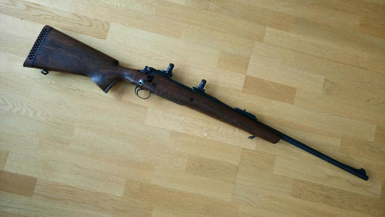

I have an A-Square Hannibal in 338 A-Square Mag, very similar to 338-378 Weatherby. After watching a video from Forgotten Weapons on Youtube about a P14 sniper rifle I sort of figured out it would be fun to make a copy of the WW1 sniper rifle chambered for 338 Lapua. I know it is crazy, but what the hell :)
Any thoughts?
Here's the video:
Here's my rifle and inspiration:

Be very careful I own one in 30-06 and love it. But some of these older rifles had problems with inconsistent heat treating and to make one into a 338 Lapua or more powerful cartridge might be dangerous.
Reactions: sandwarrior
I'd say definitely to check the heat treating out if you plan on doing this. Which factory did it come from?
However, what you have there looks like a very nice custom job in itself. Were I you, I would look around for a butchered donor or a stripped action.

There are some original P14s and P17s floating around in Norway. They are very cheap here. Usually less than $200. Original military rifles are cheap here. I figured I just could modify the magazine, open the boltface and fit a new barrel. I'm going to look for a rifle from Winchester or Remington and get it checked out by competent people.
The most powerful load in a P14 A-Square is the 577 Trex. 750gr bullet at 2450fps. Have a look on Youtube :)
