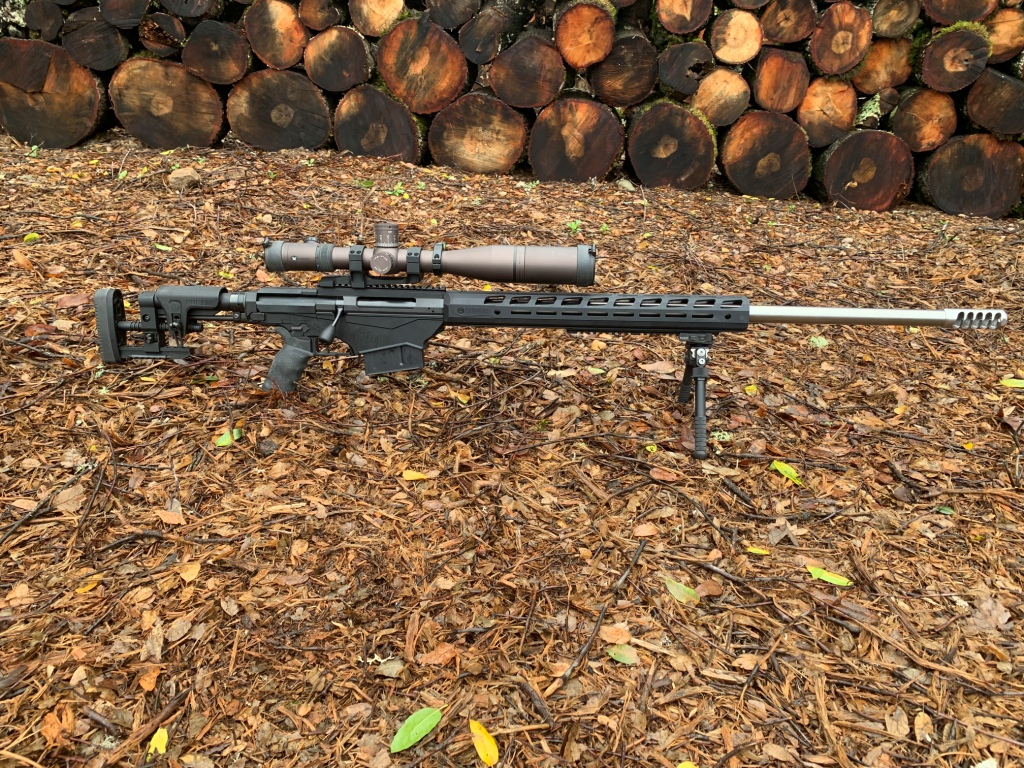

I bought a 338 RPR last year and rebarreled it in 300 Norma. Great gun. It was $1530 delivered to my FFL.

Bought the 338, but never fired it. Rebarreled it to 300 Norma using a 1:8 32" Bartlein.
I've been doing this for years and am still constantly finding new things to test. This one now has a 7-35 ATACR and an F class style bipod. I have 3 other ELR guns built on Savage actions in XLR chassis. Mostly they're just mules to test cartridges, bullets, and twist rates. Between your tastes changing as you move up the learning curve and the rate the industry is advancing, if you take a year to build a gun, you'll wish you started in another direction before you're done. I put a lot of work into the Savage setups, the RPR is pretty much change the barrel and go. My dream gun is a Surgeon XL in an AI chassis. A buddy has one in the same caliber as this RPR and it doesn't extract as well as the RPR. Talk about a buzz kill.
How do you like that set up? Anything you would do differently?
I like it a lot, Josh at PVA did it for me and it was worth the wait. I’ve only had it to 300y so far and it’ll keep 5 rounds inside 3” without issue. Being my first magnum I’m learning a lot coming from 308/6.5CM’s.
As far as doing things differently, no! I used a Bergara HMR action because I got it for a good price and I don’t like Remington and didn’t want to spring for a full custom action (but they’re a great option).

Just reading this thread so I'm late to the game. Here are my thoughts:
- I thought I knew a decent amount about rifle components until I had my first rifle custom built, and kitted all the parts myself. You will learn A LOT by putting together your own build.
- When I've bought houses during my lifetime, I felt most at home with those that I did renovations on. Similar thing with rifles. When I buy X-brand rifle, it is an X-brand rifle. When I build a rifle, it is mine all the way around. This may just be one of my idiosyncrasies, but I don't think I'm alone in this.
I think the choices you narrowed down to were 338LM, 300 PRC and 300 WM. My opinions on the three.
338 Pros:
- Big, heavy bullets
- Big thumper that will reach way out and touch something (not in a nice way).
- Lapua brass (obviously)
- Big, heavy bullets (worth saying twice)
338 Cons:
- Pretty expensive to shoot (in all components: brass, powder, bullets - really expensive if you're buying ammo)
- Good for a mile, but a little overkill. Either of the 300s will do that.
- Big everything else, so big bolt face too.
300 PRC Pros:
- Magnum bolt face
- I'm going to go out on a limb and say you have the most bullet choices with all those 308s out there.
- Fun rifle to shoot at a mile.
- Very efficient cartridge
300 PRC Cons:
- Only ammo available right now is Hornady
- Only factory brass available is Hornady (but I use fire-formed and prepped 8x68S and it works well, and ADG is planning a 2020 product launch for it)
300 WM Pros:
- Lots of good ammo and brass available.
- Similar to 300 PRC otherwise
300 WM Cons:
- Except for brass/ammo availability, the 300 PRC is superior in pretty much all respects.
- It is a belted magnum.
In the spirit of full disclosure, I am fairly vocal about my fondness for my 300 PRC. My current one is a Franken-rifle, but I like the cartridge so much (and am sufficiently invested in it) that I'm doing a custom build as soon as my Manners stock is done.
