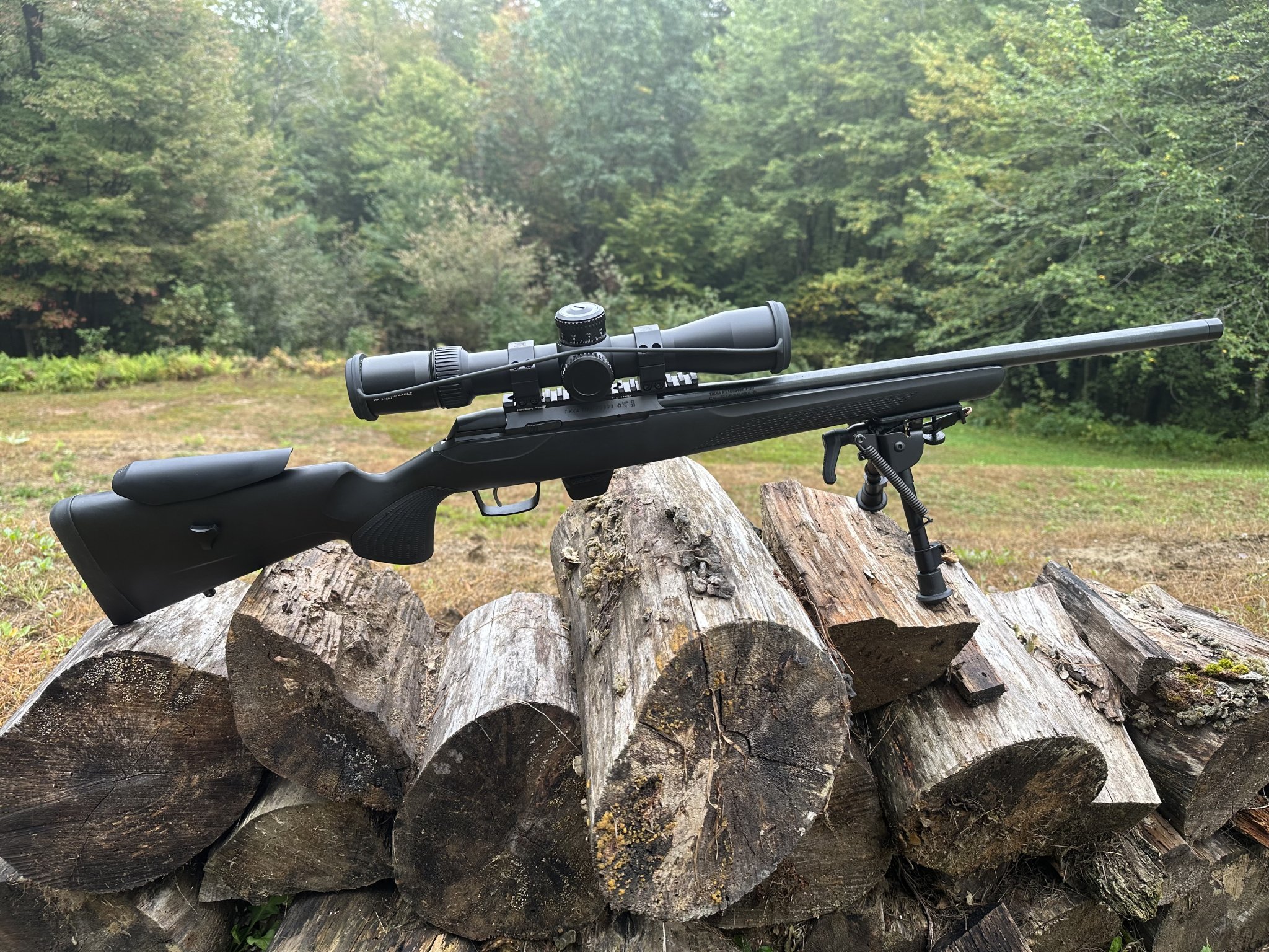

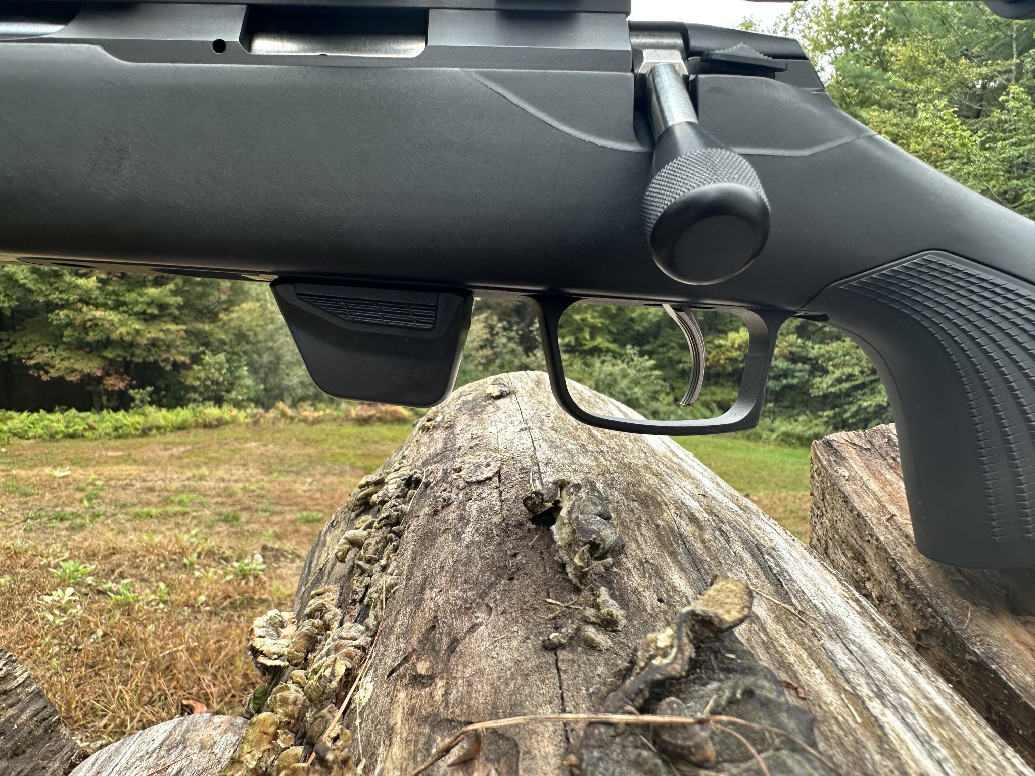

Building a T1X now that I could finally secure one in left hand. Going to be some intermittent "growing" phases as I wait on the Grayboe Phoenix 2.0. Not a lot out there for us lefties (as always). Nothing super special but always love the .22's
Rifle: Tikka T1X 20” MTR
Scope: Vortex Strike Eagle 3-18x44 mm FFP EBR-7C MRAD
Scope Rings: Vortex Precision Matched Rings
Scope Rail: Area 419 Rail 15 MOA
Cheek Riser: Kalix Teknik CR1
Misc Upgrades:
Recoil Pad: T3X Recoil Pad
Grip: Tikka T3X Vertical “Grippy” Vertical Grip
Bottom Metal: Mountain Tactical
Bottom Metal Screws: DIP
Bolt Knob: DIP Executive
Misc Accessories / On Order:
Magazine: x4 (Total of 5 including 1 that comes with the rifle)
Bore Guide: Boretech
Upgraded Stock: Grayboe Phoenix 2.0 in Woodland Dip Camo
UPDATE 9/30/23:
So I'm waiting on the Grayboe Phoenix 2.0 (should be about another 5 - 6 weeks) and the Mountain Tactical Arca Rail.
Got the stock back from High Desert Rifle Works with the Kalix Teknik cheek riser installed. Have done / added just about everything else I originally planned on.
On the fence if I'll keep or sell the OEM stock with the upgrades when the Grayboe comes in. It's light and handy but I'll probably spring for a RimX next versus another T1X.

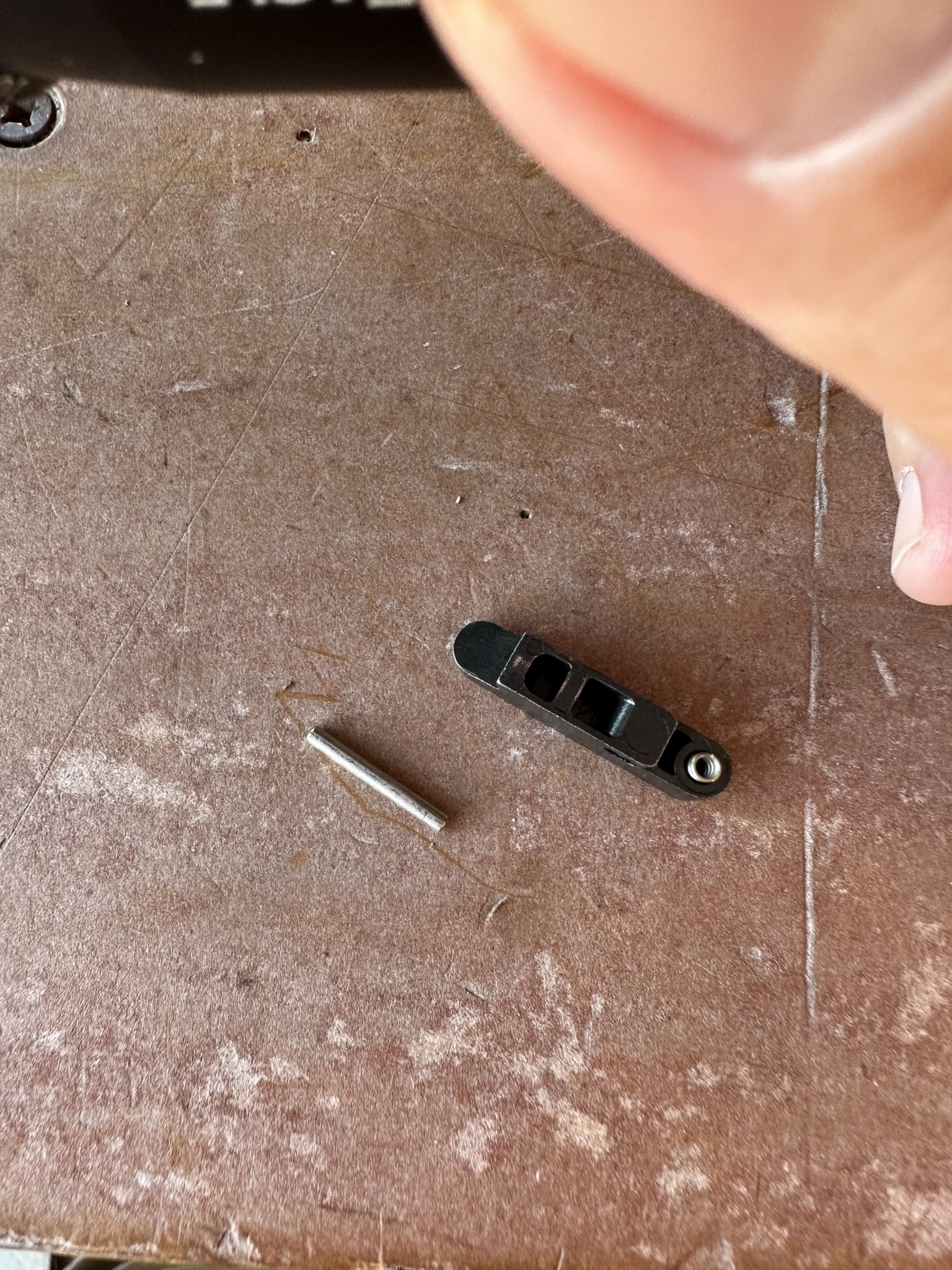

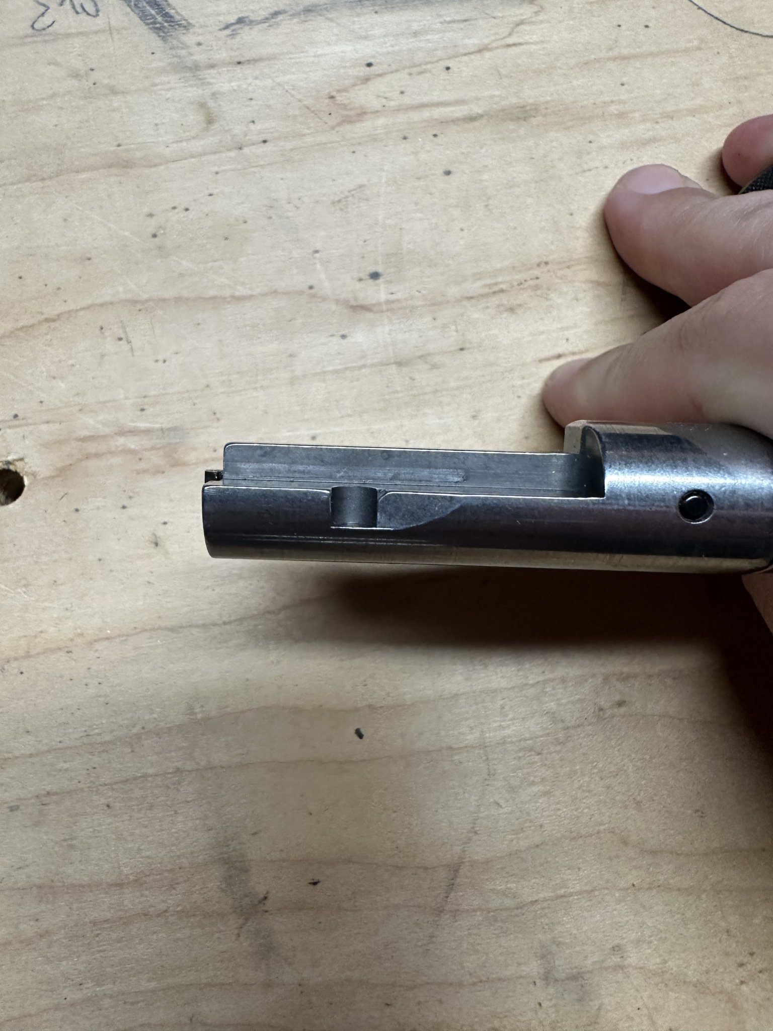

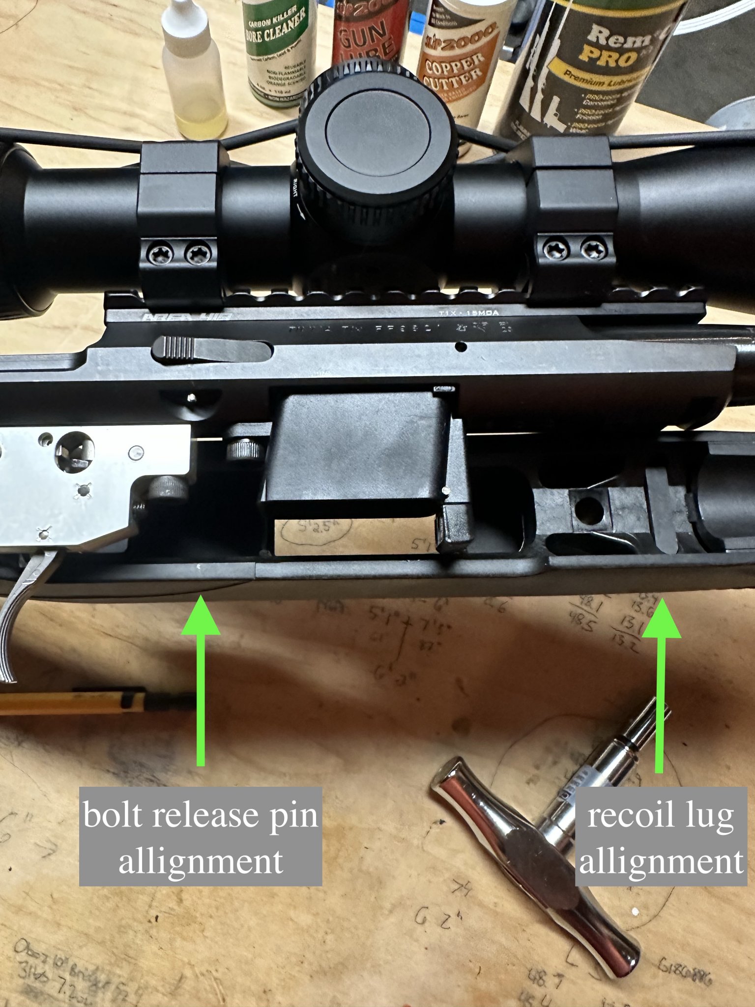

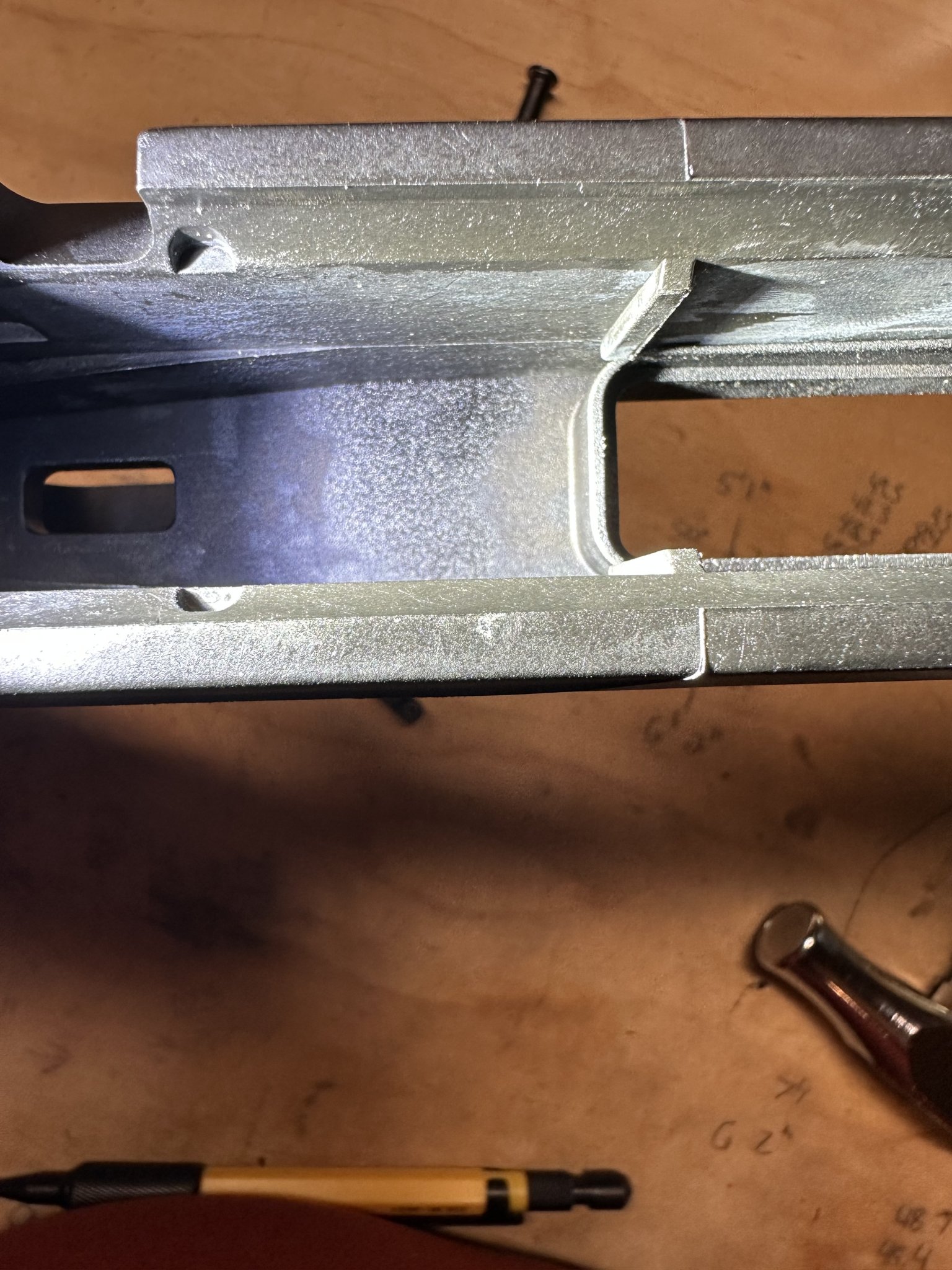

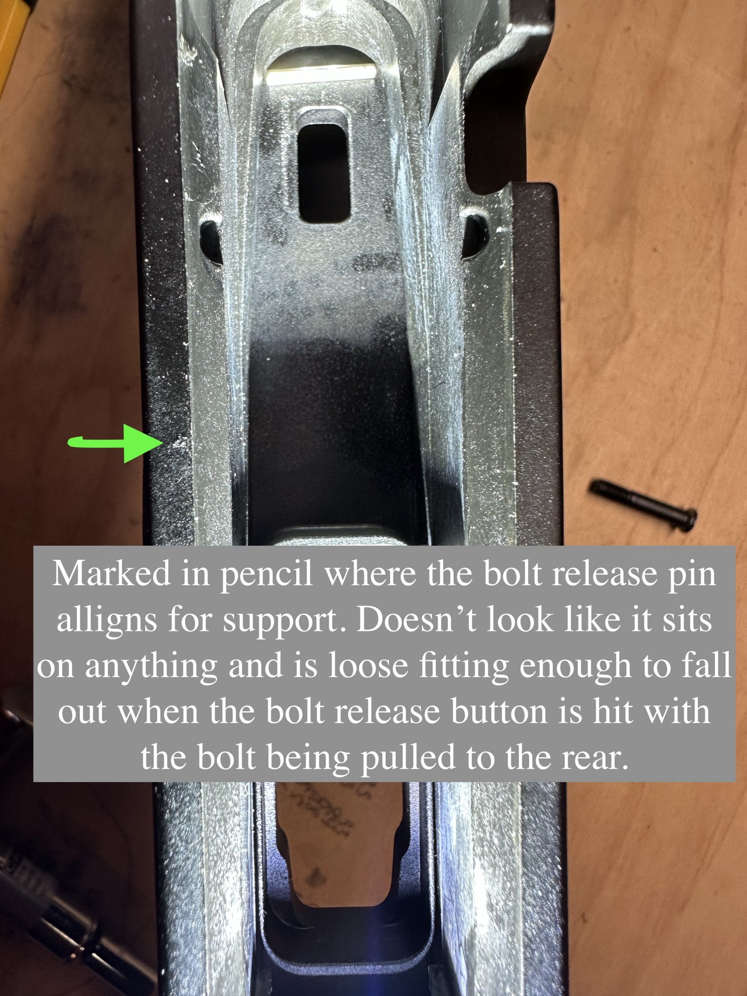

Now for the ugly... While cycling the bolt it came completely out. Initially I thought I had just cycled it too hard and then I saw the bolt release on the shooting table along with the spring. The pin that holds it in place is supposed to be supported by a shelf on the stock. Perhaps mine was shorter or there was too much "forgiveness" built in to the actual bolt release. I separated the barreled action from the stock and there it was.
I reinstalled the pin and torqued to the 44 inch pounds that tikka recommends. I know this seems high and I initially only did 25 inch pounds but thought maybe that contributed to the pin falling out.
I had it happen 4 more times. The pin is loose and doesn't have sufficient spring tension to keep it from falling out when pushing in the bolt release and not supported by the stock. When reinstalled the stock "should" keep it from falling out but doesn't.
I contacted Beretta Customer Service and was told there is '1' bolt release assembly group "in stock" and I should have it in 5 - 7 business days. I asked what would happen in the event the inventory wasn't correct and I was told "it will sit on backorder until one is received".
Fingers crossed at this point... anyone else have this issue?

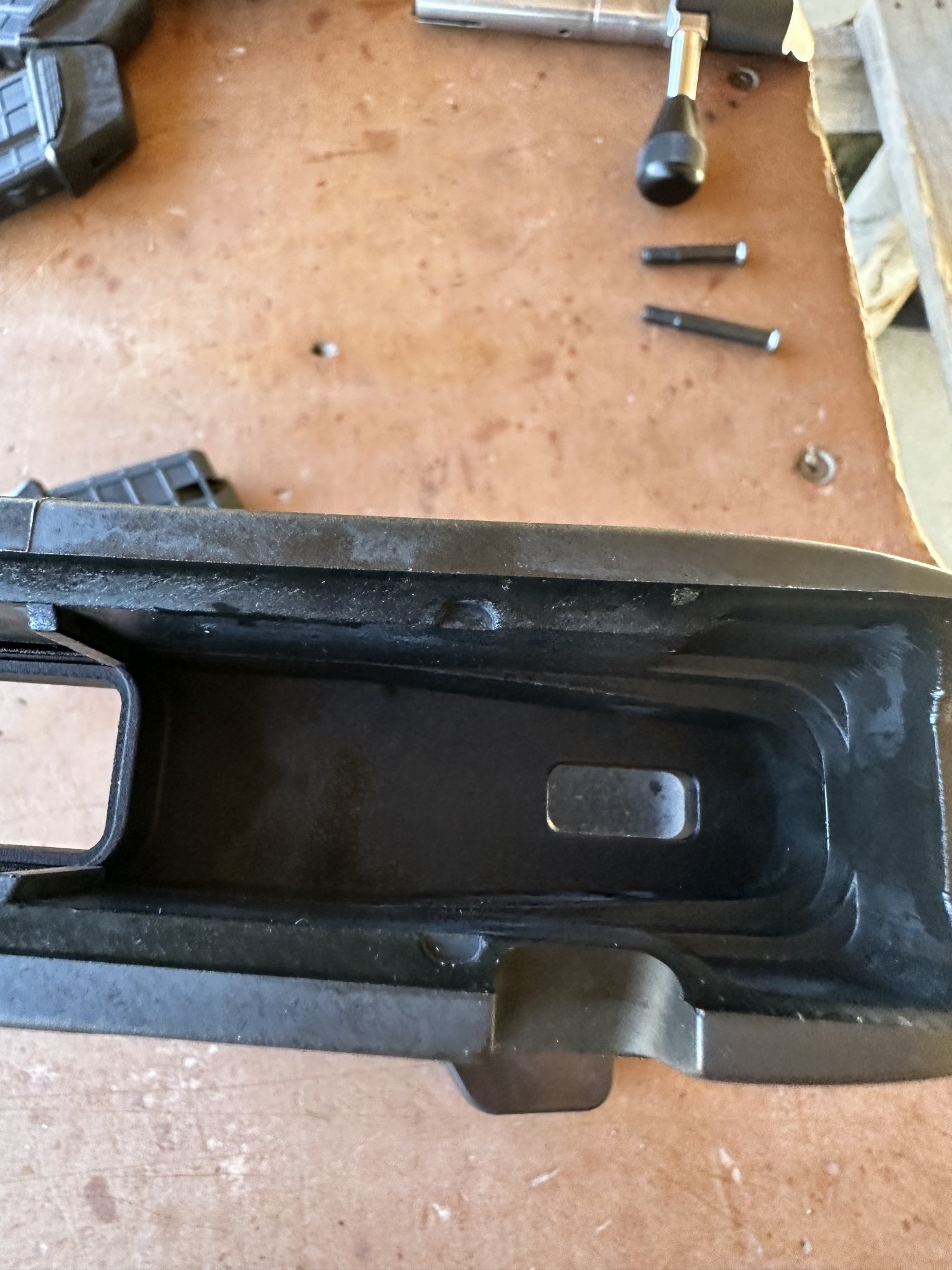

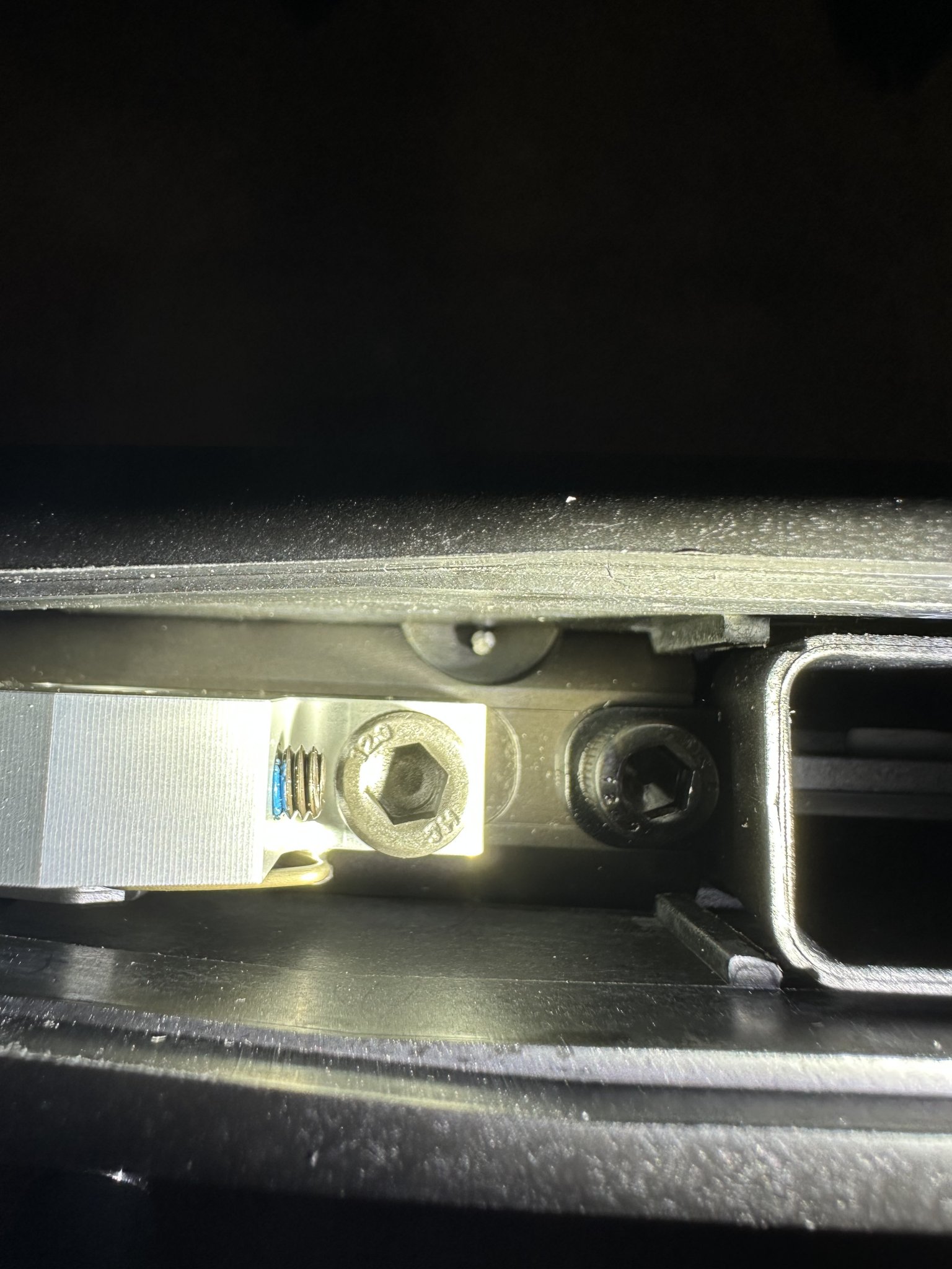

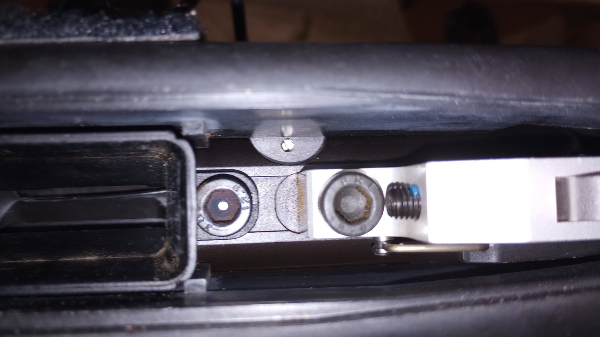

So, out of curiosity I pulled the trigger guard off my right hander. If the stock supports that pin it is just BARELY on the edge of it.
From your pic with the green arrow the pin would be 99.9% or more inside the inlet. It honestly looks like it depends on friction not the stock to retain it. I can't move the pin by hand on mine.
Given it is a blind hole I'd only glue the exposed end if you go that way as a fix.

When I've had the pin removed there is an indexing recess for the pin in the receiver. I'm hesitant to glue it.
Are you saying without friction from the pin itself yours doesn't have support from the stock either and would fall out?

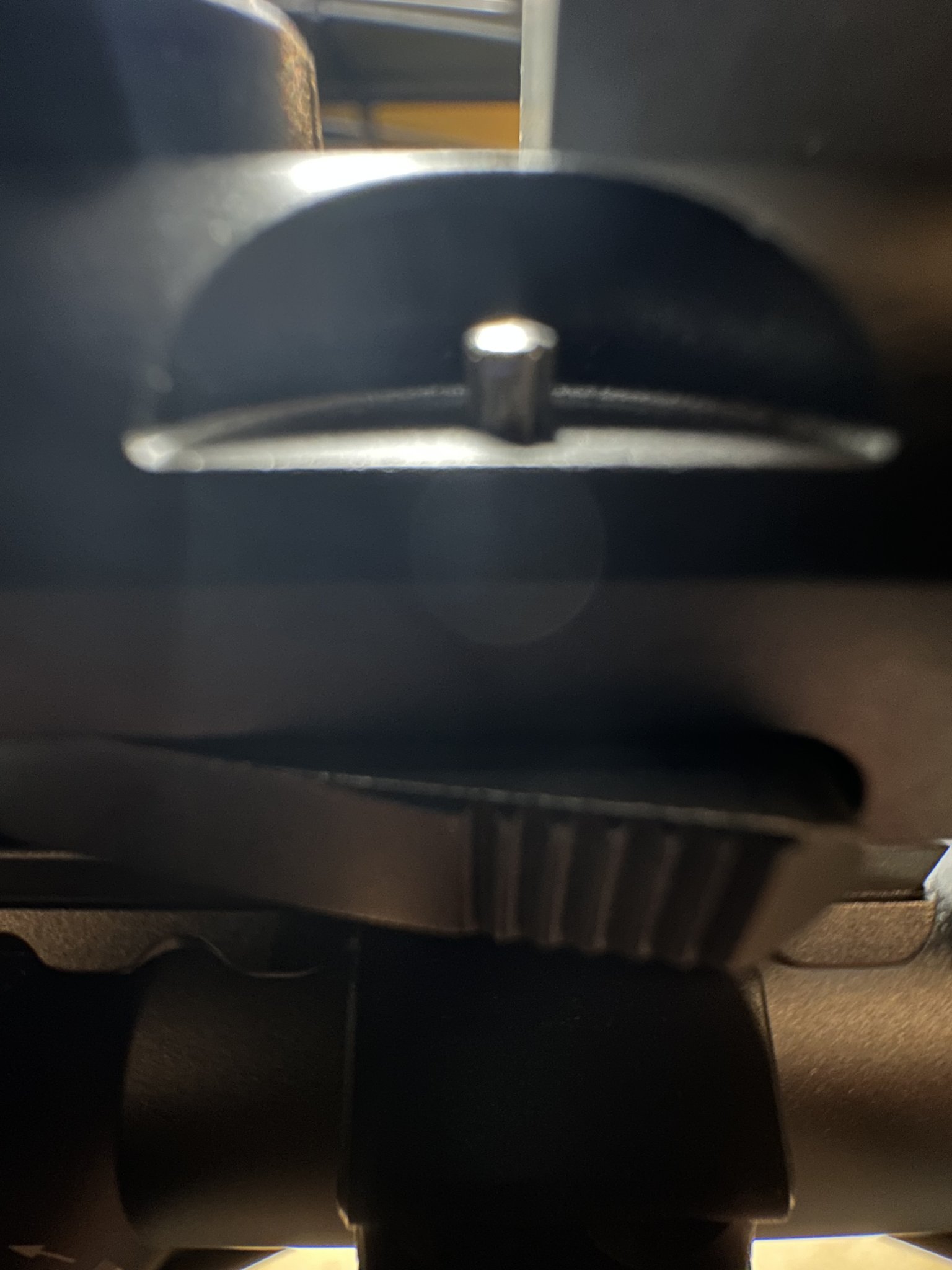

Took a pic of it seated in the stock with trigger guard off:
Reactions: USMC22

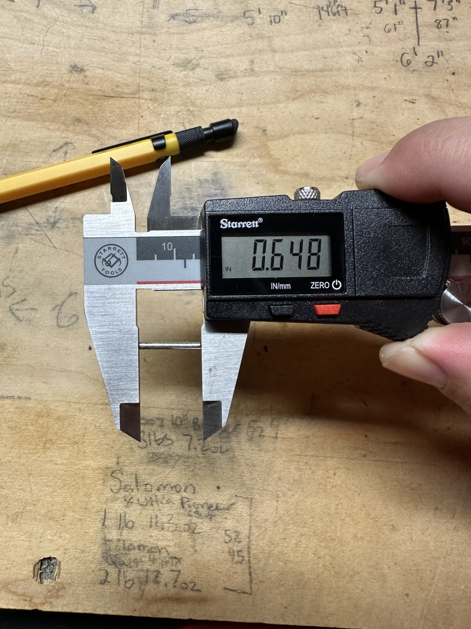

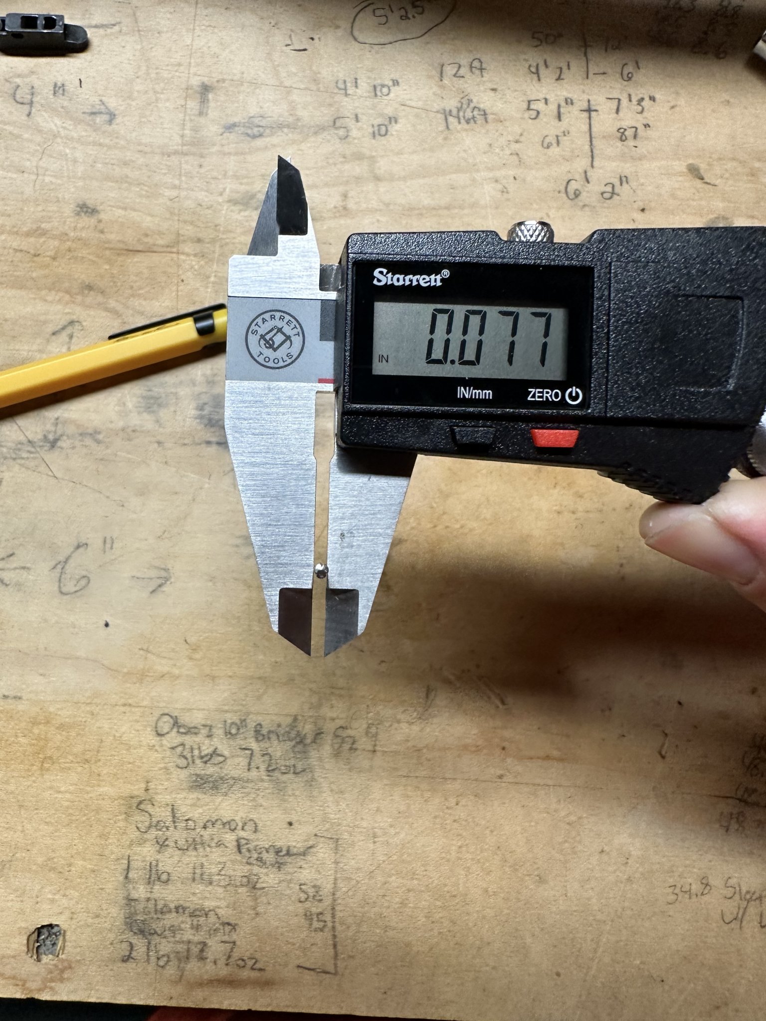

Thank you very much. At this point I'd say it is supposed to be a friction fit pin and that mine is just out of spec / smaller and not held in tight enough. Looks like I need a new pin that will need to be assisted with a punch to seat properly.
Could also look at getting a 5/64" pin that is the correct length. McMaster Carr can be your friend. Available in 4140, 18-8, 316, and 416.

Part came, still slips out with gravity. . . restored rifle to factory configuration and place all accessories in the rimfire classifieds. I'm done. Waiting to hear back from EuroOptic on options as they're reaching out to Beretta. If you're in the market for a Vortex Strike Eagle, a sweet kit for your T1X... our classifieds may be the place to look

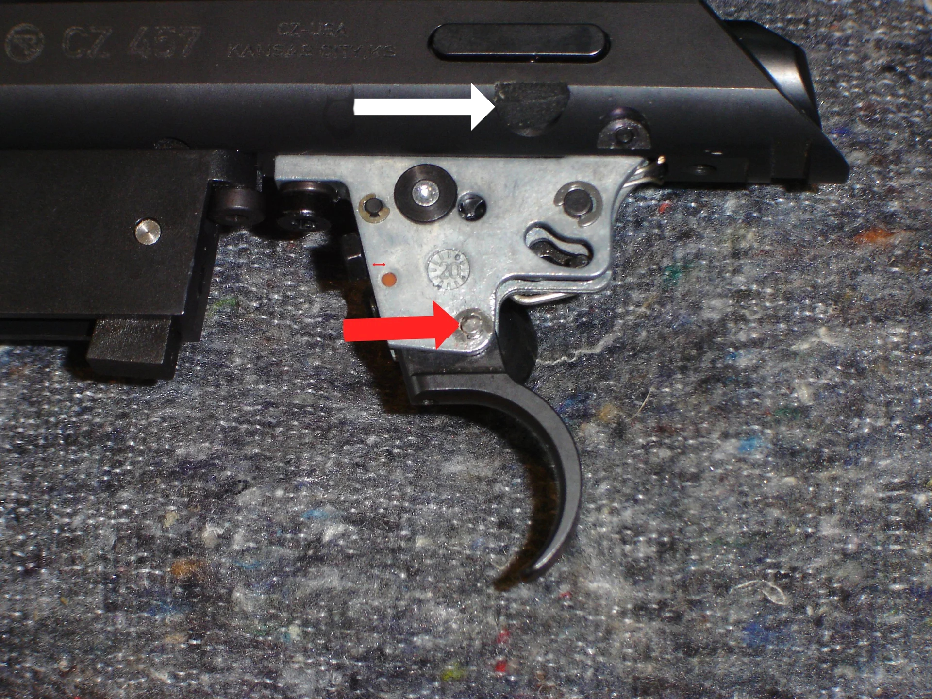

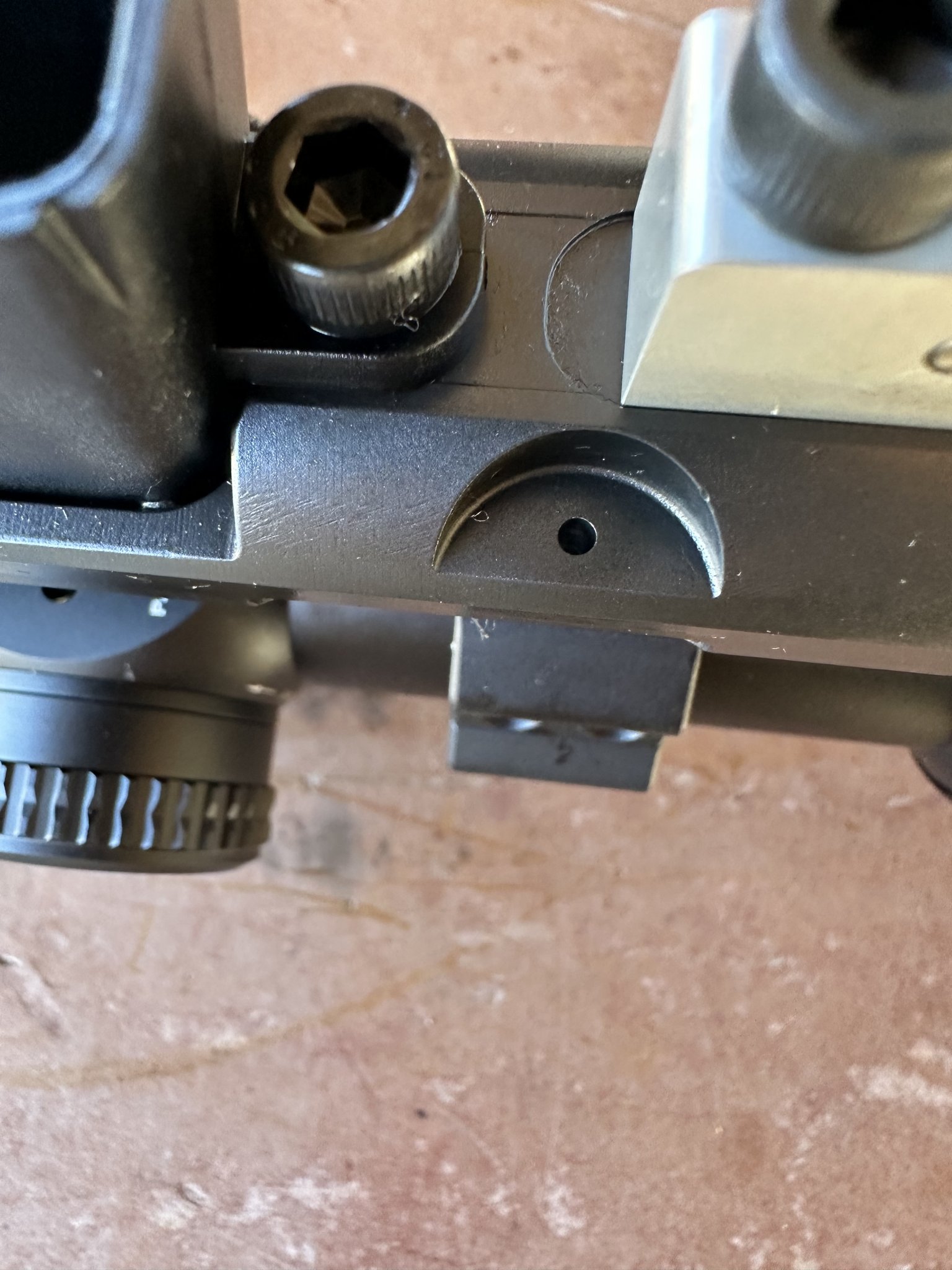

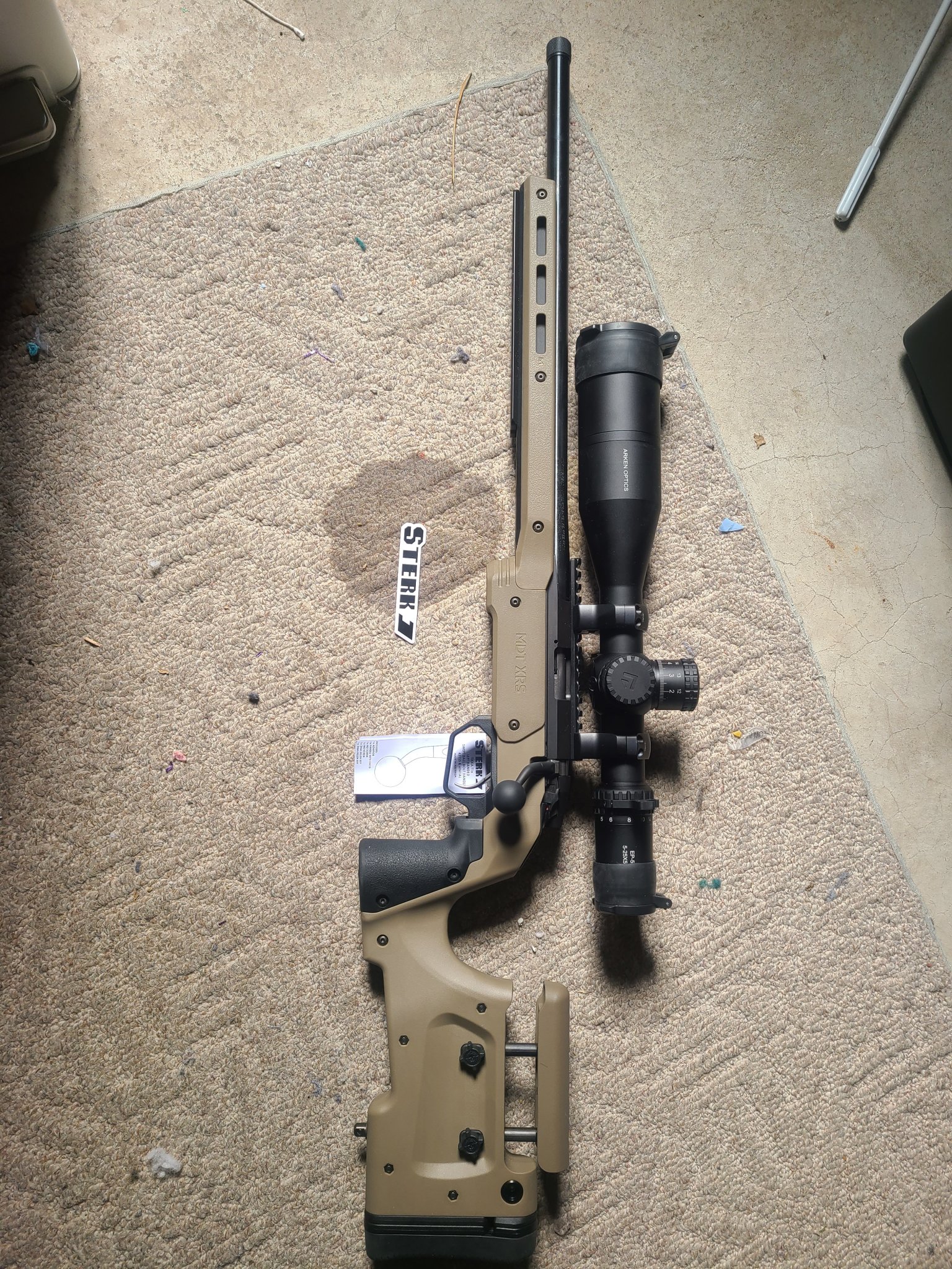

Different rifle (CZ457 in an Oryx chassis), and my bolt stop pin fell out just after a match. Luckily I was at home walking in to put the rifle away when the pin dropped out. Bolt stop and spring went flying away in to dark carpet. Found the bits and put it together and wanted a way to stop this happening again (MDT know about the problem with there being no wee 'ledge' for the pin to sit down onto...but aren't going to address it).
Anyway...I used a wee bit of foam (ear plug) and glued it under the pin (into that cut away piece of the action).
Can be easily removed if needed.
Has been in there for near on 2 years now and no more problems.
Might help those of you with similar rifles/chassis?
The white arrow shows the foam piece. Ignore red arrow...it's just showing a new trigger pin.
