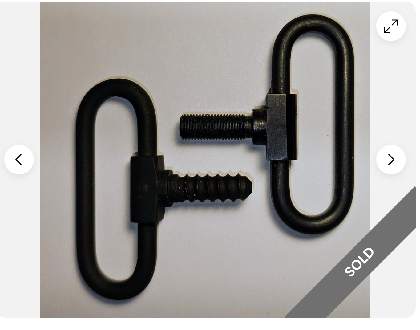

Tony,
Check around your shop for a set of swivels that look like these. This set is Wichita 1 1/4 inch M40 style, not original Remington. Maybe you shoved them away when you stripped the stock.
The Remington wood screw rear ones show up on eBay sometimes. The machine screw fronts are unicorn hen’s teeth. I’ve gotten a few rears buying parts lots on eBay. I’ll bet you could figure out how to machine thread, or add material to thread, to a rear swivel to create a front. That’s if you wanted to go for an original style look for that build.
Either way, stay the course. I get most of my M40xx info in this forum and my M14 knowledge at M14 Forum.
Greg
Reactions: TonyBen
The rear wood screw swivels are easy to find. They are all off of a Remingtom 513T stock. Numrich sells those wwii era 513 stocks with all the metal for around $40. You can take off the swivel and throw tree stock away or resell it on ebay. They were so selling just the rear swivel for $10 each but I haven't looked an a couple years tosee if you can still buy the rear swivel separately.
