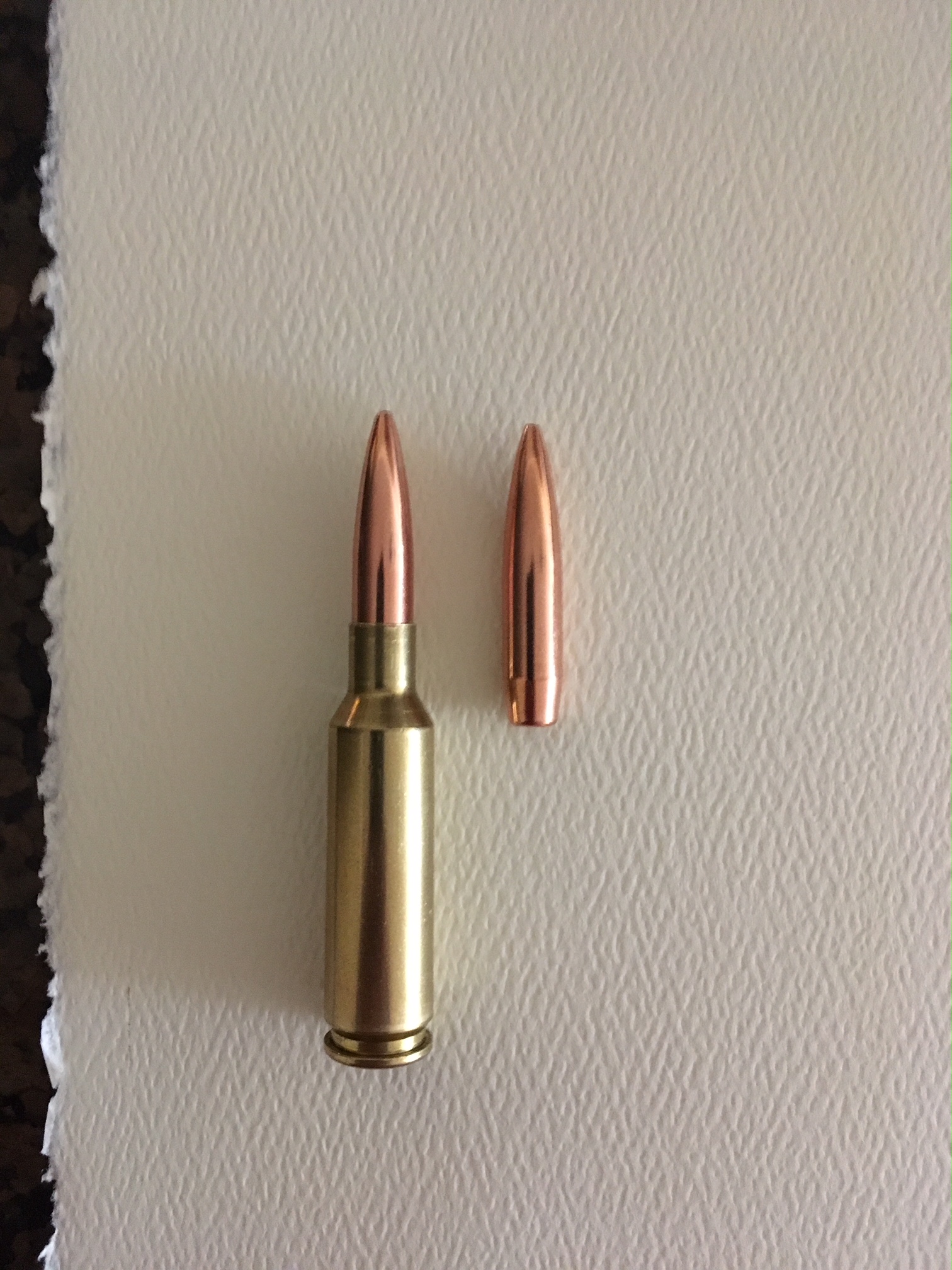

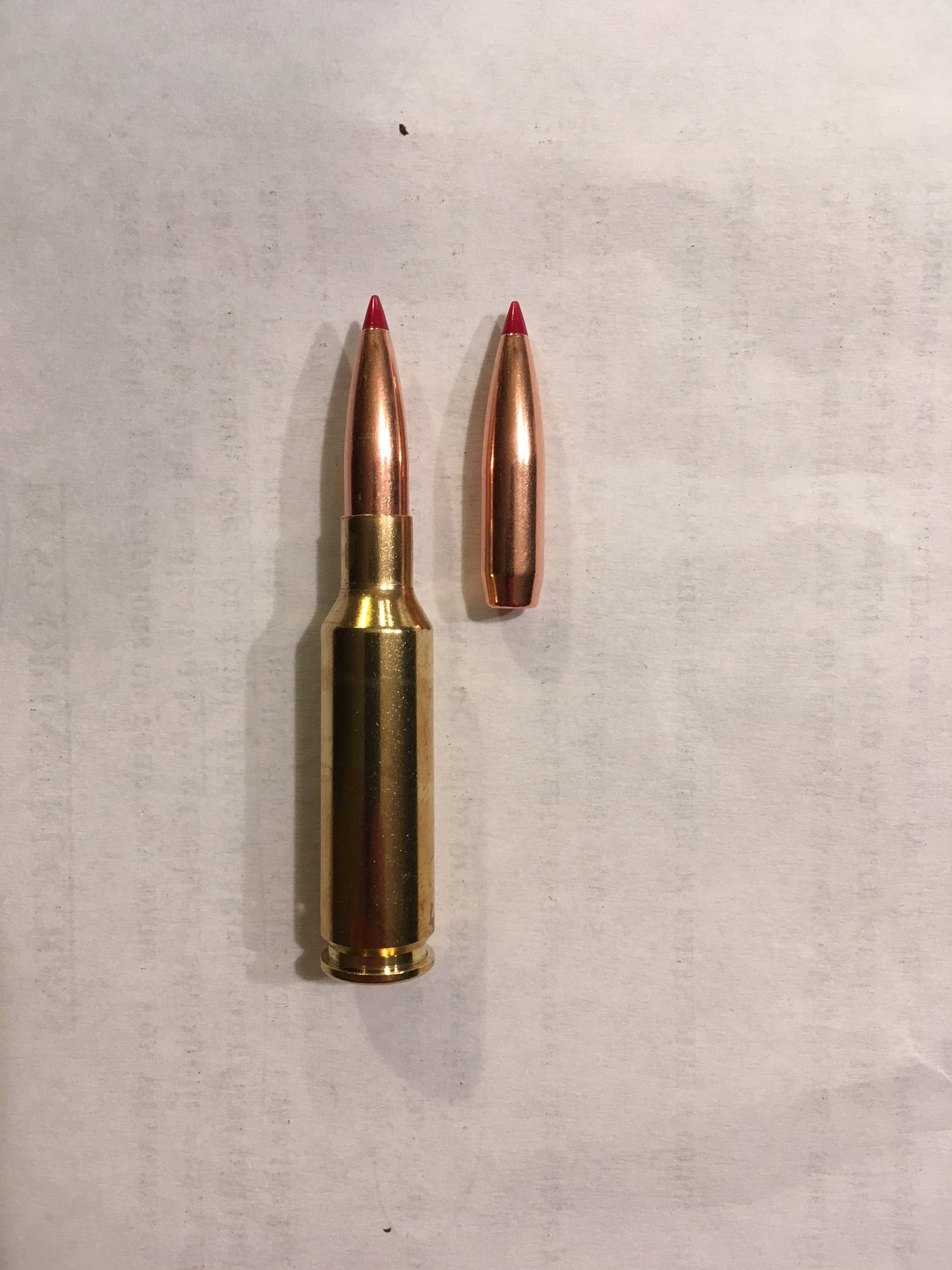

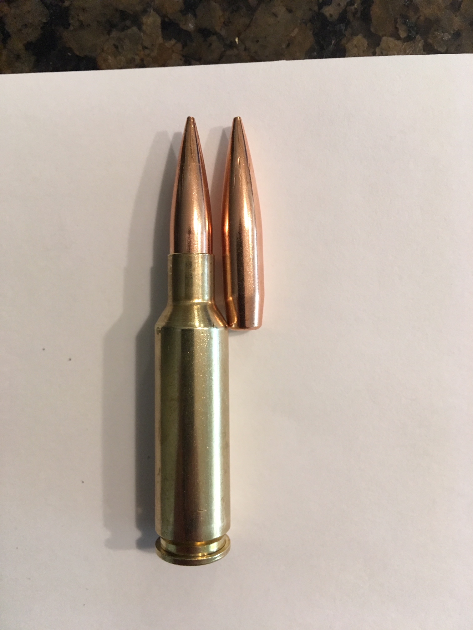

I will say i prefer the aesthetics of more FB over less. My short 6.5x47 is .155 while my comp gun is .123. Of course .123 is more conducive to chasing the lands but i hate how stubby my rounds look lol. I seat 10 thou off the lands and even with a short bullet like the hybrid I’m slighlty below the shoulder. Though again not compressing loads. Not with varget or 4166 anyway. Something like H4350 or RL16 you probably would be. The hybrid is a relatively short 130 so it works very well. With the 26” tube though you shouldn’t have to push hard to hit 2800-2900 like i am.
Here are some pictures of .010 off the lands with the 130gr hybrid with .123FB. Then the .123gr Scenar with .155FB and the 123gr ELD-M with .155Fb Of course it's hard to get the bullets exact when making a picture like this but it gives you some idea. The 130gr Hybrid pic kind of sucks should've had the bullet to the right of the case. As said though you can make a dummy round and have the lands exactly where you want it.
