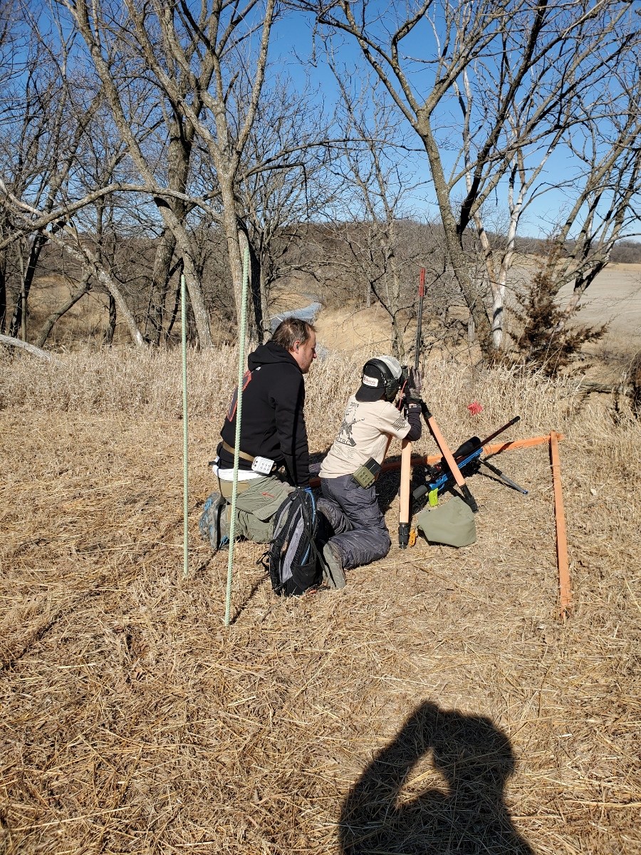

I’m midway through a similar project
I’m using my old krg X-ray. My 10yr old daughter can get behind it well, my 7yr old son not quite as well but manageable from fixed position
I tried to keep it medium weight, so my 10yr old can move it around, so I went medium Palma barrel at 26”. I plan for them to use my tbac dominus 30 cal can.
For a scope I am using a Burris xtriii 3-18. It’s pretty darn light compared to many prs optics and I got a really good deal
Action is an archimedes because of their Black Friday deal. It should provide nice bolt lift (my kids can make my M5 cerekoted mausingfield work)
I strongly considered an xlr element. You can get the short tube for a folder, and this allows LoP to drop to around 11”
Only reason I didn’t go that rout was wait times for the chassis

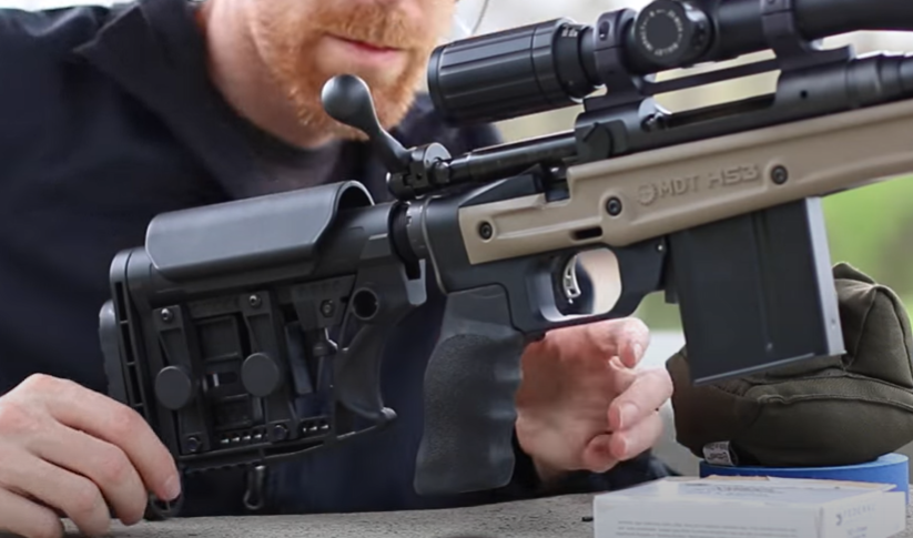

Was gifted a Luth AR MB-1 buttstock, but LOP was too long, so ordering the LUTH AR MBA 4 with adjustable cheek.
As LOP needs increase, will add the adjustable butt if needed.
Here is a pic of it on a different chassis ny MDT and a Savage, but you get the idea.
Luth AR’s site says you cant use the front two holes of the buffer with the cheek riser, but thats just for ARs with the charging handle.
This was from a vid I found on the youtube.

I put my 6.5x47 in an XLR magnesium stock. 9yrs old but nearly 10.
deal was you can shoot a match when you can carry the rifle the whole time. he did well. we were RO’ing so we shot 18 stages in one day. He did amazing.
Most important thing isnt weight as much as it is attitude and patients. you can always help carry stiff. as role model and instructor, you cant get mad or frustrated. that kills the fun instantly.
eta the xlr butt stock is the only and best one for adjustment for short LOP
