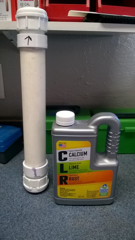

I built a container for my supressor using 1 1/2 inch PVC. My can (Mack Bros Varminter 2.0 in 30 cal) fits just inside. I can fill it up using a minimal amount of CLR.
I left in in there about 24 hours, dumped it out and flushed with hot water.

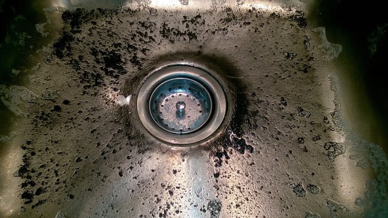

What I found worked best was to fill it up with hot water, shake it a bit and then dump it out as I smacked it against my palm. Lots of crap came out. See attached. That's probably less than half of it.
Since this was my first ever cleaning (after a few thousand rounds including H1000), I filled my "shake weight" back up with fresh CLR and am going to give it one more flush.
Warning: CLR is safe to use on Stainless and Titanium. Regular steel... not so much.
