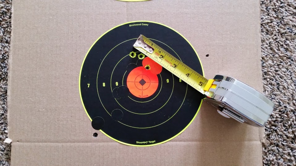

Last weekend I shot 1 3/4" group at 200yds/168gr SMK's/44.5gr VihtaVouri N550/Nosler brass. I know that's not much compared to what you guys are capable of, but I'm really enjoying the process.
