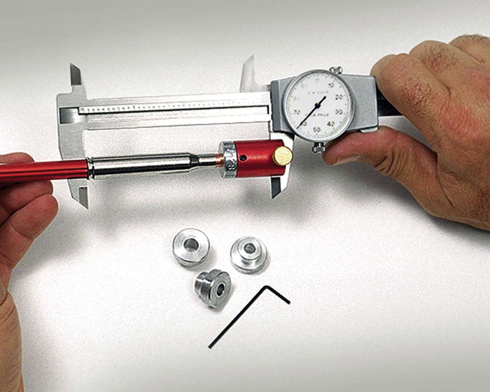

I’ll tell you this from my experience,
Don’t switch brands and expect the same level of precision without load development.
If you’re running say hornady 140 eldm and switch lots. It helps to measure the OAL with the new bullet in reference to the cartridge base to ogive. I’ve seen lots of hornady bullets be a decent amount off from their similar projectiles. But if you run the the same distance off the lands between lots they generally run good
Ex: if your current lot is shooting great .020” off the lands then measure and seat the new lot .020” off the lands for best results

Thats why we measure down low on the ogive, close to where the bearing surface of the bullet would actually be touching the barrel. Its much more consistent.

I have one of the Hornady Comparetors like you show, but other than my own measurements, I don’t see most reloading manuals listing this measurement.

A comparator does not measure anything. It compares one bullet to another or one loaded round to another. You cannot infer jump length from a comparator reading. You can take two bullets with identical BTO readings per your comparator and they will have completely different jump length numbers. Even from the same manufacturer but different lots. And then there are differences in comparators from one brand to the next. They all hit the ogjive in a different spot.
