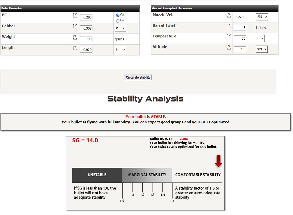

So I was over on Berger's site because I came across a barrel that piqued my interest. I'm looking at getting a 300 blackout barrel and came across a 1:5 twist barrel which is the tightest twist I've personally seen for a 300 blackout barrel. Well this immediately triggered my remembrance of the 8.6 blackout and it's tight twist = its devastating characteristics.
Well I went to Berger's site to see if it would stabilize the 110gr Varmageddons I plan to run for defensive handloads in front of probably Lil Gun. This is what it came out to...I don't understand why the SG is so high and is that high of a number good?

IIRC this factor of stability reductively means your twist is 'enough' for the bullet to fly straight and not tumble or wobble, etc, So in this cas you are more than enough twist. Next step is to maybe calculate the RPM & double check your speed x twist isn't going to tear apart the bullet (or jacket) apart in mid flight.

Nope, gyroscopic and dynamic stability does not measure anything to do with the bullets construction and ability to hold itself together.
Its how well the distributed mass in that spinning bullets wobble as it moves along its flight path keeps the bullet falling into its own path self correcting itself in flight and staying along a straight line. If the bullet doesnt have enough twist itll do poorly as the center of gravity overtakes the center of pressure and falls end over end as the bullet tumbles.
