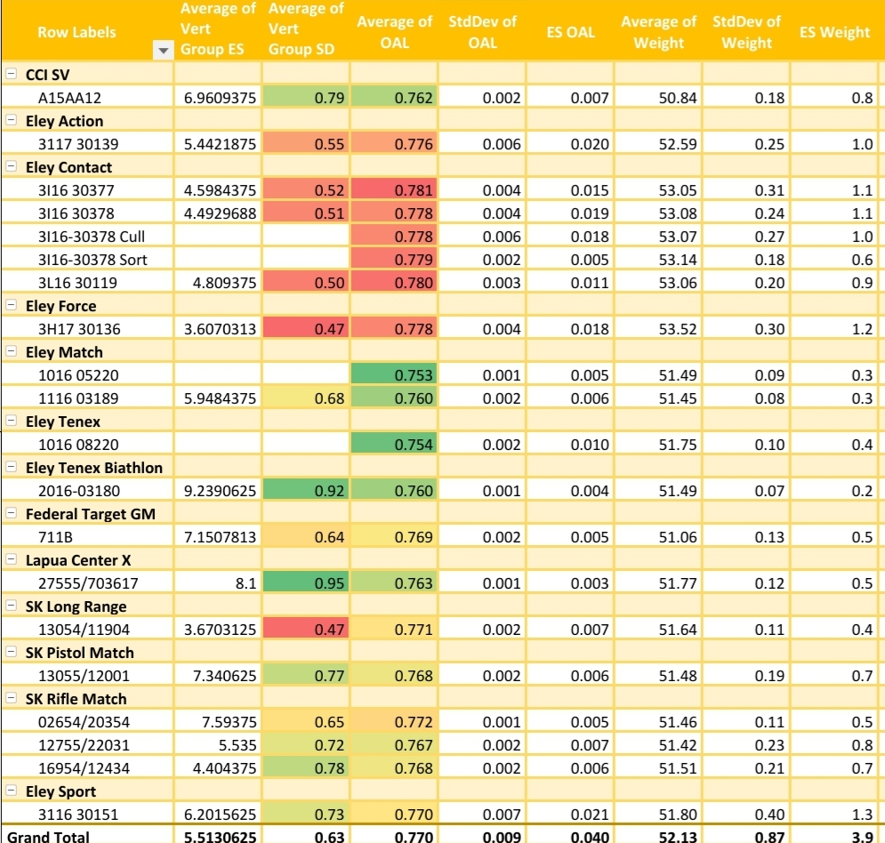

I have disassembled enough to know what your saying is true. 😉
My initial tests were done with cheap fed target ammo sorting within a 0.001 or 1.0 gr i didn't see a difference. But the anomalies being eliminated helped ES in velocity. At that time I was only testing at 50 and of course no accuracy difference. As I have learned more I now realize unless your doing 50yd bench 50 testing means very little more then getting a good Zero.
I agree visual inspection will tell you if the ammo will shoot or not all else being equal. Eley really has to improve the Tenex and Match every lot I have the nose is scuffed on one side. Not that I can prove it makes a difference lol.
I test with SK pistol match and better ammo so everything measures very consistent anyway.
To further prove your point. Eley Force and Contact shoot the best in my rifle at 200.
I have three lot# of contact they all shoot the same.
BTO length ES 0.019" weight ES 1.1gr
Eley Action is second
BTO length ES 0.020" weight ES 1.0 gr.
All of these average 0.776-0.780 BTO length
The next here dont shoot. 150% larger group SD
Eley Match
BTO length ES 0.008" weight ES 0.3 gr.
Eley Tenex Biathlon
BTO length ES 0.004" weight ES 0.2 gr.
Lapua Center X
BTO length ES 0.003" weight ES 0.5 gr.
All of these average 0.760-0.763 BTO length.
Eley Match
Eley Tenex Biathlon
Lapua Center X

Great results but can't see how this data can be used without knowing what hardware and cleaning procedures were used.
Are you shooting a production class $200 Mark II Savage , a $400 RPR or are you using a $2K + custom rig with a match grade 20 in barrel, 10 oz trigger in a Custom chassis with a NF 40X scope.
How many rounds do you shoot before cleaning the chamber? Maintaining a clean barrel is critical to accuracy, in as little as 200 rounds the accuracy can fall off with any accumulation of carbon at the chamber leade.
The sorting data is outstanding and useful but is only part of the system, the environmental conditions and the hardware used need to be known to get the entire picture of bullet on bullet accuracy. You must be an engineer to compile the data into excel. Keep up the good work.
I have stock cheap rifles and custom actions. This holds true for all.
I dont clean barrels. I want minimum 1000 rounds through a barrel to settle them down. Velocity is morestable then for long range stuff also more consistent across conditions.
Different barrels could be different. I run IBI.
OK, I tried, and I call it HIT AND MISS. Went through 600 rounds sorting CCI SV. GOT 100 each of size xxx. Went out and took the KYL target for fun. Bergara B14-R Carbon in hand. Shot some old Winchester HP I had(went everywhere), shot CCI Green Tag that I have had for 15 years, or more. Crap, no more accurate than CCI SV. Shot Aguila Rifle Match, shoots like CCI SV, toss up.
The sorted CCI SV shot a 3/8" group at 50 yards, I got happy. Nothing even close after that, I gave up. I still have a second box of sorted CCI XXZ that I did not shoot from. Will go out again and report back on the XXZ, Eley Trainer, Fed GMM(bought years ago for $7.95), Norma Match 22, SK Standard, PM, and PMS.
I have gotten the same results with CCI SV with a little sorting. Glad to see that others are having the same luck. I also found that if you get the used boxes of Center X and Eley Match out the range trash can and use them to hold your sorted CCI SV you will see that your 50 yds 3 rd groups are in the .20 to .30 inch range. After several hole on hole shots the guys shooting next to you will ask where did you get the bricks of Lapua & Eley and then takes picture of the lot numbers. I think it has something to do with an ACE and LRA MV3 green dot with the flaming red marking tape hanging off the target. I might be wrong but seeing the wind works for me. Send It on the green dot is the key to success and makes the NF shine.
