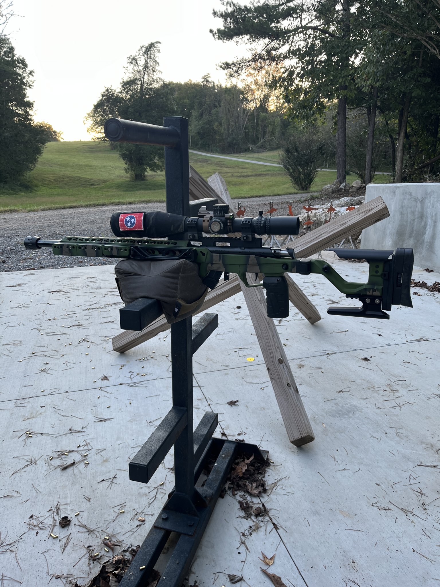

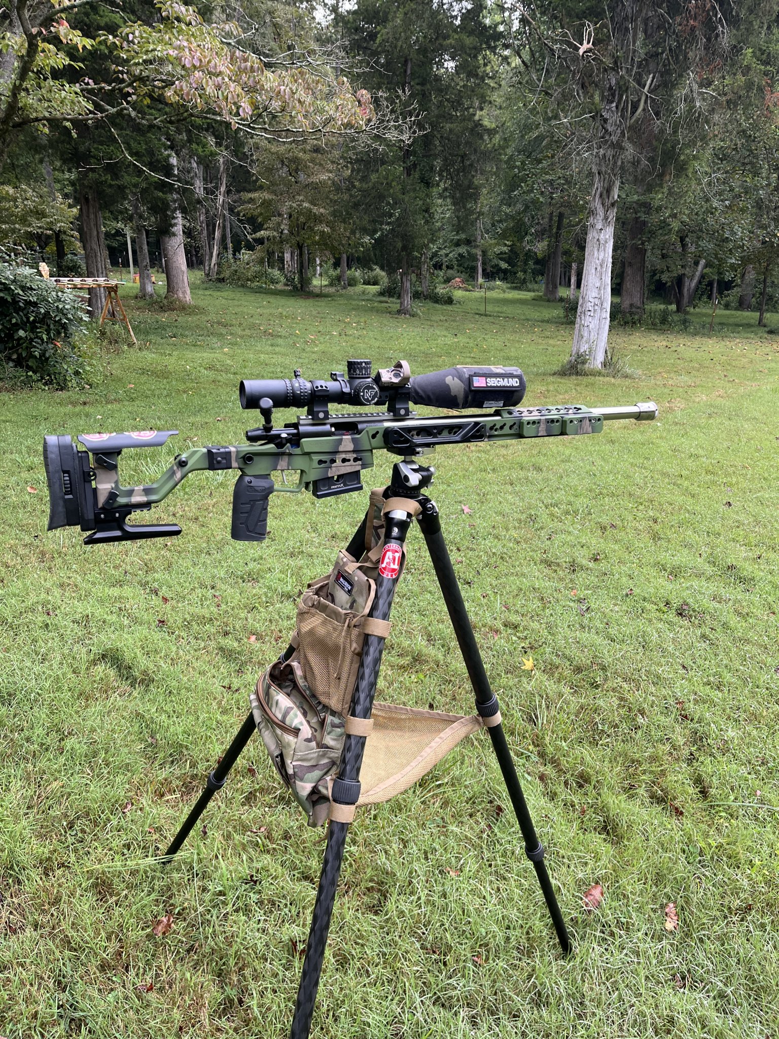

How’s the balance point? Do you have to run a ton of weights or do you have a custom heavy barrel on it?
Top to bottom, Anschutz AT-X, factory barrel .900"
RimX AT-X, Bartlien #14
My brothers Anschutz AT-X custom barrel, 25" 1.15 cylinder.
All three weigh 20 lbs

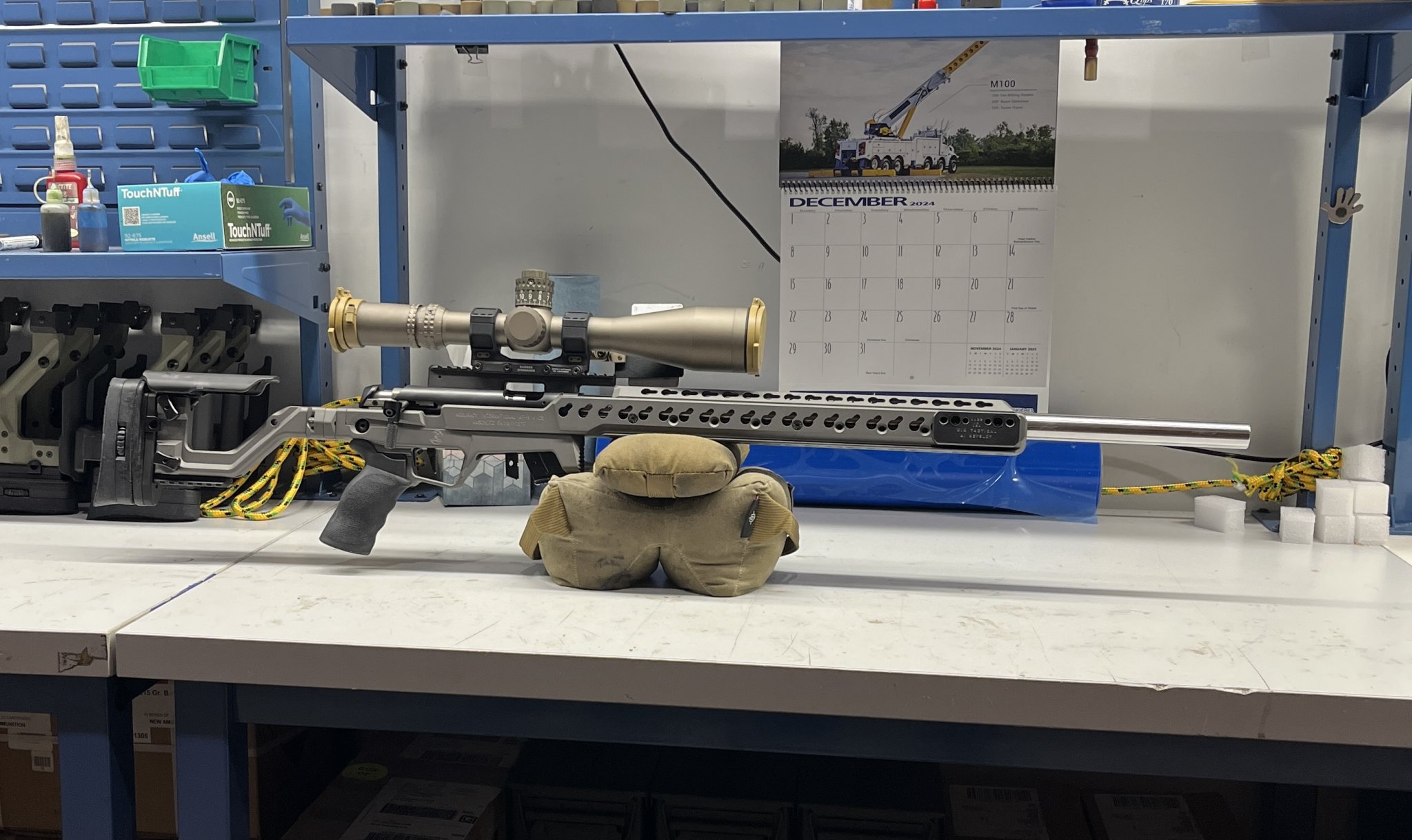

I was really into the precision rimfire game my whole life but the last 3 ish years my life has gone a little sideways (all in good ways) & left little to no time for this lifelong passion. But I am back! I want to build something new and get back into the mix.
I am curious who are the major players in the “custom” or high end precision rimfire game these days. I know of the tried and true such as Anschutz, Feinwerkbau, Walther, etc for single shot Olympic style guns, but how about the R700 footprint based stuff? It looks like there have been some big changes at VGW since Mike Bush left, are they only currently offering the 360? It looks like the RimX is still going strong. It seems the Ultimatum Duce kinda dropped out of the mainstream. I either forgot what happened or am not aware, did they ever really get that off the ground?
I will be keeping and eye on what comes out at Shot this year. Is there anyone else that has come to market with anything cool? I see Tikka is still doing the T1X and Bergara is holding their own as I am sure CZ is. Who else?
How about the top shelf custom rimfire gunsmiths out there? My go to was always Mark Penrod and I probably will still use him, but who has really made a name for themselves the last few years, especially in the repeater game?
