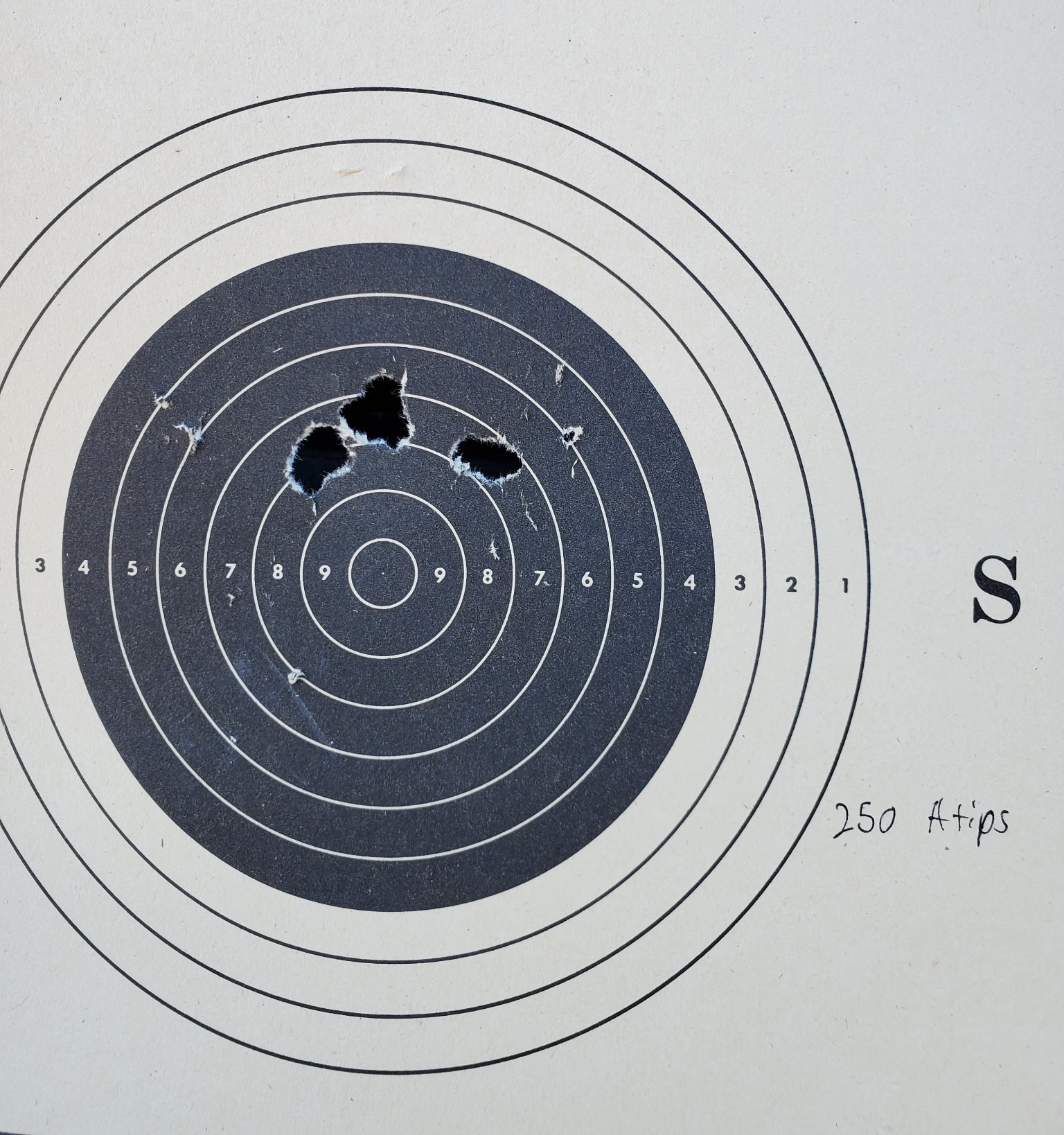

Hi,
After solving my "super weird issues" which were due to bad primers, I have a new problem with my .300 Norma Mag reloads... my groups are very bad (between 1.7 and 2.7 MOA at 109 yards/100m) and it seems that literally all bullets land sideways on the paper target:
Here's my reloading recipe:
  • Neck-turned Lapua Brass, trim to length 2.482in, neck OD 0.3355in for a loaded round at OD 0.3375in
  • Hornady A-Tip 250 grs, tried bullet jumps from 0.020in to 0.065in
  • RWS LRM primers
  • Vihtavuori N570 powder (77.9 grains) -- it seems low compared to some guys here on the forum but I'm already above Vihtavuori official max which is at 76.1 grains
I shot twice 15 bullets (plus like 3-5 fouler shots at the beginning):
  • String one (15 shots):
    • Average: 2703 fps
    • Std dev: 9.8 fps
    • Extreme Spread: 34.8 fps
  • String two (15 shots):
    • Average: 2703 fps (same as string one)
    • Std dev: 8.2 fps
    • Extreme Spread: 30.2 fps

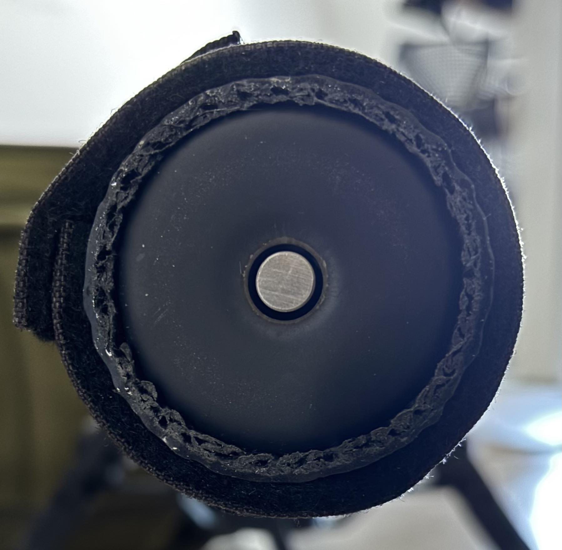

I'm shooting with a silencer, but concentricity looks good:
And my barrel is a 26" 1:10 twist.
While my velocities aren't the best, they aren't terrible either, they're pretty stable... I really don't understand what's causing this.

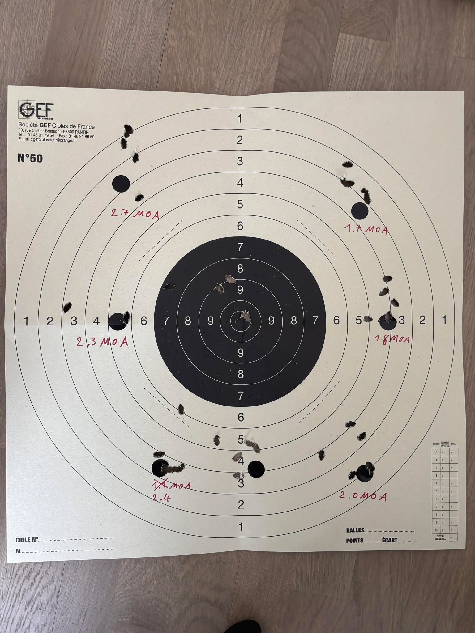

I tried factory 230 grainers from Norma ("match grade" ammo) and it gave better groups (all holes touching at 109 yards), although I couldn't go to the target to check how they landed.
In your experience, what could cause this?
Wow ... something is very wrong here. Step-1 for me would be to shoot some match-grade factory ammo and see if it's still key-holing the target. That would at least rule in or out something in your reloading components or processes.

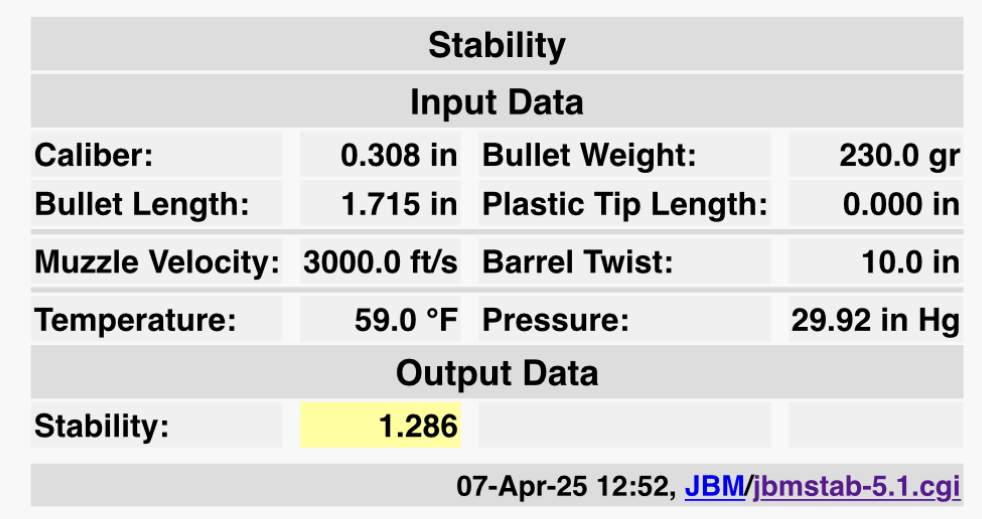

I just noticed Hornady recommends a minimum twist of 1:8.5" for their 250 grains A-Tip... my barrel is a 1:10". Isn't that the issue :confused:?
My guess would be "No". If a 1-10 is tumbling at 100 yards, then a 1-8.5 will be tumbling at 100 yards. I think you've got something physically wrong with the rifle (canted chamber, defective crown, etc.).
Yes the twist is incorrect. Most guys are running at least 1:9 and often 1:8 twist. Depending on your density altitude and with enough velocity you might get away with it at high altitude but I assume you are near sea level. It sounds like the 230 grain bullet is as heavy as you are able to stabilize.
Thank you everyone for your inputs! I tried hard to find a bullet which:
  • Gives a stability factor of > 1.5 in my configuration
  • Is >= 230 grains to keep the advantages of these heavy bullets with high BC
  • Is available in France (hardest part)

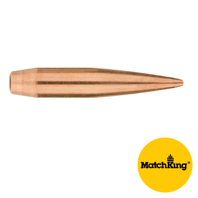

These criteria narrow it down to a single bullet: the Sierra MatchKing #2251.
I ordered some, I'll post an update next week when I try it. If it doesn't work, I'll have to go to 220 grains bullets but the choice is extremely limited (almost non-existent actually) where I live, so... not ideal. Then that would be 185 grains next... but that's not at all what I originally wanted for this rifle.

But that bullet needs a 1-8” barrel
Yes, but all the stability calculators I tried give a result saying it should be fine (stable) given the muzzle velocity I'll have. Maybe Sierra mentions the 1:8 twist rate for other calibers with lower muzzle velocities which would not be enough to stabilize the bullet.
I just hope it will work, if not, I'll go for 220s if I can find some.

Marginal even at 3k, may fly true but bleed bc over distance

NO it won't be fine !. Minimum recommended twist rate 1:8.75 ,You're on the low end of marginal at best . :(
Well... anyway, I received the box by mail just now and QuickLOAD and all the french websites screwed me: the bullet is 1.735in on average (not 1.620in), so all hope is lost on this bullet.

You mentioned shooting factory 230gr Norma with good results. Try shooting the Norma factory load at distance to see where it falls apart.
Theory is great but real world results speak with full authority.
Good idea yes! I kept one factory bullet which I disassembled and I just took a closer look at it... it really looks like the Berger #30430, which is very close to the Berger #30112 I want, except the twist rate calculator predicts a lower stability for the #30430 (1.38 vs 1.53, both at 2850 fps). Berger states both are ok for a 1:10 twist... which is a bit weird because their calculator only gives "marginal stability" (1.38) for the #30430.
The bullet I have from the factory cartridge measures 1.663in, vs. 1.668in theoretically for the #30430, it's pretty close!

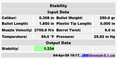

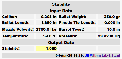

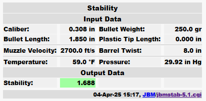

1:10 twist is too slow for the 250's to stabilise. The actual stability factor calculation needs a lot more than just bullet length. Miller and Greenhill are poor approximations at best.

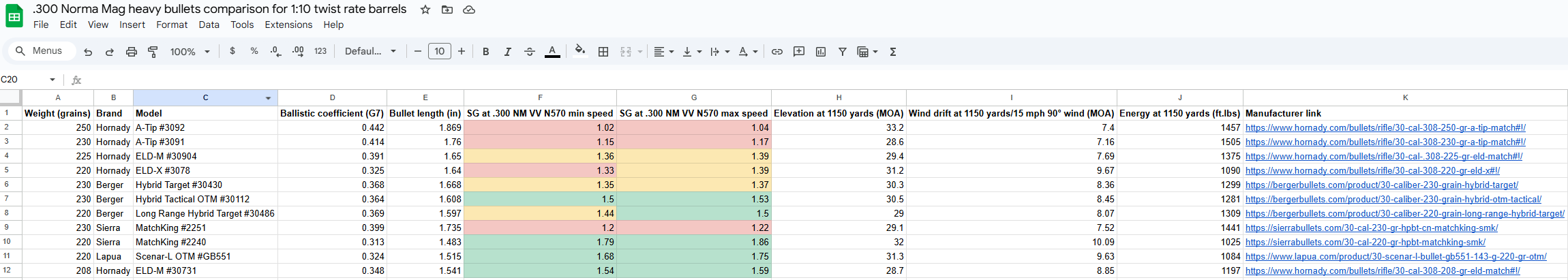

As there are lots of information and lots of bullets to compare, I compiled everything in an Excel sheet here.

Indeed, one of the best performing bullets in the list above! Thank you!

230 Atip should be Okay in 1:10 (but barely). 250's will not be.
Barely ok I believe (C.F. the Excel sheet above).

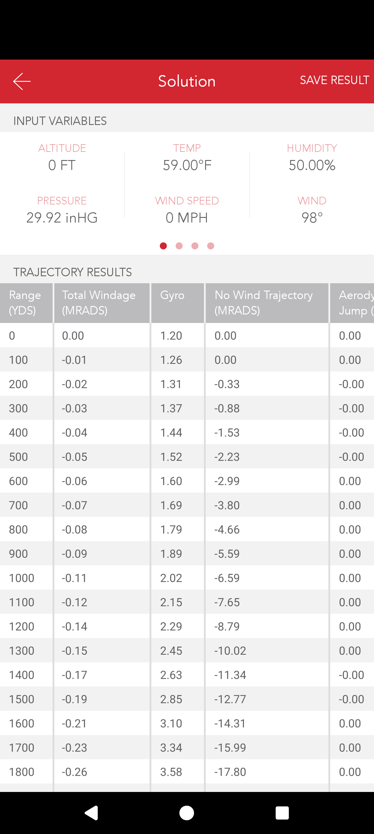

If you ever have questions about stability with Hornady bullets or bullets in the 4DOF library, use 4DoF to check gyro. It uses a physical model of the bullet, not a generalized Miller style formula.
Here's the 230 in a 10 twist at sea level. Should shoot groups fine but will probably have some extra drag.

You need an 8 twist to shoot 250 a Atips and a 9 twist to shoot 230 Atips.
The 250 gr Atips will not stablize in a 10 twist even at 2985 fps, in 300 RUM 26" barrel.
But I shoot them at 2500fps in a 308 8 twist with accuracy, and the 9 twist 308 22" 230 Atips 2600 fps with accuracy.
