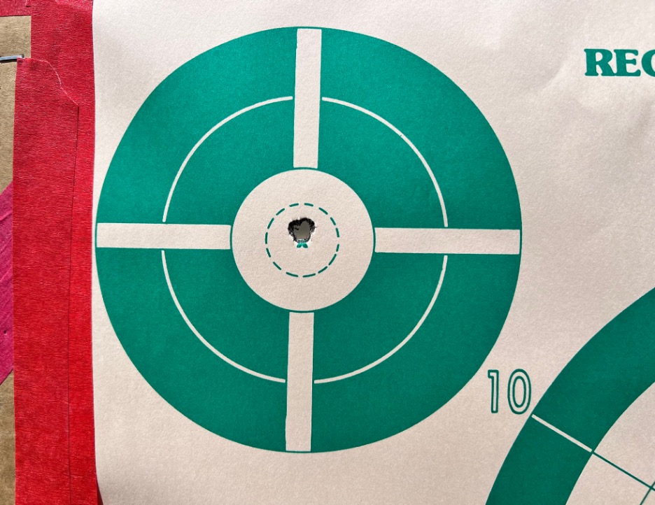

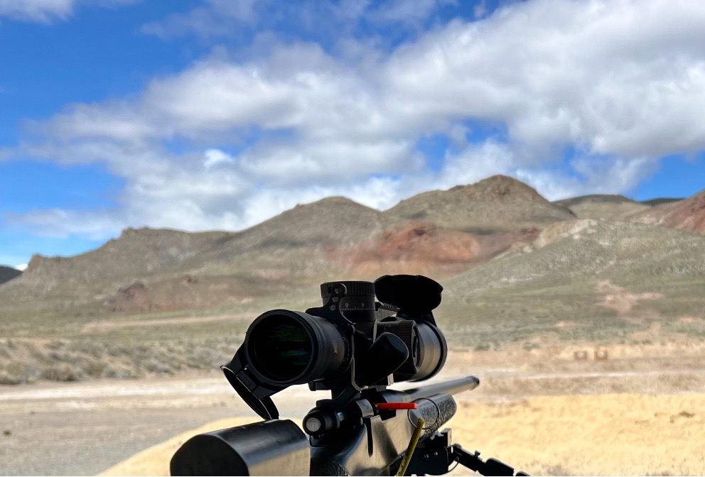

Here is my latest 100 yard zero group for this rifle, cartridge and Razor Gen 3 on a day with not much wind, to provide an idea of the accuracy:

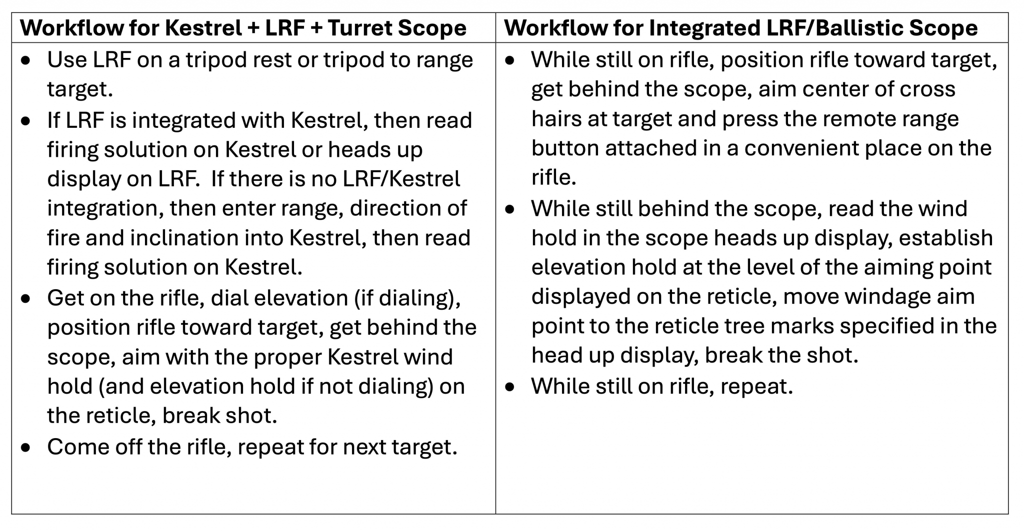

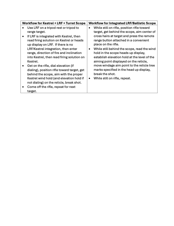

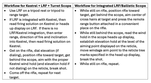

Targeting Workflow Comparison:
For those not familiar with the targeting workflow differences between the E6 and separate LRF, Kestrel (or other weather/ballistics solution device) and conventional turret or tree reticle scope, here is a comparison:

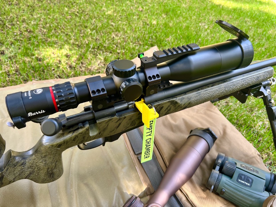

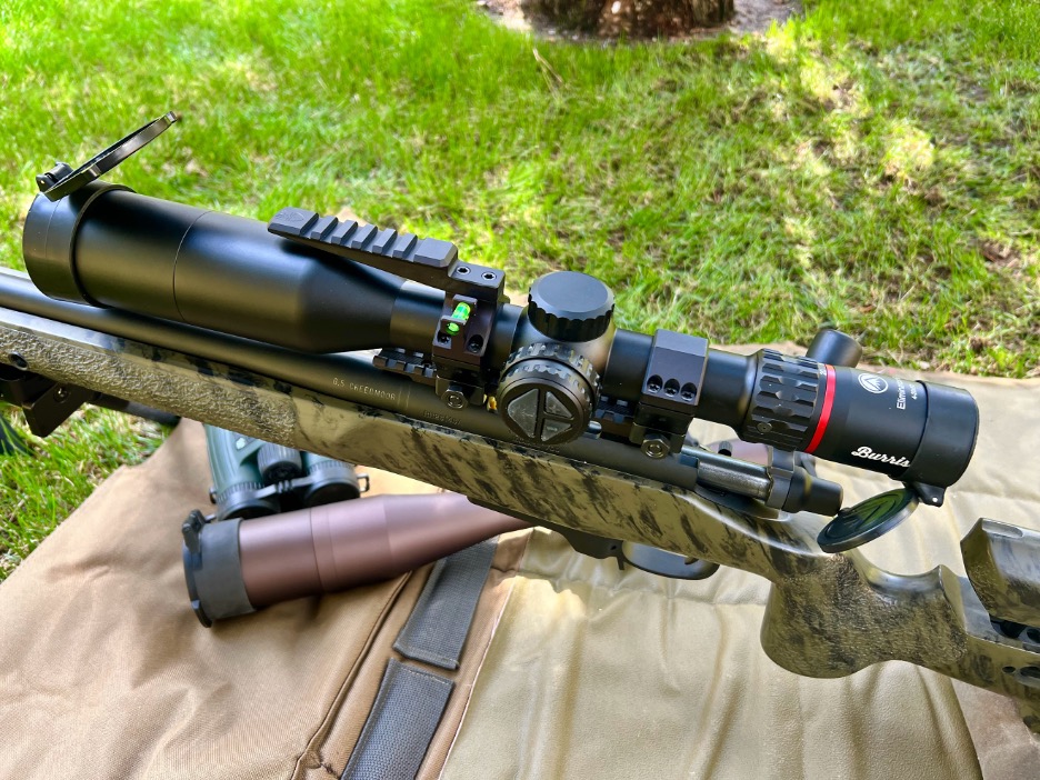

E6 Form Factor and Aesthetics:
Unlike some past versions of electro optic scopes with built in LRF and ballistics that need special mounting systems and/or look somewhat odd due to extra appendages to house the LRF and electronics, the E6 is a normal looking scope. Someone who doesn’t know what it is would think it looks like a scope the Burris XTR or XTR Pro line, except for the smaller turrets:

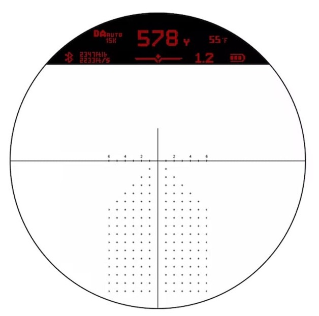

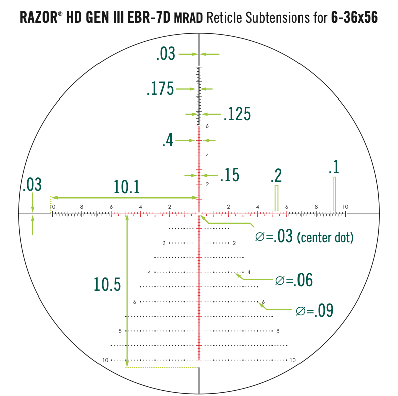

The E6 has an X177 SFP reticle with hash marks along the horizontal cross hair and little crosses on a regularly spaced grid for the reticle tree. The elevation aiming solution is displayed as a dot on the vertical cross hair, and the heads-up display provides the windage hold off value measured in the number of horizontal crosses from the aiming dot.
Because there is a lot of empty space between the horizontal crosses on the E6 tree reticle, it is not as easy to hold for a precise aiming solution as compared to dialing the turrets and holding along the main horizontal cross hair in a conventional turret scope like the Vortex Razor Gen 3, or as compared to holding over and holding off on a mil or MOA tree reticle with more closely spaced hash marks, again like the Razor Gen 3. The sparse reticle marks is something Burris can easily, and should improve in their next version.
I have not been able to find the specs for E6 X177 reticle subtension dimensions and I did not have time to precisely measure them on a calibrated grid target. I was able to estimate the spacing between the little crosses at 20x magnification by dividing the come up in mils from the Kestrel aiming solutions by the locations of the aiming dot on the E6 reticle (measured in grid spacing increments) times 3.46 MOA/mil. This results in an estimate for the cross grid spacing on reticle very close to 2 MOA, so I assume the spacing is 2 MOA on 20x magnification. If anyone has the Burris published subtension specs for the E6 on 20x magnification that would be great.
For the way I use long range scopes, the Vortex EBR-7D MRAD mil tree reticle is considerably better than the Eliminator X177 reticle. The “little crosses” spaced at about 2 MOA on the E6 reticle tree requires more time to accurately center the POA on target because you need to estimate where the POA is in the significant empty reticle space between the crosses. Even after taking the extra time, for me the POA accuracy is not as precise as can be achieved with the Razor tree reticle that has lines on the tree and finer, 0.2 mil marks. This is something Burris could address in the next Eliminator version. However, the E6 reticle is quite usable out to about 1,000 yards as evidenced by the shooting results reported below.
Past versions of the Eliminator product line were reported to have a yellowish tint that resulted from the coatings necessary to display the aiming dot along the vertical cross hair. There might be a slight discoloration in the E6 image, but it is not very noticeable (if at all) to me.
There seems to be more parallax error with the E6 aiming dot than the reticle marks, also more than a conventional scope reticle that has good parallax performance. In the testing I carefully tuned the parallax knob and tried to center my eye in the eye box to reduce parallax error for the aiming dot.

  • Then I changed scopes to the E6 leaving the rings in the same location on the rifle receiver rail, adjusted the eye relief and set the scope cant so that the electronic level in the heads up Eliminator display matched the ring bubble level.

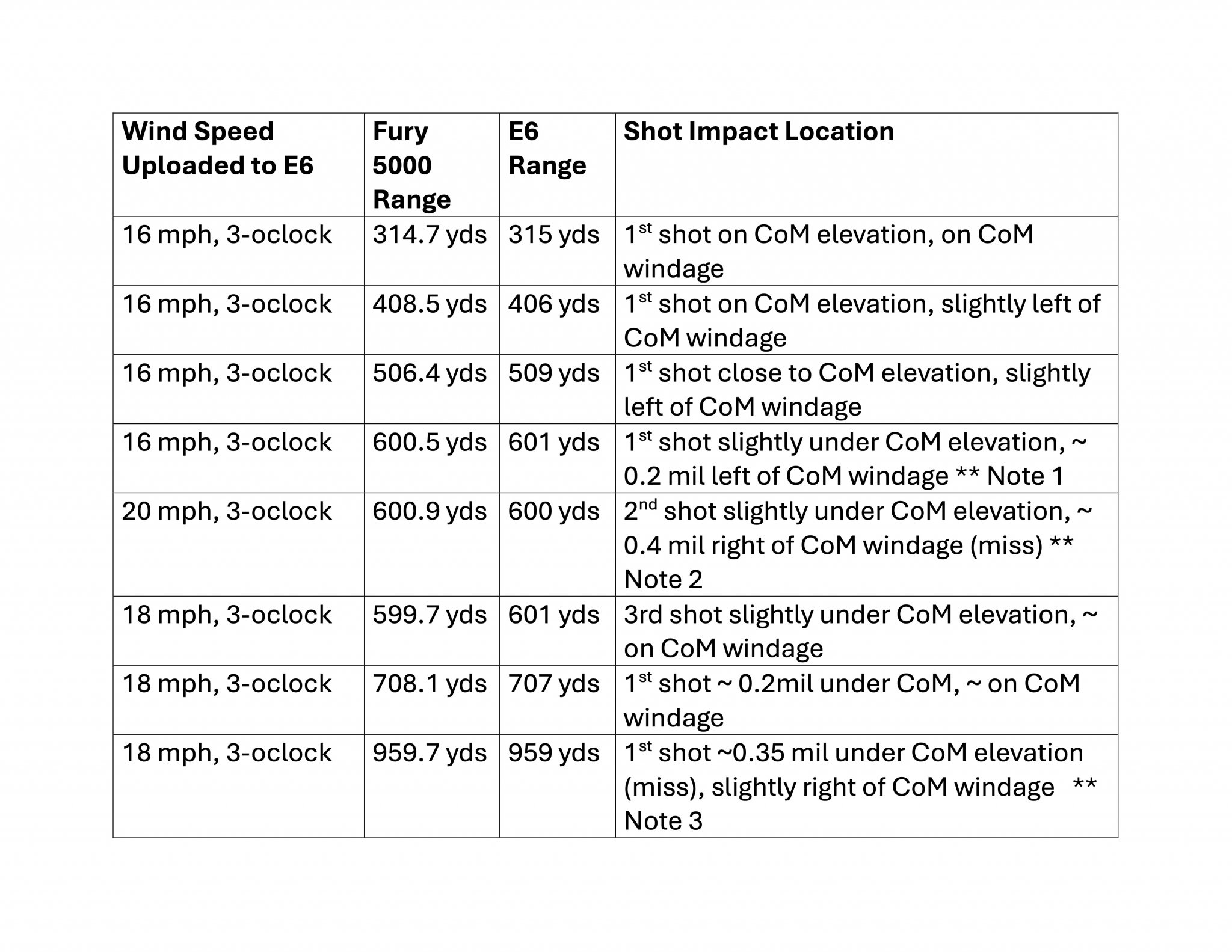

  • I then shot the target ladder at 100, 300, 400, 500, 700 and 960 yards with the E6 and recorded (a) the target range values displayed by the E6, (b) the elevation hold-over of the aiming dot visually estimated by the number of reticle tree lines down the vertical cross hair (estimated to one decimal), (c) the windage hold-off displayed in the scope heads up display, and (d) the hits/misses with impact location on the plates or in the dirt next to the plates. At each range, I also recorded the real time Kestrel come-up and wind hold value as the density altitude and temperature changed.
Shooting Results With Kestrel / Fury / Razor Equipment:
Kestrel / Fury / Razor Shooting:
The wind speed and the density altitude were both higher than they were when I previously zeroed the Vortex scope, so the Kestrel solution at 100 yards said 0.2 mil down and 0.2 mil right given the real time wind speed and density altitude measured by the Kestrel. I dialed 0.2 mil down, held 0.2 mils right and punched three touching holes about 0.15” to the left of center.
I did not end up shooting the entire ladder with the Kestrel / Fury / Razor combination because there was no need to shoot all the targets with this proven system. The wind call was averaging 16 mph and proved good, so after first shots hit center of mass (CoM) at 300 and 400 I skipped to 700 with another first shot CoM hit and then to 960 with a centerline impact for elevation and slightly right of center for the windage. I attributed the right of center impact to a real time wind reduction below average.
E6 Shooting:
After removing the Razor and mounting the E6, I zeroed the E6 at 100 yards on max 20x magnification with the group centered at the waterline and 0.7” left (0.2 mils) to account for the wind. This windage value for zero in a 16 mph R-L average wind is what the Kestrel provided. When I zeroed I was not sure if the E6 app and scope used the density altitude and temp that were in the ballistics parameter entry screen in the app or if the environmental parameters were determined by the on-board barometer and temp sensor in the scope. I assumed it was taking the current density altitude and temperature in the on-board scope electronics so I did not set the zero 0.2 mil high like the Kestrel said. I later asked Burris customer support where the E6 gets the environmental data, the scope or the app, and the customer support person said he thought it came from the scope even if you input different values in the Burris Connect app ballistics screen, but he was not sure. After the shooting session I did find a screen where you can override the on-board environmental electronics, so I assume without the override the E6 gets it’s environmental data in real time from the on board electronics.

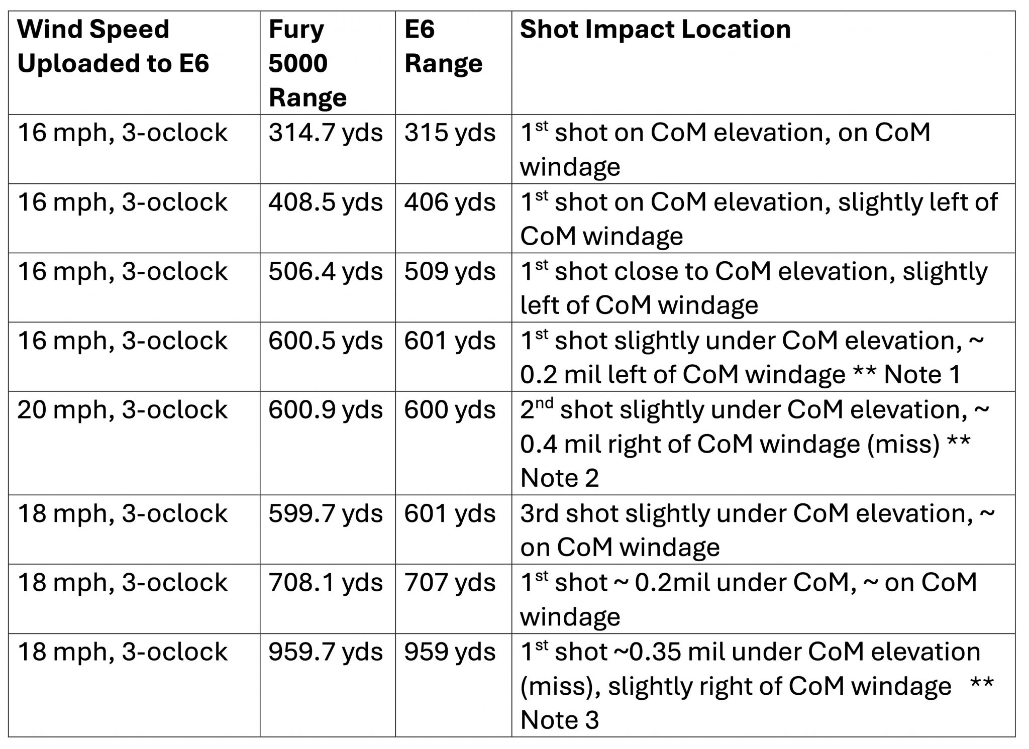

After zeroing the E6 I shot the steel target ladder. The wind picked up a little between shooting with the Kestrel / Fury / Razor equipment and the E6, so at 600 yards I adjusted the wind value in the Burris Connect app and re-upload it to the E6 scope. All of the E6 shooting was done with magnification set to 20x. Note that the stated target ranges (300, 400, 500, etc) are approximate and the actual laser measured distances were different and change with shooting position on the firing line.
Summary of Shooting Results with E6
  • Note 1: After shooting the first 600 yard shot I determined that the wind had picked up down range and the hold needed to be increased. I increased wind value from 16 to 20 mph in the Burris Connect app, uploaded the updated ballistics to the E6, and shot 600 again.
  • Note 2: After shooting the second 600 yard shot I concluded I had overcorrected the wind value. I tried adjusting the wind value to 18 mph in the Burris App and re-uploading ballistics, but the wind hold in the heads up display did not go down. After re-reading the manual and looking online for quite some time I could not find any information about why the wind hold was not changing when I changed the wind speed in the app and re-uploaded the ballistic parameters. After going through the Burris Connect app screens for quite some time, I stumbled upon the fact that there are two places to enter wind speed in the Burris app. One place to enter wind speed is in the "Ballistics" app tab which apparently updates only the Burris app dope card but DOES NOT update the wind speed during upload to the scope. Another place to enter wind speed is in the "Optics" app tab which apparently does not update the app dope card but DOES update the wind value for the scope during upload. After the first 600 yard shot I must have adjusted wind speed to 20 mph using the "Optics" tab and then tried unsuccessfully to change it back to 18 mph in the “Ballistics” tab . For the third shot I used the "Optics" tab to change wind speed which uploaded to the scope correctly at 18 mph. I then reshot at 600 yards. Burris should correct this so that there is only one place in the app to enter wind speed and other environment variables to avoid this kind of confusion and eliminate differences between the app dope card and what the scope is actually doing. The only way to know what the scope is doing is to either read the dope card or shoot with the scope, and it would be way better if the dope card represented what the scope is actually doing.
  • Note 3: After the first shot at 960 yards it became clear that the E6 elevation solution was about 0.3 mils +/- low. For the second shot at 960 yards I came up from the E6 aiming dot about 0.3 mils (as estimated using known target size of 24x24”).

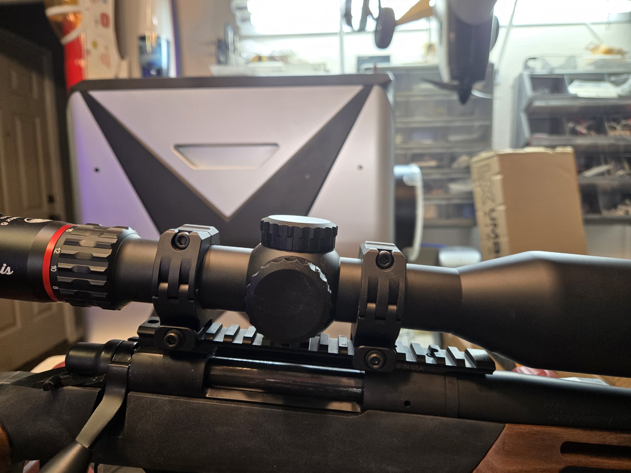

I have my Eliminator 6 mounted on a 7-300WM utilizing ARC 34mm rings. Prior to the Eliminator I had a Razor GenIII 6-36 on said rifle. As this rifle is primarily used for hunting, and I have had good results with prior model Eliminator series scopes on other hunting rifles (currently own 1x Eliminator III and 2x Eliminator IV's) when the 6 was released I thought it would be good addition. To mount the scope I used the same ARC rings since the Razor shares the same 34mm tube, simply loosened the clamp bolts, lifted the Razor out, and dropped the Eliminator in. Simple enough. For those who are not familiar with the ARC rings and one-piece mounts, they specify a pretty heafty torque specs, namely 55 in/lbs.
Talked about in length here:
I thought (and still do think) that these specs are somewhat aggressive, so on my GenIII I used 45in/lbs with no issues. Well, as you may have already guessed, the Eliminator 6 did NOT like 45in/lbs, even with the ARC design. Not realizing this, and having used the GenIII with no issues, I stupidly thought the scope was defective. Yes, I'll admit to being wrong.
Fast forward to this last Monday, I finally received my replacement Eliminator 6 after a two month wait, but to their credit, Burris flat out gave me a new scope. So I took it out, played with it, and everything moved freely... great! So I then of course mounted it and wouldn't you know, the parallax was bound up. Insert light bulb moment here...
Here is the actual issue that I really mean to bring up though, the front ring in particular was the issue, and unless the ring was pretty damn close to the center section of the scope, it still had issues even at only 15in/lbs of clamping force using the ARC rings. And not only with the ARC rings, once they caused a bind I tried Vortex Precision Matched rings that I had, and then a Spuhr 4022c that I have for an AR build, both of which caused binding if the forward mount was not close the the Eliminator's center section. So back on the ARC rings went, but with the front ring pretty choked up, torqued to 30in/lbs, and no issues at all. But one picatinny slot forward on the front ring causes the parallax to bind. I could not even put 10in/lbs of clamping force using the Vortex ring in front of the center section, providing the ring was centered between the center section and front bell, without binding the parallax. I know it is a totally different design/build, but the GenIII simply shrugged off 45in/lbs with zero binding when mounted in the same manner.
I guess the reason for my posting all of this is to hopefully save someone else from making the same mistake I did. I do think the Eliminator 6 might be somewhat hyper sensitive to the placement/torque of the front ring (rear ring made no difference, I experimented some, placement and torque did not bind at all) but as mounted the scope is secure, and everything moves as designed. YMMV, but this is basically what I found, I'm sure someone has a good explanation as to why this is.
