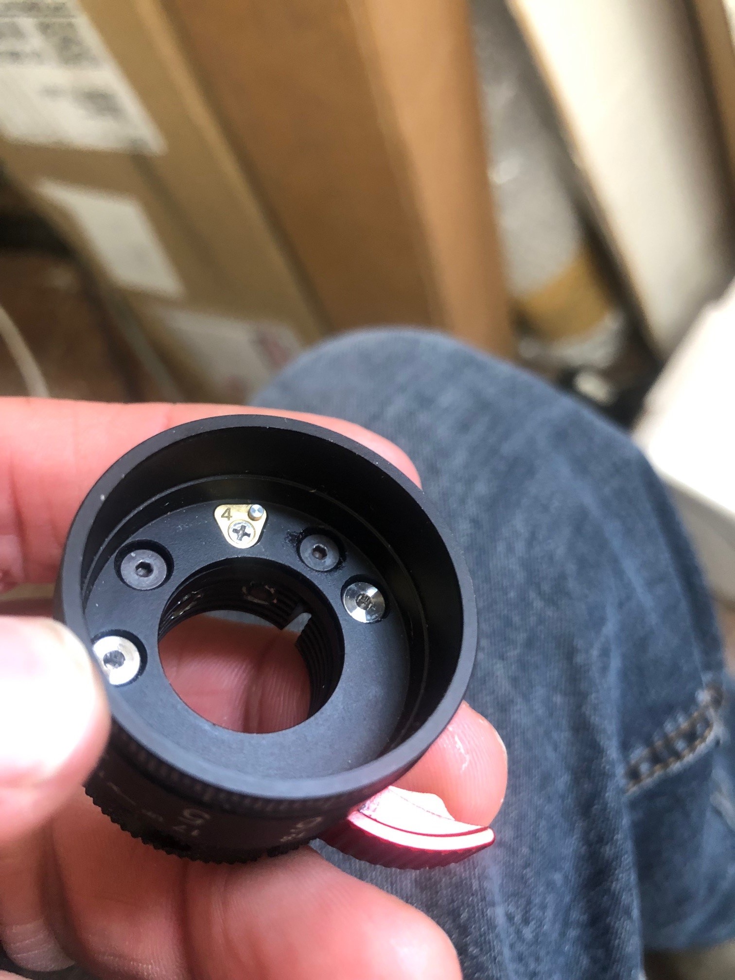

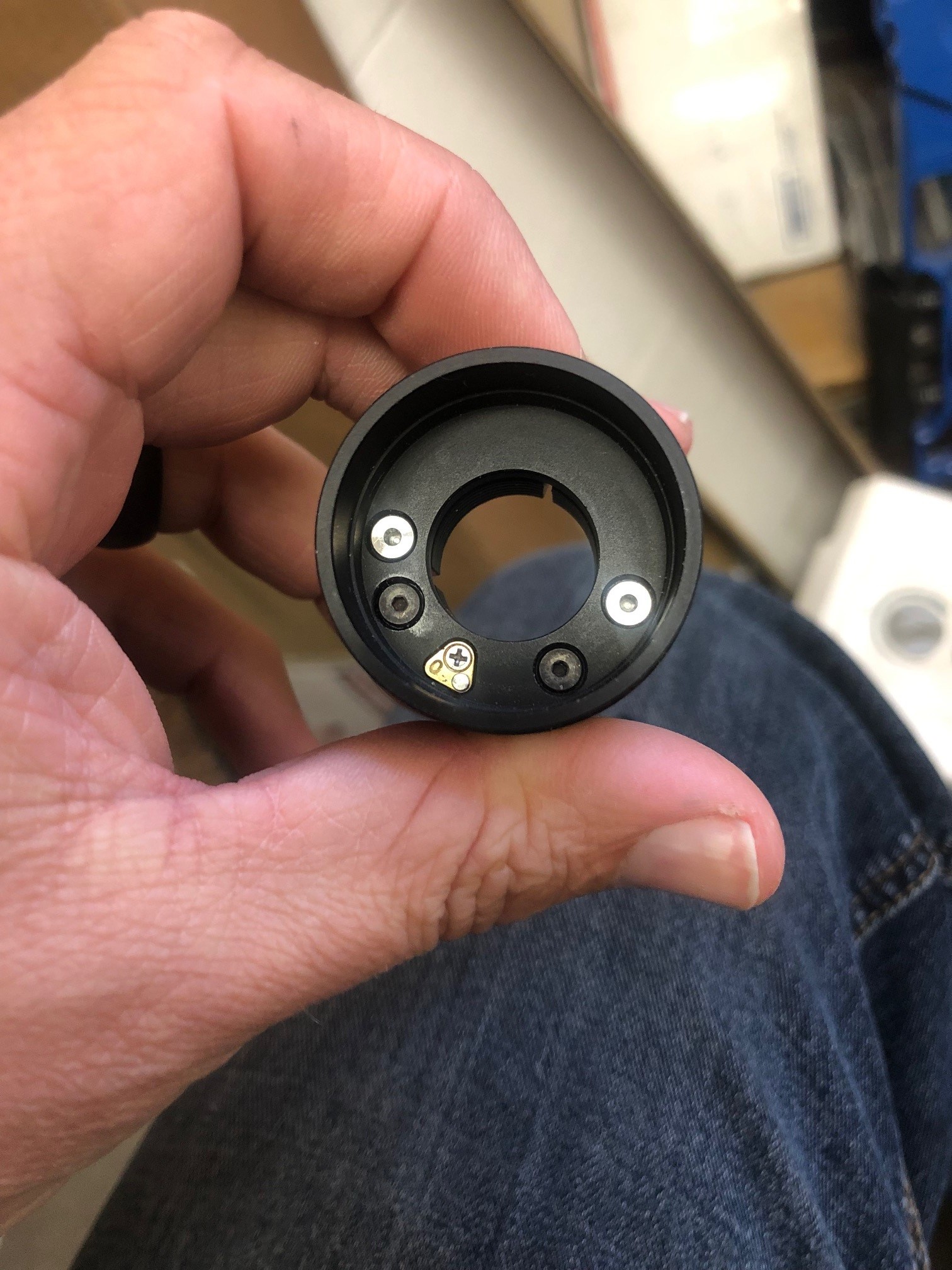

    turrets
    below zero settings: under the turret is a bass triangle.
    Factory setting stops the turret at 0
    Flip it over gives a -0.4
    take it out and it can go down till turret hits. All scopes will be different here. Will not effect function.
    on my 6.5x47 with 20 moa base and 100 yard zero
    I have 21.3 mils of up to dial. that was cool to see. (IIRC I had very similar to that on my rimfire with a 50 yd zero)
    pulling the triangle out, and pushing the turret all the way down gets me -.7 on my scope. I imagine it will be close with most rifles.

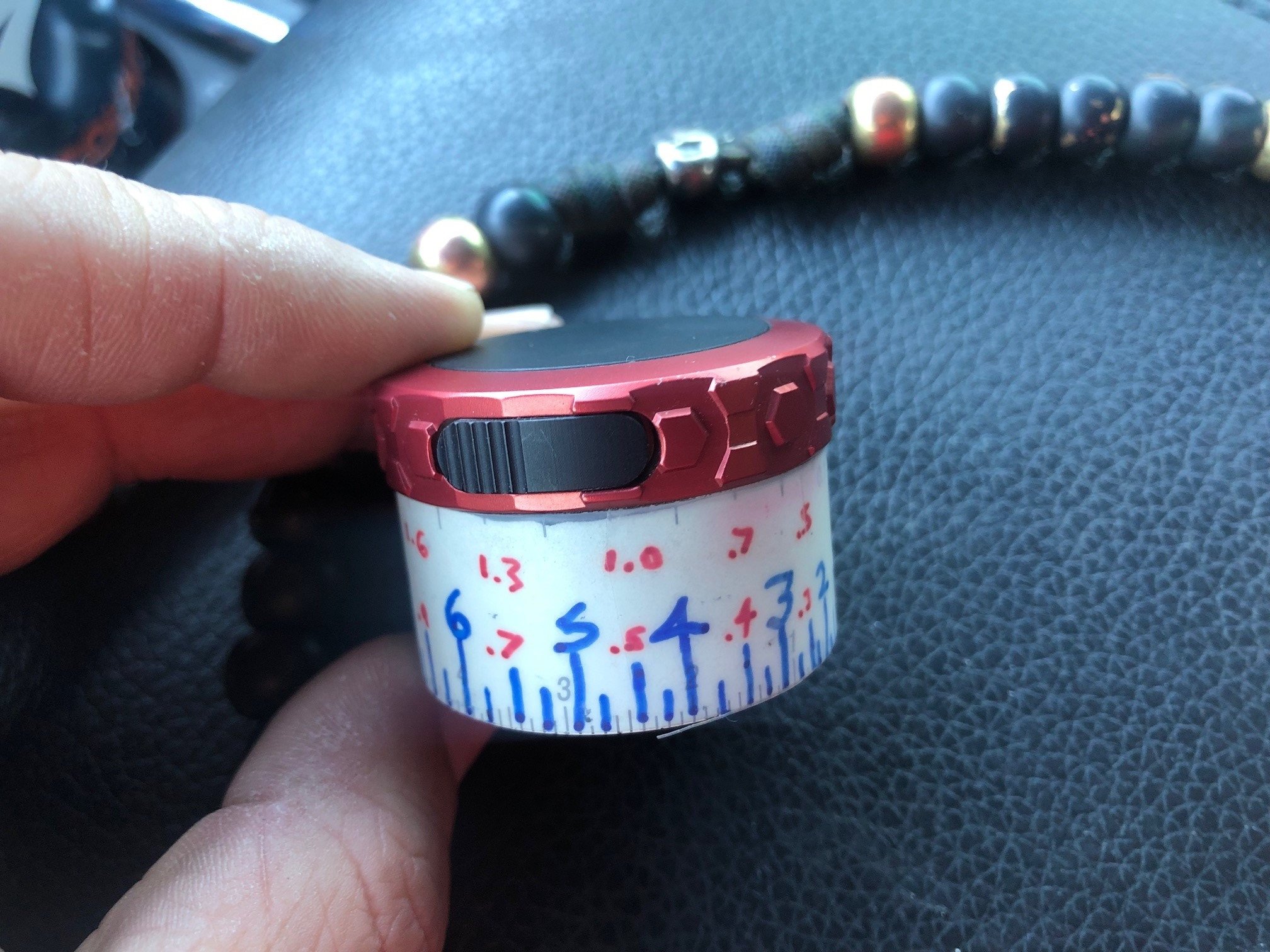

    heres the catch I cant believe I didnt think of before, and what the tooless quick detach turret allows: if you loosen the throw lever and lift up the turret even a tiny bit, and re-tighten the throw lever, I instantly had 3 mils under I could dial.
    So essentially it is a super easy super fast way to have as much under zero as you desire that you could use in a match situation or leave on all the time.
    also using the white board target turret in the BDC format in a field match scenario

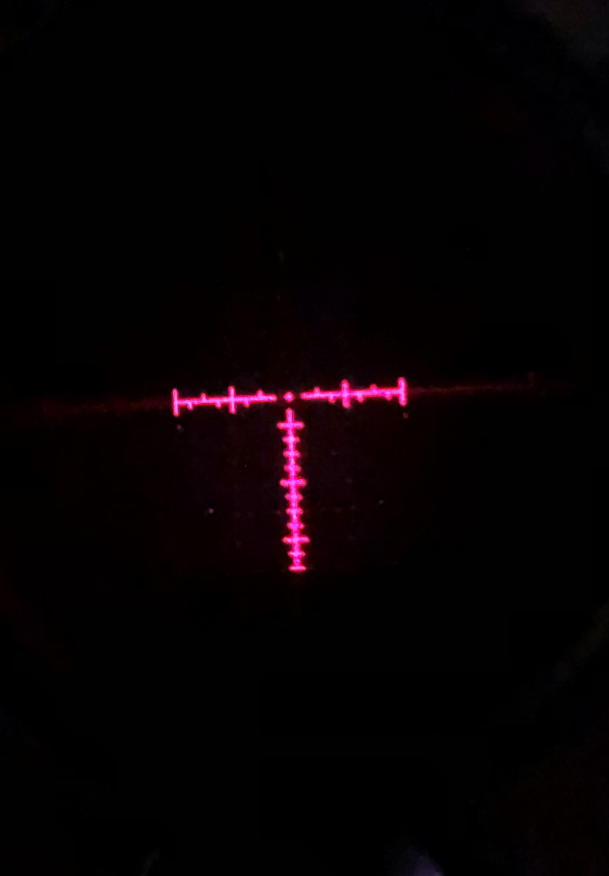

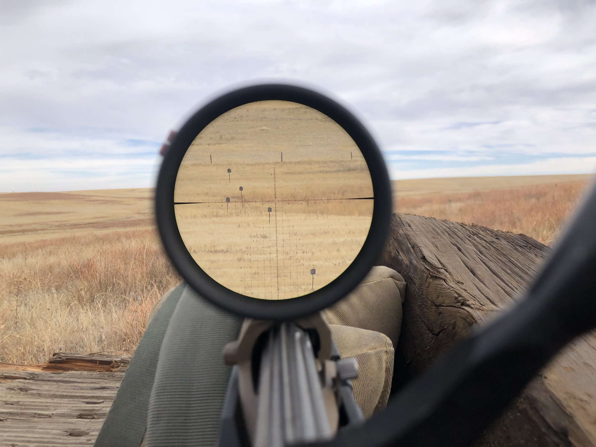

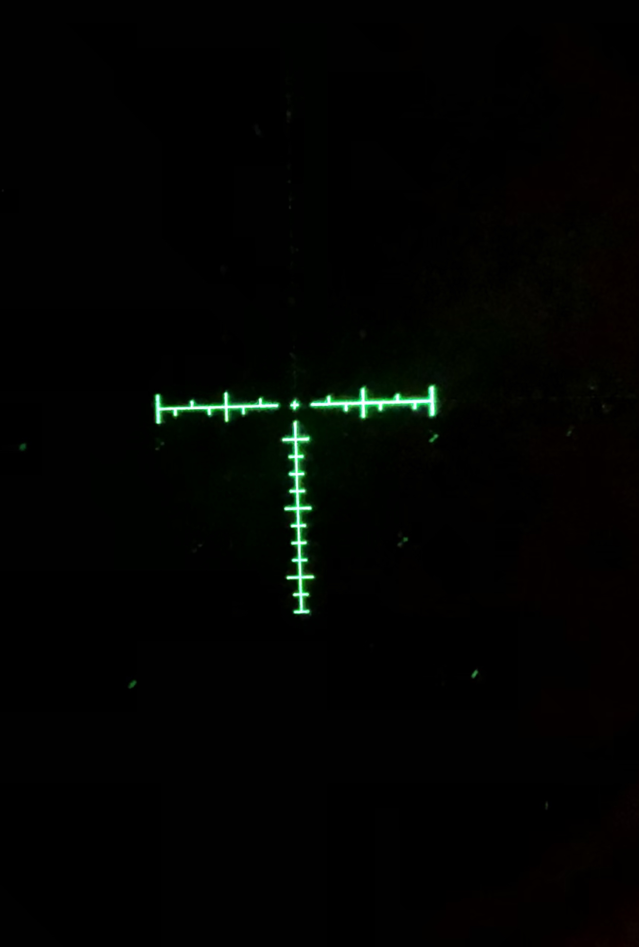

    Oh gosh, that reticle. JVCR, PR2, and now an updated SCR with easy to read windage marks. This looks fantastic. I have a hard time discerning .6 and .8 from each other on some reticles, and the up, down, up, down rotation is so much better than the old sine wave patterns.
    Tremor5 gets rid of my biggest complaints with the Tremor3. Those "mover" marks on the Tremor3 suck.
    I just hope the glass is good. I wanted an XTR3 but heard that same story in the glass department as the 2.
    All of the XTR2s that I've had were miserable, to the point that I actually emailed burris when I recieved the first one to see if I needed to send it back.
    SCR2 vs SCR-Q in your opinion?
    I get that .25mil should be less cluttered, but the SCR2 isn't a particularly cluttered reticle to begin with.
    Do you think the SCR-Q actually offers a notable improvement?
    i think our brain works in quarters quicker than .2’s and so we dont sit there as long and can react quicker.
    also less likely to over think a wind call maybe…
    i designed the 1/4 ret for the xtr3 and noone bought in. got the idea from my march 5-40 had a 3/4 mark that i loved. i think less is more is growing.
    again ive only used it in one match. and i was shooting a 308. in 30-50 mph winds. precision wasnt a concern.
    i just arrived in AZ for an NRL match with my 6.5 creed. very excited. i almost think .2 is over precise. cant wait to report back.
    whats your thoughts??
    I'm inclined to agree. Even looking at your pic above, if you look away, and say to yourself to find .75 as fast as you can, and look back at the picture, it's easy to find it. Do the same for .25, and .5. You can find .6 and .8 on the SCR2 just fine, but it's easier to find the .75 on the Q.
    Someone's going to reply saying to not be a b!tch and stop whining, but eye strain while on the clock for a full day or two will wear on your ability to make impacts. It's not about the SIN wave style being a problem, it's about streamlining the process to make stacked marginal improvements.
    Reactions: D_TROS
    This looks like a home run. I’m definitely getting a couple. I wish they’d have done a 3.3-18 version as well. Modern hunters need some lovin’ too. Lol.
    I’m also really liking the SCR2-Q. Even just looking at it in the pic you posted @D_TROS it seems faster to me.
