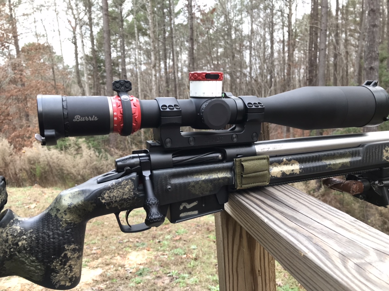

Here’s an idea of height. This is a 1.18” height mount and a 56mm scope on my Vudoo. That barrel is heavier than the Bergara factory barrel. Plenty of height.

Love the look of that Vudoo, that's probably the next stop for me.
