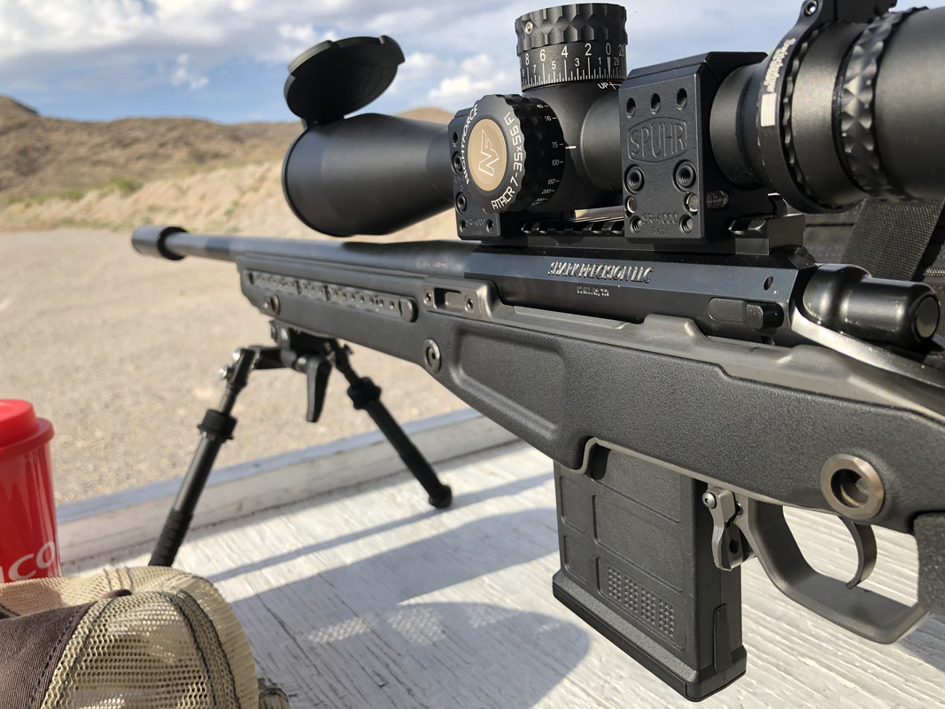

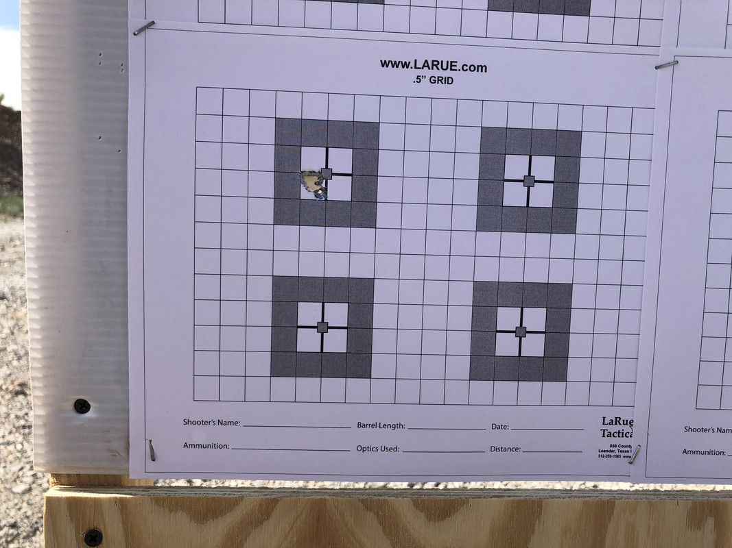

Funny this thread came up today. I just put this all to the test. Basically precisely what Spife said is all true.
I sized my 1x fired lapua a little "not enough" into my redding FL die and it left a little lower portion of the neck, where it connects to the shoulder, not sized by the bushing. Well I was worried it might impact groups so I went out and shot a 5 round group at 100 yards and it printed this .29moa group and that INCLUDES the cold bore round too:)
And this was just like 3 days ago.
