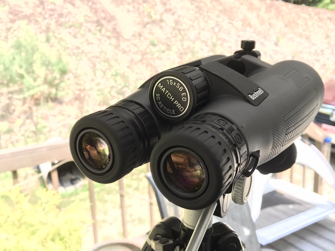

Got mine today and had a chance to play in this blistering NC heat. Did a side by side with my trusty Leupold BX4 12x50, been using these about 2 years in prs matches. The Bushnell did really well, about the same optically. I'm in my fifties and wear glasses with an astigmatism and almost didn't have enough focus on the left barrel, but made it barely. The reticle is nice, focused well and is not obtrusive in field of view. I see the reticle being very useful in matches. Was really set on using my rrs cinch mount but I don't think it fits very well, feels sloppy with the size and weight. Overall, I'm very happy. I think if one is looking for binos for prs and you don't already have alpha binos these are a great choice.
