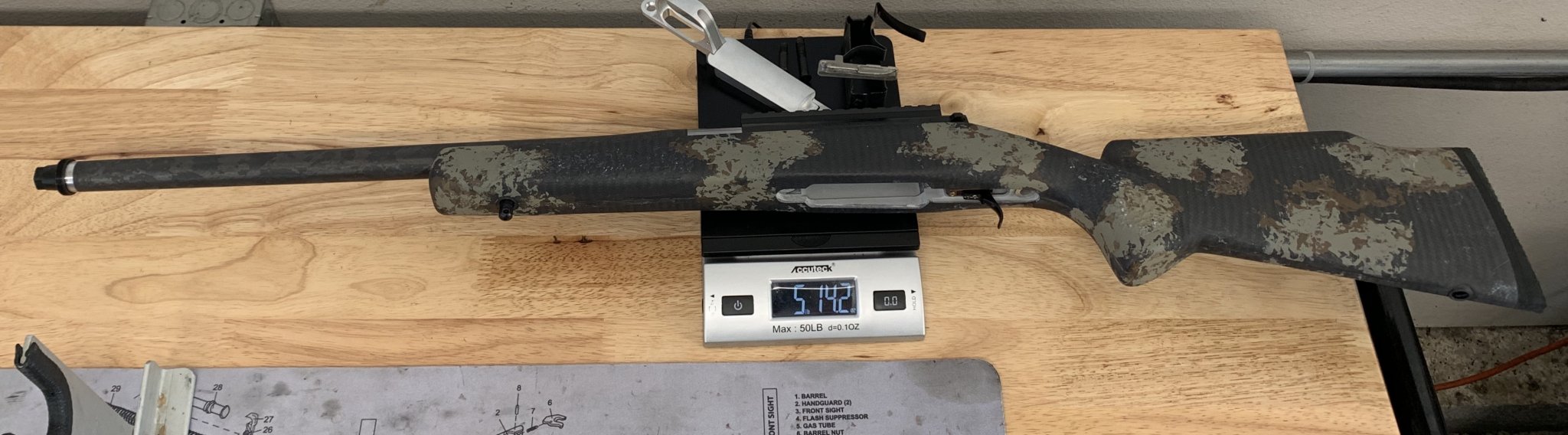

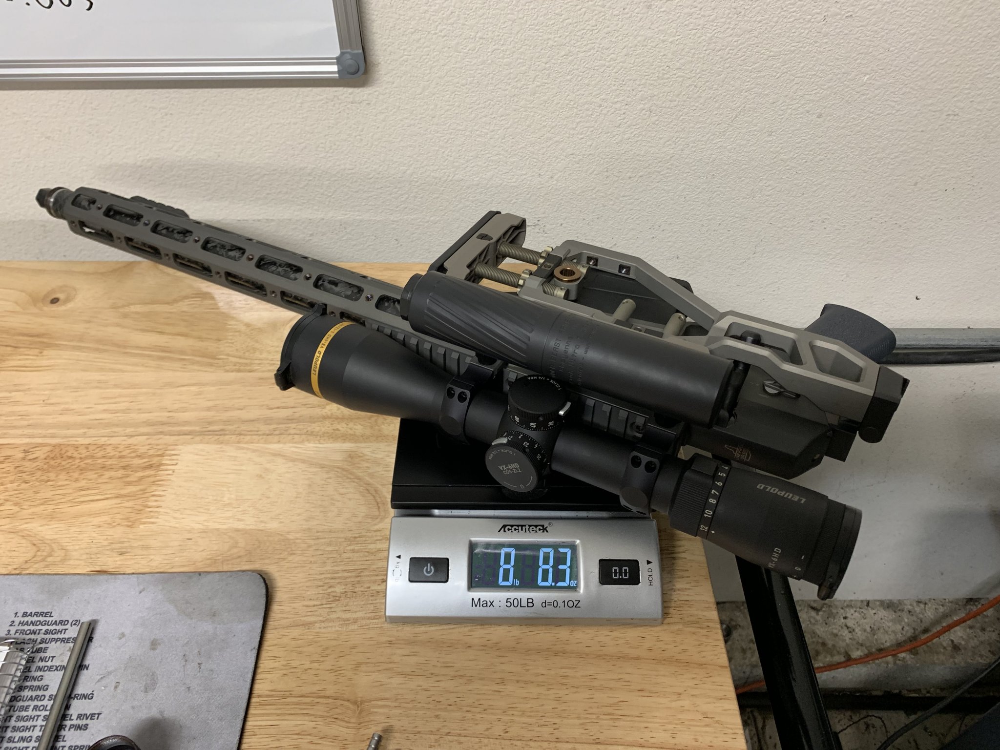

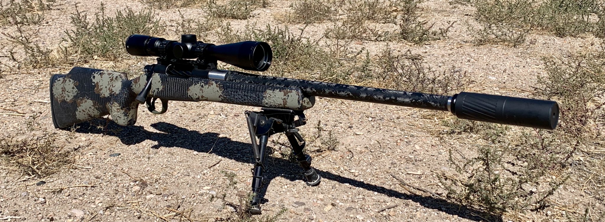

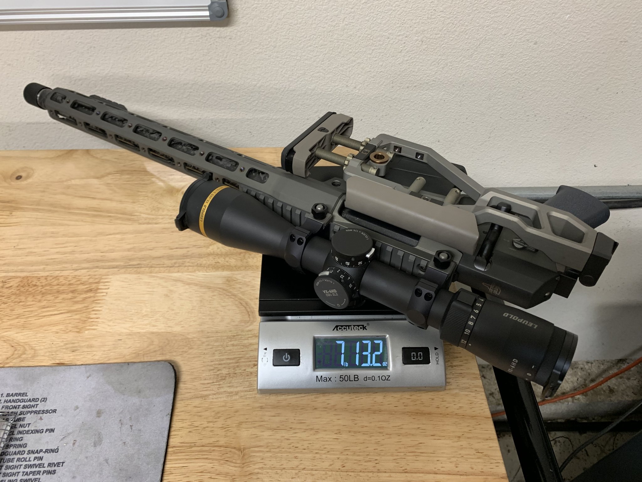

Unless you go really short on the barrel, and very light on the scope, you you won’t make sub seven lbs. you’ll be close though. A pencil steel barrel instead of a proof will get you there.
This a lone peak razor(steel), 20” sendero lite(6.5mm), Manners EH4. The rings are missing here. Not a low budget option by any means. Just finishing this one up.
It’s 8 lbs 3 oz here with the can (no bipod). Little over 7.5 without. The scope weighs 18.5-19oz if I recall. Razor HD LH. Highly recommend it.
