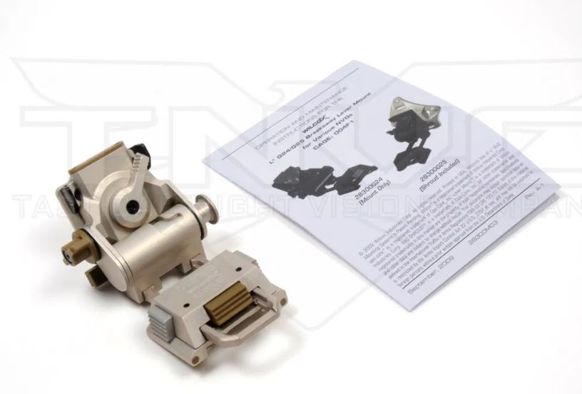

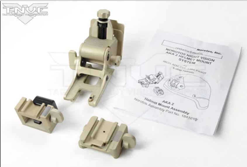

Is there a good reference, or thread for all the mounts? I'm confused as hell.
I have a used PVS14 with a J-arm and Rhino mount. It flat-out sucks.
Looking to get a dovetail style....BUT....I am unsure how they work, what parts I need etc.
The J-arm/Rhino system places the 14 in front of my eye, no problem....except if unclips and falls off if I breathe wrong!
If I get a Norotos AKA2 for example, does it, 1. come with the "dovetail" piece that attaches to the 14? and 2. It looks like it would put the 14 in the middle of my face and not off to the side over an eye....is there yet another piece that offsets the 14 towards my eye?
See my confusion?
This one comes with a dovetail type and a J-arm type. If I use the dovetail attachment, does it have another piece not shown to attach the 14 to the dovetail receptacle and then get it in front of my eye? There seems to be a piece missing here.
Or the G24
I don't know if it comes with the dovetail do-dad and if it offsets.
Thanks for helping with my dumb(?) questions!
