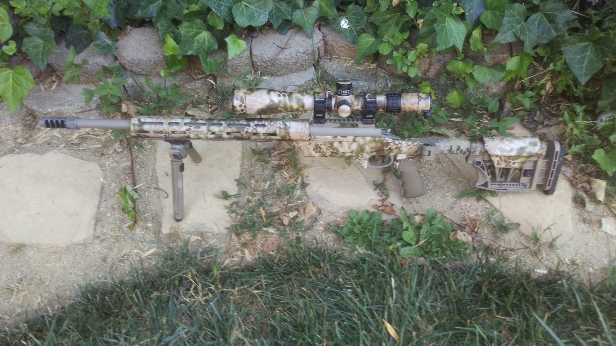

Instead of drilling into the chassis how about rotating the handguard 90 and just using a mlok arca rail
You cant rotate the hand guard, it is permanently attached with epoxy. The screws are just for initial alignment and cosmetics.
That said i just shot 250 rounds over the past 3 days and the Arca using the lug hole and the mloks available was rock solid. Even with 225lbs loading the bipod.
@Weatherby_Eyebrow are you still only using the mlok and swivel stud for the arca rail attachment? How's it holding up? Did you end up drilling into the handguard for another attachment point?
Yes i ran it for 3 days ~ 350 rounds at the July Mile High Class no issues, not a budge. As much as i would like to blame equipment for my inability to shoot!

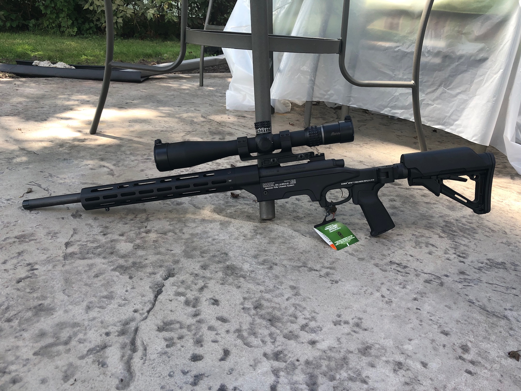

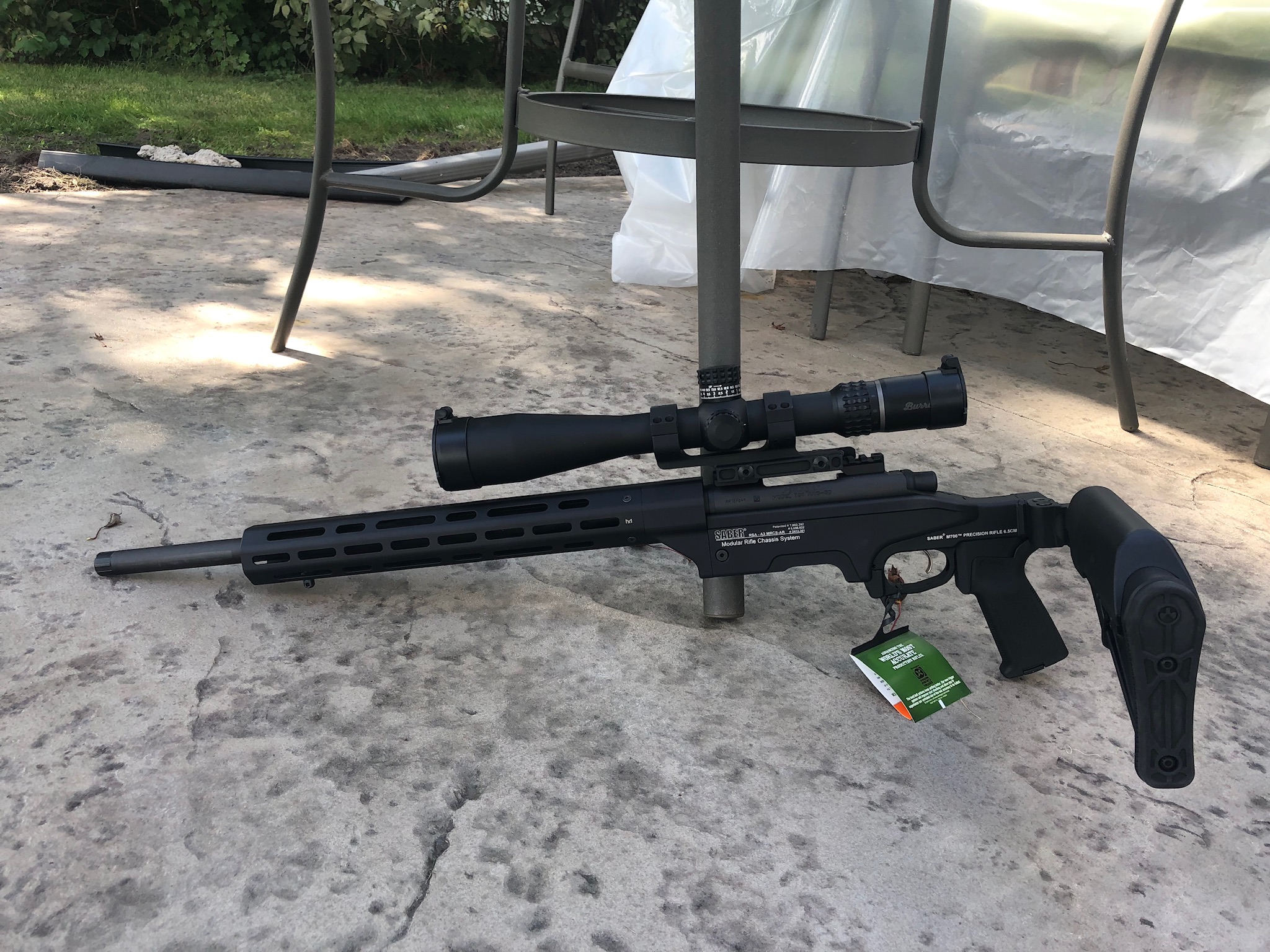

Going to need a different stock or rings because a 1.5” mount is too high for anything but a chin weld LOL. I knew this going in though. I’ll adjust the trigger next. Hopefully I’ll be able to hobble to the range and get some trigger time in before October.

I really like the XLR Tactical stock I put on mine, very adjustable and comfortable. I like the look and push button adjustments of the APO stocks I could not justify the price. I'm just going to use the buffer tube and CTR that I took off the rifle as justification to build a new AR.

I took some stiff foam that’s 1/2” thick from my reloading room and laid it on the stock. Seems to be just right. Just need to secure it and I’m ready. Either adhesive or duct tape.
