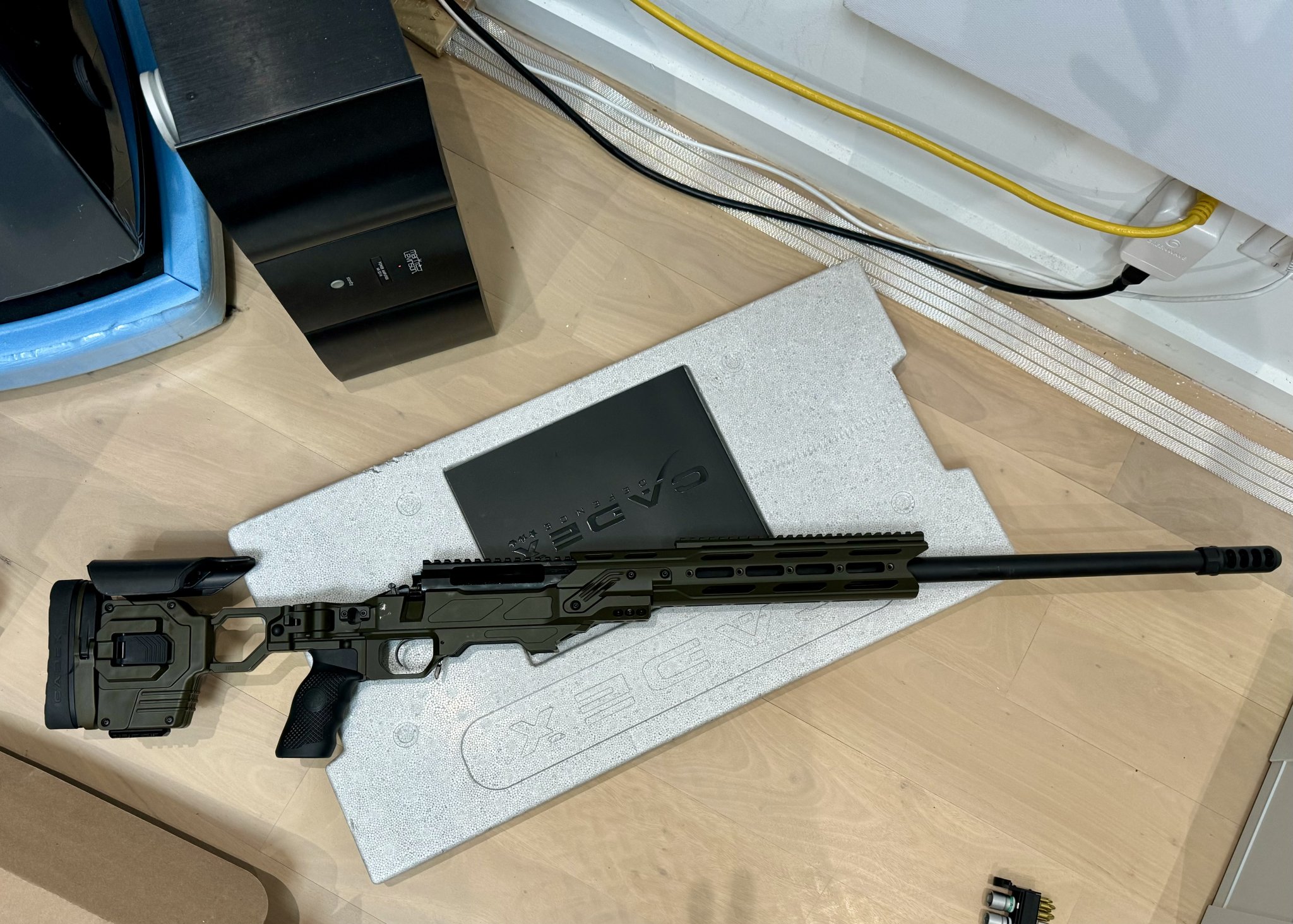

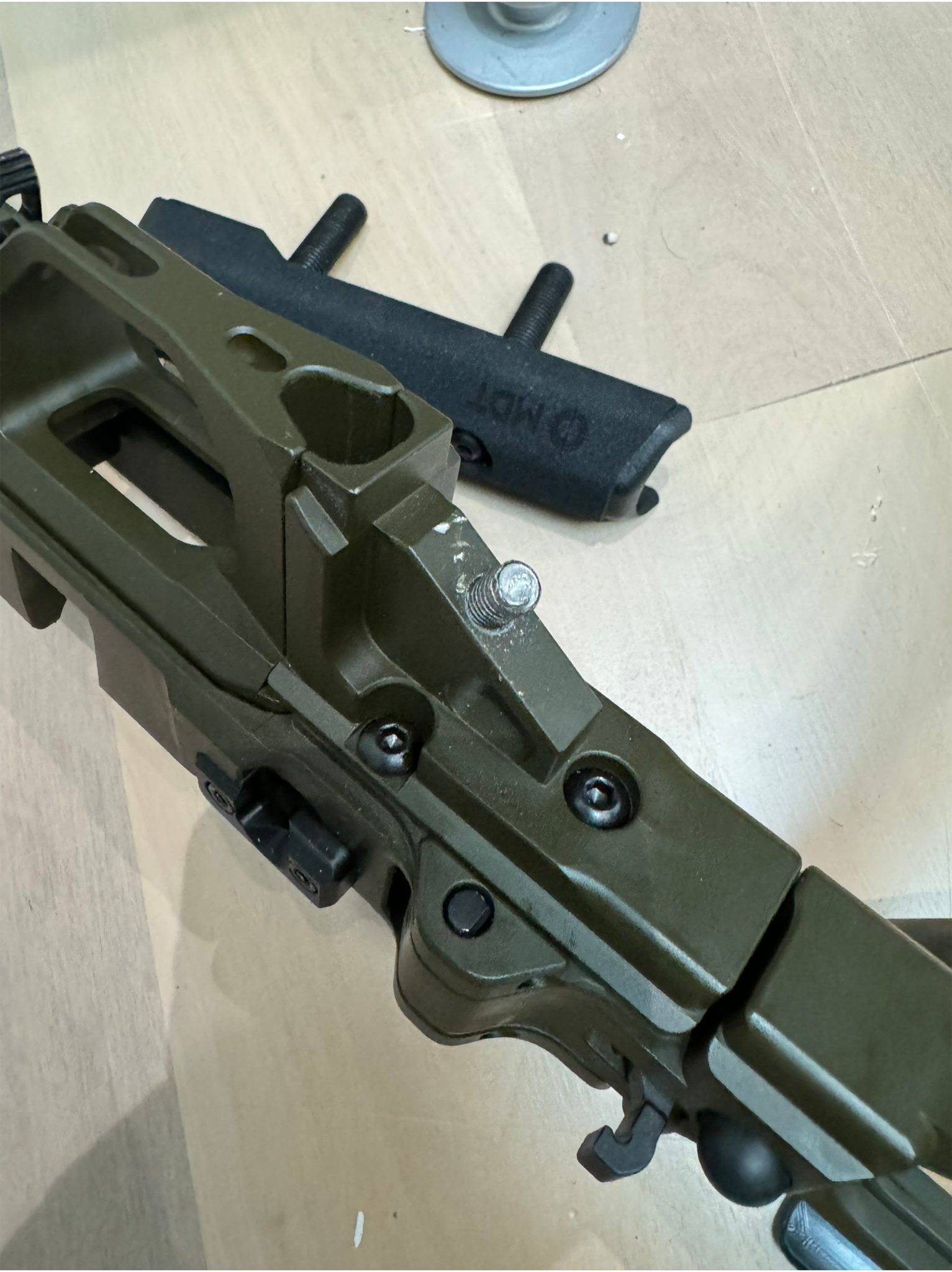

Hold and behold, just received cadex chassis i have bought from EuroOptics,
When tightening the hand grip it just snapped. I barely put any pressure, low quality screws. for 2400$ this is disgrace

Curious what all of the other scratches in the finish are from ?
Edit: From your picture the top of the exposed shank of the bolt looks pretty chewed up from pliers maybe. Could you have possibly cross threaded the bolt ?
I was trying to extract the thread, i barely apply any tourque it is cheap screw, shame 2400$ chassis. I own two Accuracy International AXSR, Quality is much higher. Extremely disappointment. i need to contact Cadex
So this is a cheap screw and you didn't apply any force, but simultaneously you can't remove it with pliers? Sounds alot like you cross threaded it....

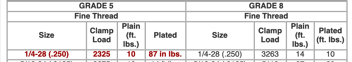

The odds of this thing shearing in half without you hitting min torque > 65in-lbs has to be near zero. Working tension for 1/4-28 is listed as with 87 in lbs, its failure point will be way higher. ie thats a substantial amount of torque to failure, typically well beyond what you would put on an action screw (65 in lb)...which also explains/is consistent with story of it would't come out.

The best way to take out a screw like that is going to be locking pliers, ie vice grips, but let a professional do the work, because if you wallow-out that hole tring to remove the part...you will make a time-sert style repair harder....at this stage ie of obvious failure...you really want a nice hole...ie straight, round, and of minimal size over spec.
And by putting vice grips on that screw is not going to look at all very consistent with following the OEM assembly directions... :ROFLMAO:
Get an appropriately sized pair of vise grips, clamp them on the shank good and tight and back it out.
Chase the threads with a good tap and carry on.
Or just wait for Cadex to respond if you don't feel comfortable sorting it out yourself.

IMO the bolt was too long and bottomed out then broke. This is why it is so hard to back out. Looks pretty square to me.

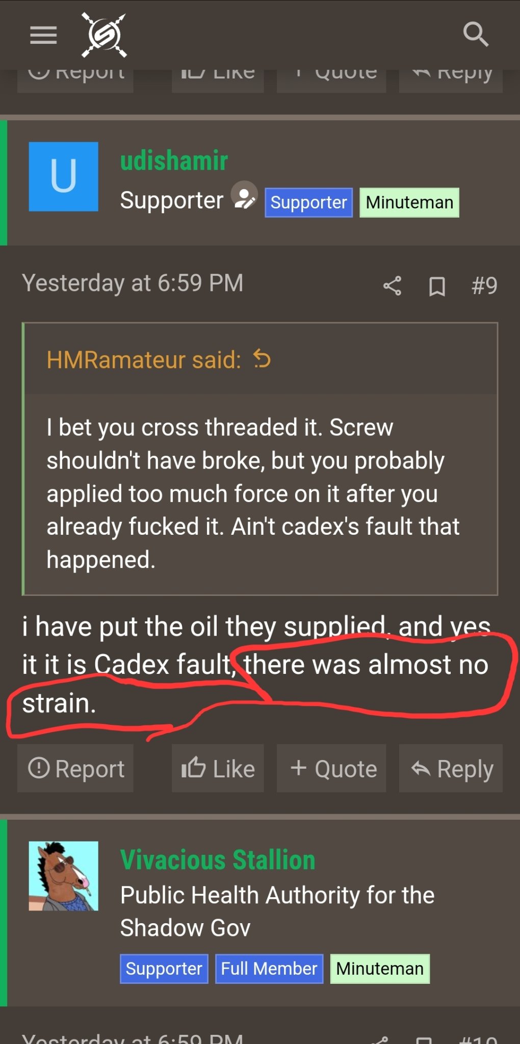

I'm my limited (sarcasm) experience with fasteners, strain (of any type) with respect to installing fasteners is a big, giant red flag. 🇻🇳🇹🇷🇹🇳🇲🇦🇰🇬🇮🇲🇭🇰🇨🇳🇦🇱
I have to agree with @Conqueror if there wasn't any resistance on the bolt it should basically back out by hand. If you force fucked it in there that's gonna be different. Either way I don't think it's Cadex fault. Basically I'd pull the bolt out, inspect threads get a new bolt and carry on. I wouldn't have made this post or contacted Cadex.

So far they rhavent do anything, i solved it by myself. i Solved it my self, open the broken screw, no damage was done to the internal thread. Now trying to find alternative to missing part they forgot to install, amazing!
I manage to extract the screw, no damage was done to the internal thread. Unfortunately the screw just snapped, if i "screwed" up was great lesson. Never happen to me with any other chassis.
