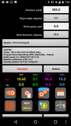

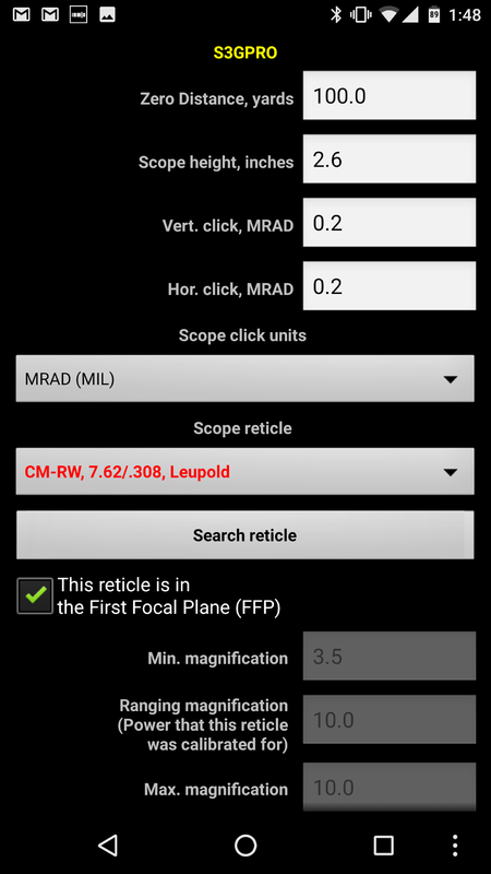

Very strange problem here. I'm having trouble getting anywhere near correct dope off my ballistic calculator and looking for some suggestions on where to look to find what data I'm inputting wrong. Here are the details:
Gun-
Seekins SPRO3G, 18in 1/8 barrel
Scope -
Leupold Mark 6 1-6 w/ CMR-w 7.62 in Warn RAMP34 mount. Measured with calipers at 2.6085 over bore. (process used was measure the end of the scope / 2, add in distance from bottom of scope to rail, add in distance from top of rail to middle of barrel)
Ammo -
Factory loaded Federal GM223M, 69gr Sierra MK BTHP, 2830 average MV (checked via LabRadar), G1 BC of .301, zero at 100 yards
Using Strelok Pro but very similar results in Kestrel 5700 elite. Distances acquired with Sig Kilo 2000.
335 yards:
Calculator - 1.35 mrad, result way low
Actual hits on 8" plate - 1.8 mrad
427 yards:
Calculator - 2.21 mrad, result way low
Actual hits on 8" plate - 2.8 mrad
505 yards:
Calculator - 3.05 mrad, result way low
Actual hits on 8" plate - 3.6 mrad
As you can see the calculator is WAY off. I played with changing variables until I could get close to the required clicks on the calculator and found that if I drop the scope over bore to 1.75 and drop MV to 2700 my calculator matches pretty well with actual results.
What could I be putting in wrong here to be so far off? It doesn't make sense that the calculator could be so far off from real results unless I put something in incorrectly - so that is what I'm working from. Any suggestions?
Thank you,
Chris
1) Zero weather was 64deg, 25.1 inHg / 26% Humidity. Shooting weather was similar but not exact. I did not record the shooting weather unfortunately. Could it have that much of an effect under 500 yards?
2) I haven't tested - what test should I do? I dialed until I had hits, then returned to zero and held the same mils. Did get hits when holding so I believe that the dial is correct.
Thank you for your help!
Chris

For sure - I believe this has all my inputs. Here is an example of the 505 yd calculation as well.
Thanks,
Chris

Good call on the Litz BC - but that makes my difference more! I know I have something wrong in here, I just don't know what. If my process for measuring bore height correct?

The simplest way to measure scope to bore height it to measure from the seam at the rings down to the center of bore in one measurement. It doesn't have to be accurate to the thousandth.
Agree 100% here. Do it this way. 2.6" seems to me to be a little high for your setup but I could be wrong.
