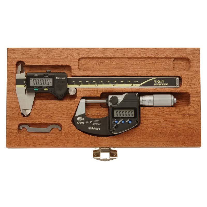

I have Mitutoyo calipers and a mic. I think they were both between 100 and 150 each, I cannot remember. They work fine. You don't need anything more.

I picked up a similar used Mitutoyo set up off of Ebay for $76 shipped, about six years back!
Check there and save.

I agree with Victor. I've got the nice Mitutoyo set above, but I mostly use my Midway (Chinese) caliper that I've had for 19 years. I do use the Mitutoyos for better resolution on certain jobs, but it's my trusty Midway caliper that gets used the most.
