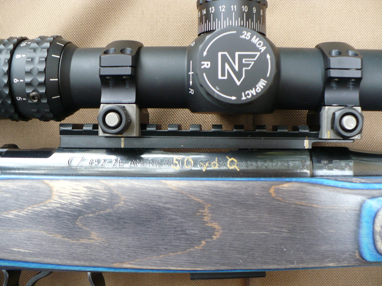

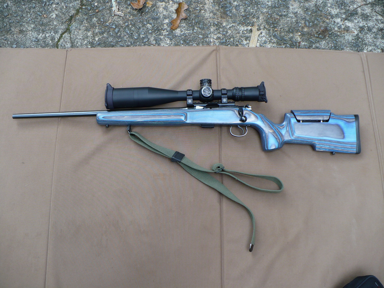

My setup is a 20MOA Murphy Precision rail with low Nightforce rings. I have 0.1" space between the barrel and my Aadland lens caps with a NF 3.5-15x50 scope. I'm very pleased with the result and would go that route again. It is very solid, no wiggle, just plain solid. The Murphy rail didn't even need the set screws when it was fully on.

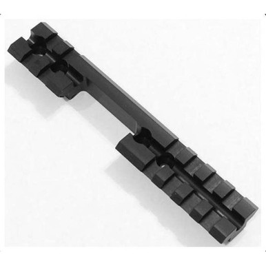

I have the one linked below. They also make a standard length and a 25 moa standard and extended.
i have this one also for my lefty cz452. really haven't shot it much but so far so good.

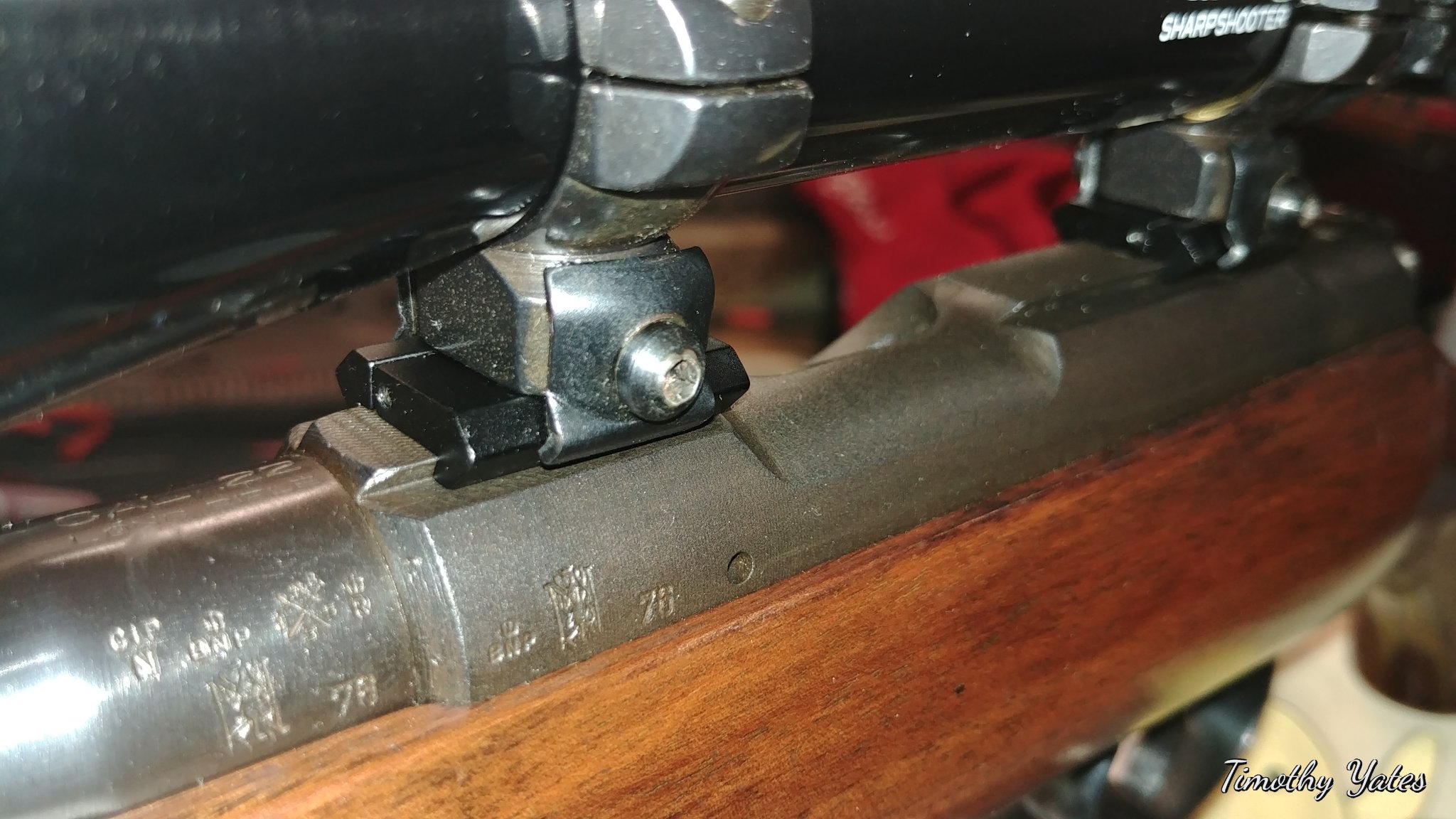

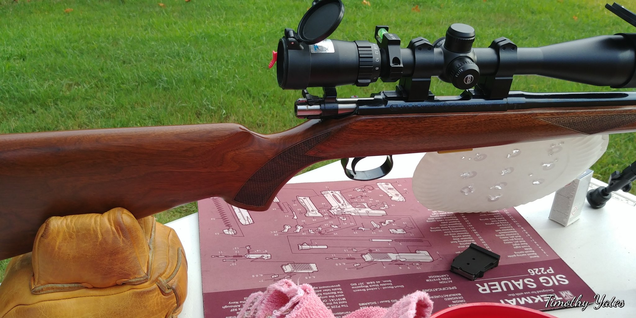

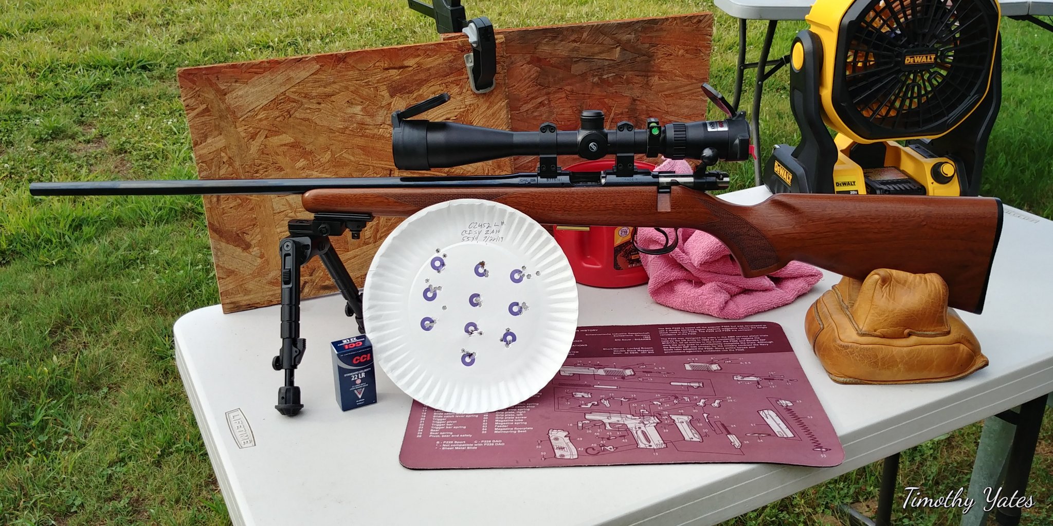

These $10 UTG adapters is all you need. They work great with the 3/8" dovetail or 11mm dovetail. Although not ideal they will even work with a round top receiver like the Anschutz or Kimber. They fit the flat tops like the CZ's have perfect. Here is mine with the exact same rifle you have. The scope has never moved.

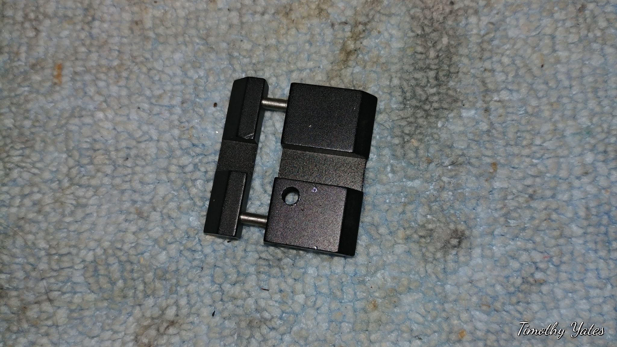

EDIT: Here are a few more photos showing the adapters so you can see how they work. They are spring loaded so when you tighten down the rings at the base it closes the two halves together. The hole in the middle is for a set screw if you want to use that. The adapter works with Picatinny and Weaver style rings.
This is what I’ve done. Mounted the scope last night & going to zero tomorrow. It’s a simple little converter but looks quite promising.
