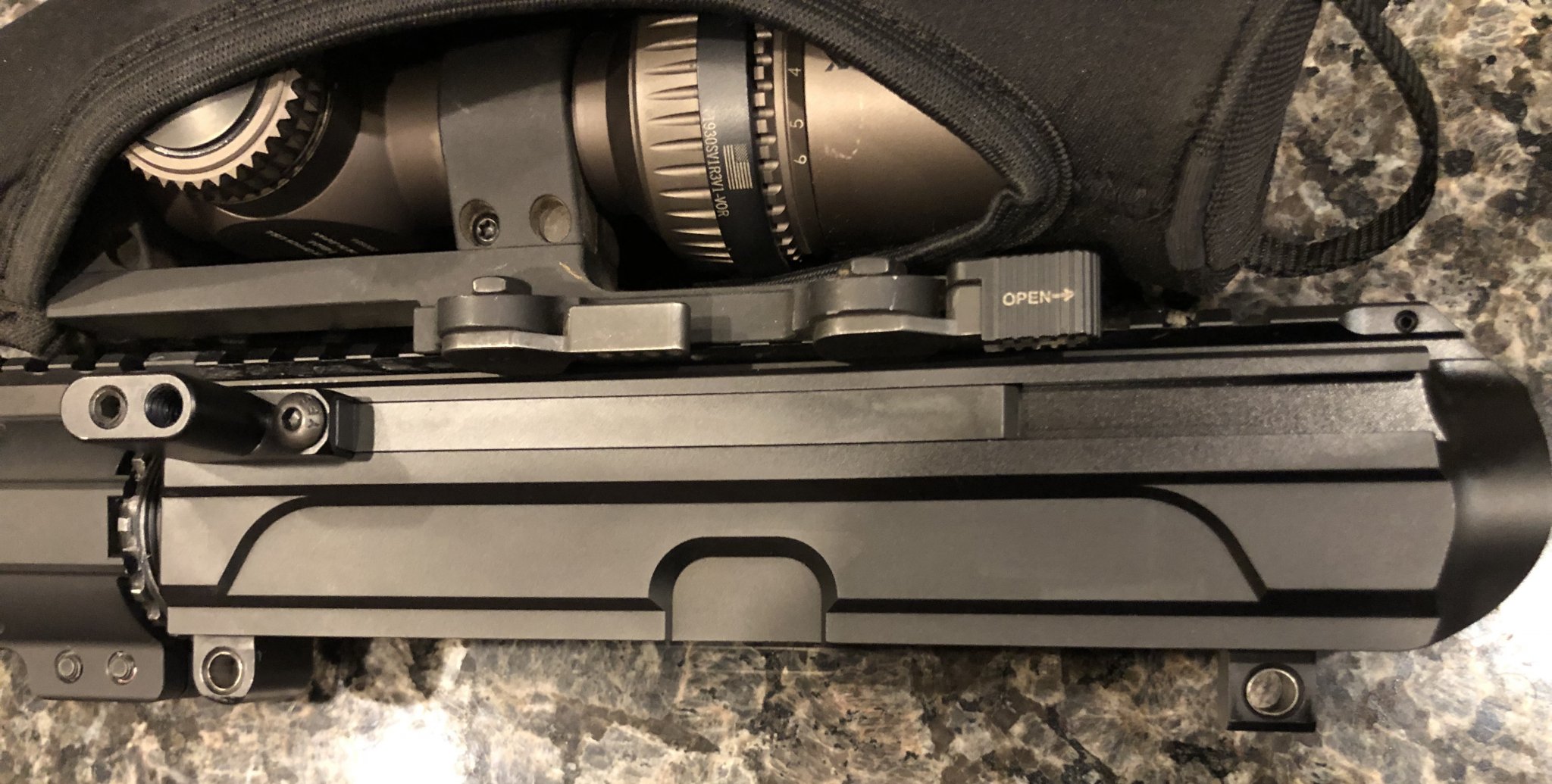

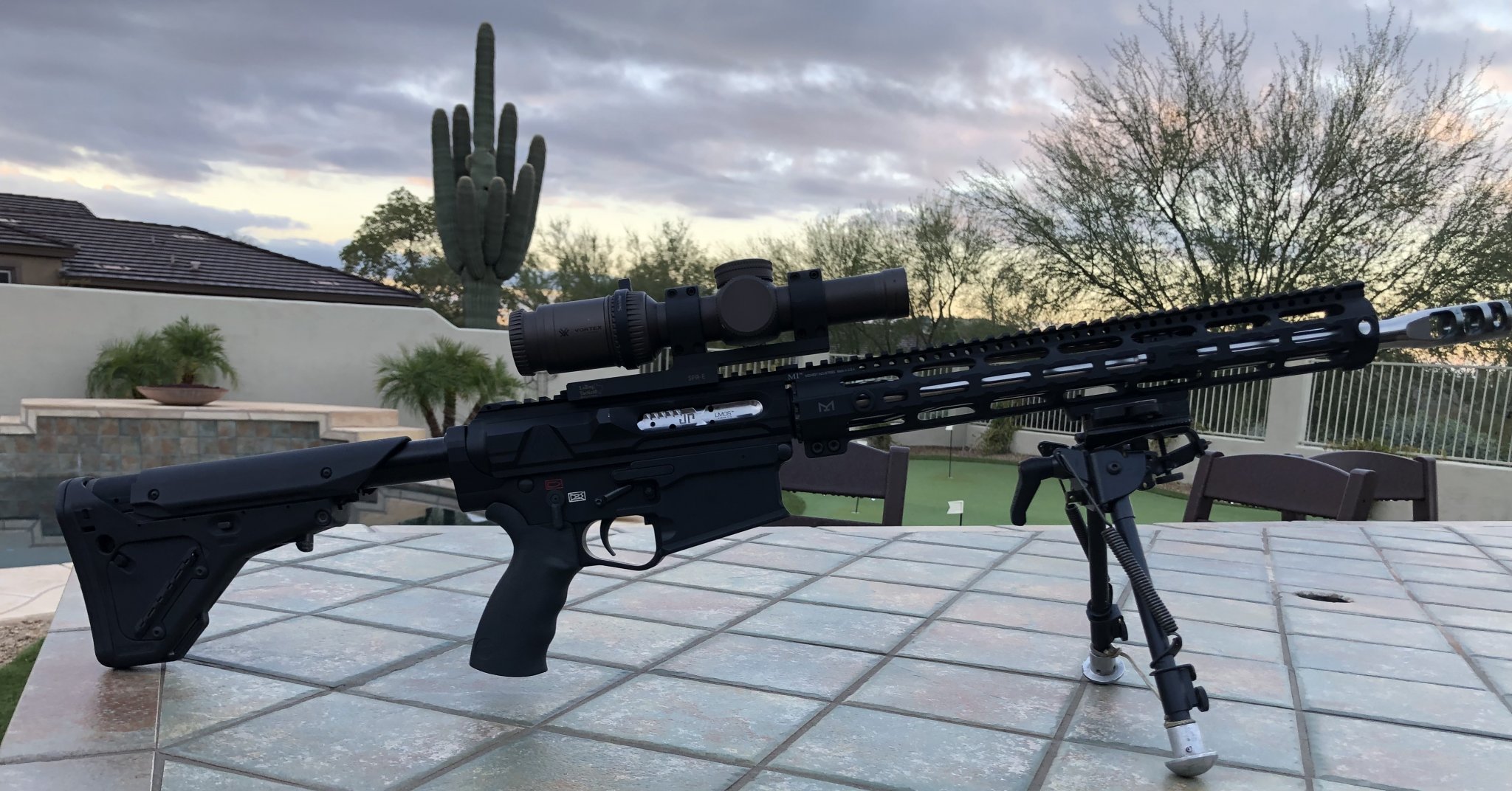

I actually just found a POF large frame in the back of my safe, (I keep forgetting its in there for like the last 10 years 😅). I am tempted to grow it in to another rifle, so I am going to piggyback on this post in case someone has a solution for converting pins.
Same here, won the lower at RM3G years ago..
Finally decided to take it down the street to Gibbz Arms and put one of their side-chargers on it. They just put harden bushings in it.
The contour at the buffer tube doesn’t quite match, but not a biggie in my world. It works & doubles as my beater HM 3Gun/truck gun. 882BE5EA-BC56-4707-9E6E-30E9EA0E86D8.jpegBDCF301B-2925-49D1-AE3A-B0B0C9B40C12.jpeg
