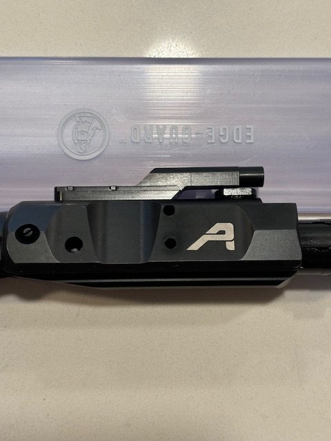

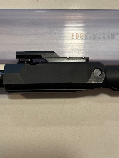

    Azimuth / Aero Precision Nitrided 308 / 7.62 BCG Single Ejector
    To Aero's credit they at least publish a comment concerning the size of the firing pin hole. "firing pin hole diameter is reduced to .070"
    TAPERED SD FP tip size... .068" .... Bolt face hole... .070"
    https://www.aeroprecisionusa.com/308-bcg-black-nitride
    https://www.aeroprecisionusa.com/catalog/product/view/id/536/s/308-bcg-black-nitride/category/201/

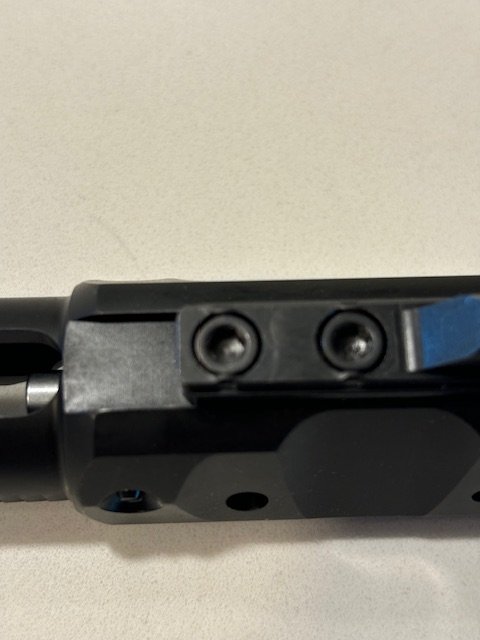

    Tell tale, rounded gas key ends of the Azimuth 308 BCG..
    Slab Side of the Azimuth / Aero nitride 308 BCG...

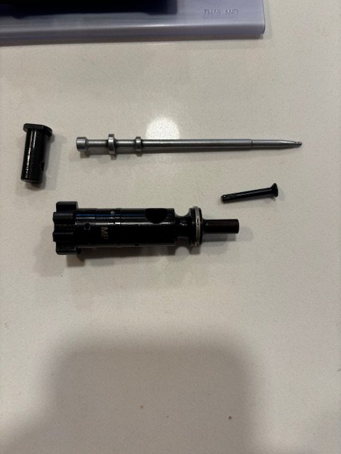

    Recently bought Headspaced to barrel bolt and FP to a Craddock Precision RTR 308 Barrel...
    Tapered SD FP tip size... .067" , Bolt face FP hole size... .071"
    Craddock Precision says... ( via e-mail ) "We get all of our Bolts/BCGS/Firing Pins from Azimuth"
    Now... since I have seen the Tapered SD FP in many other BCG's, I really don't know if Azimuth makes them.

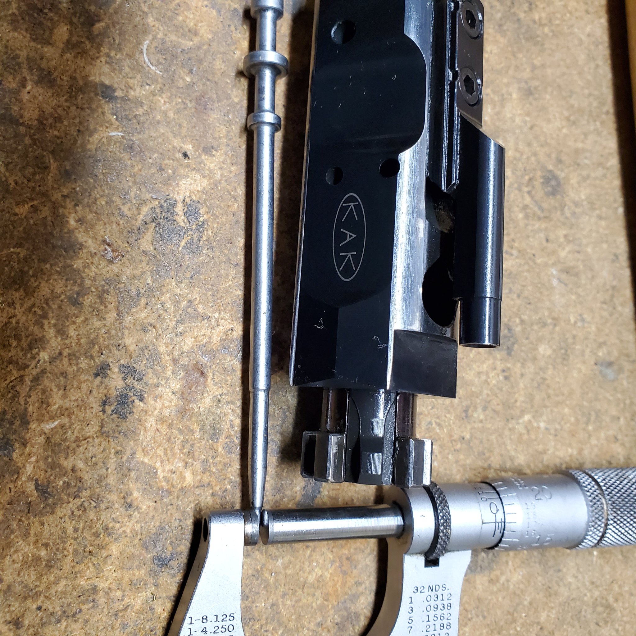

    I use Toolcraft with high pressure bolts on most every AR 10...
    Except a few, the 338 RCM with a KAK magnum bolt has a .067" firing pin.
    I use full pressure manual 338 RCM maximum loads on this bolt, in AR 10.
    Same with the 308 or 6.5 CM.

    @45-90 ... you mentioned the KAK Magnum bolt and its SD FP tip, do you remember if the FP is the Tapered style ?
    On a side note... why does the tapered FP style exist for DPMS bolts ?
    I understand that various manufacturers have used them from day one ( ? ) LMT, KAC, Armalite.
    Are they "stronger / stiffer / more durable " over long time use ?
    Do they interchange freely ( provided the tip size fits ) with straight style FP's ? Both ways ? IE you can safely use a straight pin in a bolt that came with a tapered FP and vice versa ?
    I am not suggesting anyone do that , for obvious reasons (stay with the OEM type FP it came with ), but are all 308 bolts made the same in the bolts firing pin channel ?
    Maybe better said, the bolts aren't "drilled" specific to the style of FP used ?
    My pin gauge set isn't long enough to useful for checking.
    I haven't checked all the various ones I have, via swapping around parts.. but maybe someone already knows.
    I really want a FP tip protrusion measuring tool. Lol
    So here is a picture for your scrap book of the KAK magnum FP and its tapered profile and .067" dia.
    Reactions: bfoosh006
    The KAK LR_308 / Magnum HP FP's came back in stock.
    They are indeed, Tapered with a SD Tip.... 2ea .068",.. 1ea .069" ( so the same as the PSA Toolcraft 6.5CM Dual ejector BCG )
    https://kakindustry.com/magnum-high-pressure-bcg-firing-pin
    PLEASE Note the picture in the link above... does not show the proper TAPERED ones I received. I am going to ask KAK to show the correct Tapered FP in their Link.
    Also my back ordered Wilson Combat S-7 Steel FP's arrived.... NON-Tapered.. 1ea .075"... 1ea .0745"
    https://wilsoncombat.com/firing-pin-ar-10-mil-spec-bullet-proof-s-7-tool-steel-hard-chrome.html
