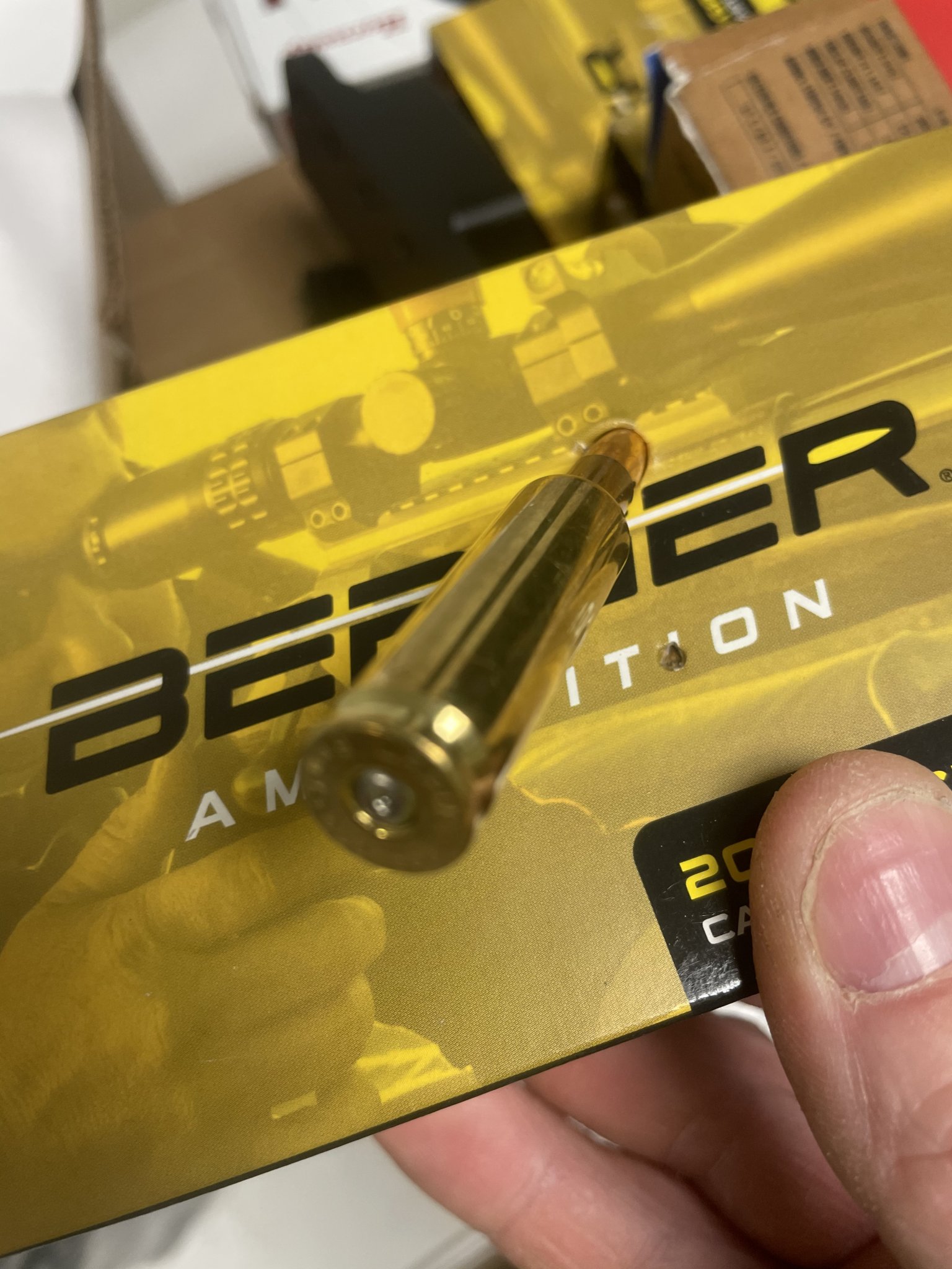

Do you know how primers are made?
Do you know the companies in the USA who make primers?
Might want to look into those two questions and consider revising your gratuitous swipe at Berger QC.
Lol
Happened in the first 200 rounds of berger 6 cm.
Hasn’t happened in 10000 rounds of hornady 308/6.5 cm/ 6cm. Not to mention thousands upon thousands of hornady and black hills .223
Lol
Which is an utterly complete non-answer.
"in the U.S., only four domestic manufacturers produce primers: Federal, CCI, Remington and Winchester."
Note who is not on that list....ah, Berger...oh, and Hornady. Oh my. :unsure:
Now, as you can see, Berger doesn't make its own primers...and neither does Hornady. And, it should be clear that while there is a process for making primers, they are certainly not given individual attention during manufacturing...hell, they aren't even individually inspected.
So do you still think your FTF of one primer in a Berger cartridge has absolutely any significance at all. Of course, please feel free to continue to gratuitously throw Berger under the bus out of ignorance.
Lay on, McDuff.
You should have asked him if it was their policy to load 223 Remington ammunition to a chamber pressure of 78,369 PSI.
Yeah that is what I should have said to that guy. Mr Bob has been a lot nicer at least, that dude was kind of a jerk and after your ammo nearly blew my gun up, and did blow another gun up, AND having said ammo for 4 months and still not swapping it out, you'd think the guy would be a little bit nicer in general. Glad Mr Bob was the main guy I've dealt with and I appreciate the exchange of 6cm ammo which is much more expensive ammo, but the way Berger has gone about this whole thing generally leaves a lot to be desired imo
Reactions: bfoosh006

I think he was referring to the pic with the primer struck that didn't go off, which looks like a 6cm or 6.5cm round instead of the 223 round this thread is about.
Post 295 was about the Berger 6 or 6.5 Creed ammo that BurtG commented on.
