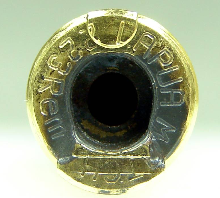

Shouldn’t the letters in the bolt face be mirror images?
FIFY
Reactions: naturerancher
