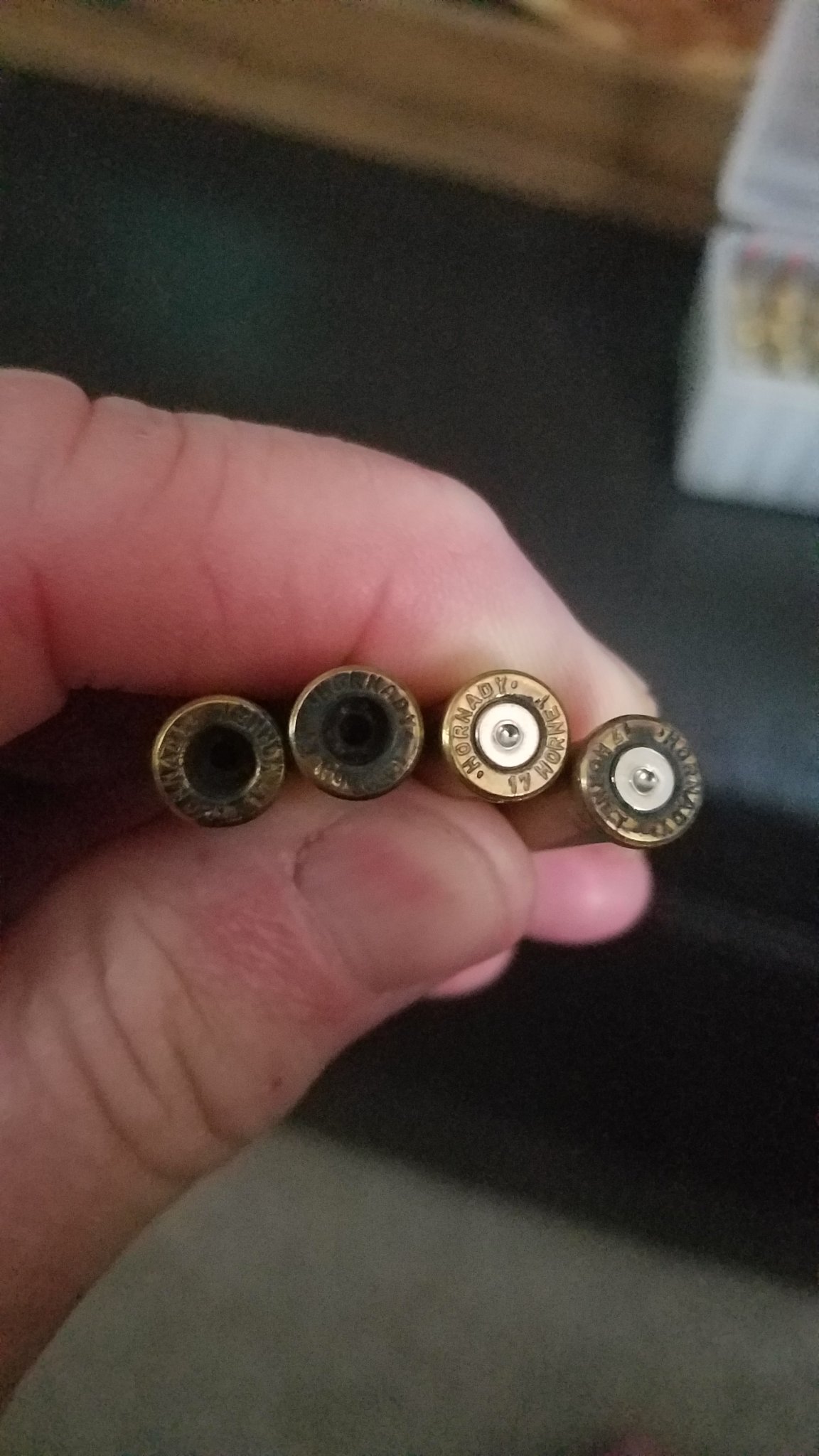

Let me give you a personal example:
Loading 17 Hornet with a 20 gr V- Max, WSR and AA-1680.
Known safe load.
I resize my brass, add the primer, charge with powder and grab a box of bullets.
Load them up and hit the range the next day.
The bullets are shooting great, but impacting about an inch higher than they should.
Hmmm...
The third round of the second group I feel a little puff on my face. Rifle is a CZ 527.
I eject the cartridge and notice a little primer leakage. Not normal, but I figured I might have had a bad piece of brass.
I proceed to shoot a couple more groups without incident (or so I thought).
When I picked up the brass 3 or 4 had completely blown primers to the point they fell out.
I was done for the day.
The 17 HH is designed to operate at 50ksi.
We'll come back to this in a bit.
The 223 is listed at 55ksi and 5.56 is 58ksi.
CIP lists both at 62ksi.
Either way, even if the cartridge had been a 5.56 loaded to 58ksi (SAAMI) and fired in a 223 chamber, it would most likely not exceed 65-68ksi.
To do the damage it did to that piece of brass, it had to exceed 75-80ksi to even come close to that.
Most likely, the pressure exceeded 80ksi.
In my above example in the 17 Hornet, the cause was easy to diagnose.
I simply grabbed the wrong box of bullets that should not have been in that stack.
Instead of loading 20gr bullets, I loaded 25gr bullets.
Okay, 5 grains, so what?
In a 223, 5 grains will get you some primer flattening and not much else. Really, it's less than a 10% weight increase. Not good, but not dangerous.

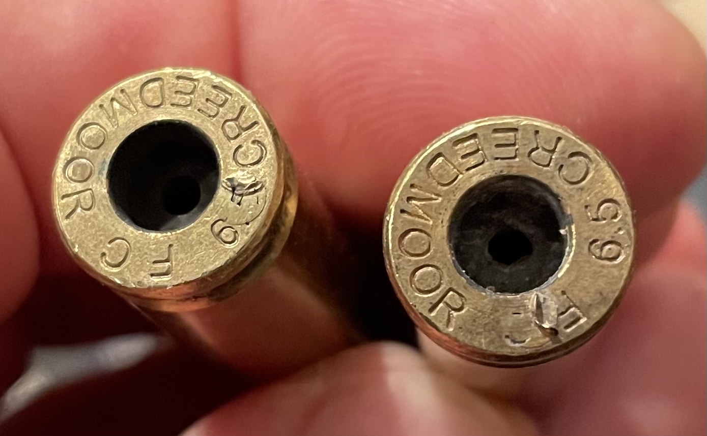

Kinda having a similar situation as Molon. I’m a LOT less experienced than most of you guys, but maybe there is an ammo issue.
Brand new FN 20S in 6.5CM. It’s already back at FN for service after I saw this. Noticed this after less than 25 rounds fired. Pretty ugly.
View attachment 7672386View attachment 7672387

See my earlier post in this thread about Berger ammo, and Federal ammo loaded with Berger bullets.
Yes, Sir. Your post is why I put up those pics. Just wanted to provide an unfortunately context-light but still (as far as I can tell) relevant data point that may point to the pattern you mentioned
Not even close
🙄 Thanks, Sherlock. I didn't post to one-up the severity of Molon's experience. Just wanted to add another point of reference.

and lastly, it’s now summer and hot, possible the box of ammo was sitting in the sun/trunk of a car before it went through the rifle? Do a bunch of shooting and let the runs sit in the chamber a while?
I have read all these posts and was looking for someone to mention this. Lots of great material here and valid observations but this would have been one of the 1st things I'd check if it happened to me. Based on what I'm reading about Molon's experience and equipment I'm guessing checking CTBO has already been done for all remaining ammunition. If any are found to have been loaded long or grew because of being a compressed load that is definitely something I would want to let Berger know about.
Sorry..... CBTO*
If it’s supposed to be a compressed load than it’s hard to imagine it’s an overcharge as there isn’t the case capacity left to have big overcharge.
I think it was most likely the combination of serveral things that caused the perfect storm.
Already warm load with maybe slight overcharge, Bullet pushed forward giving a longer CBTO, short 223 rem throat meant the bullet was jammed into the lands, hot day rounds got warm in the sun, and we have a recipe that compound and can cause problems.
I think it has be something more drastic. The amount of over pressure needed to cause that is significant. I would lean more towards the wrong powder. If they are supposed to be using N150 and used N140, that would probably do it. Very interesting information though.

If you have the ammo and won't be shooting it, it might be worthwhile to weigh the individual rounds to see if anything comes in a few grains above average and pull/weigh that charge. Otherwise, poor gun! That looks crazy hot. If this was my 24.3 AA2520/85 RDF load, I'd expect to see this pressure somewhere around 26+ grain charge.
