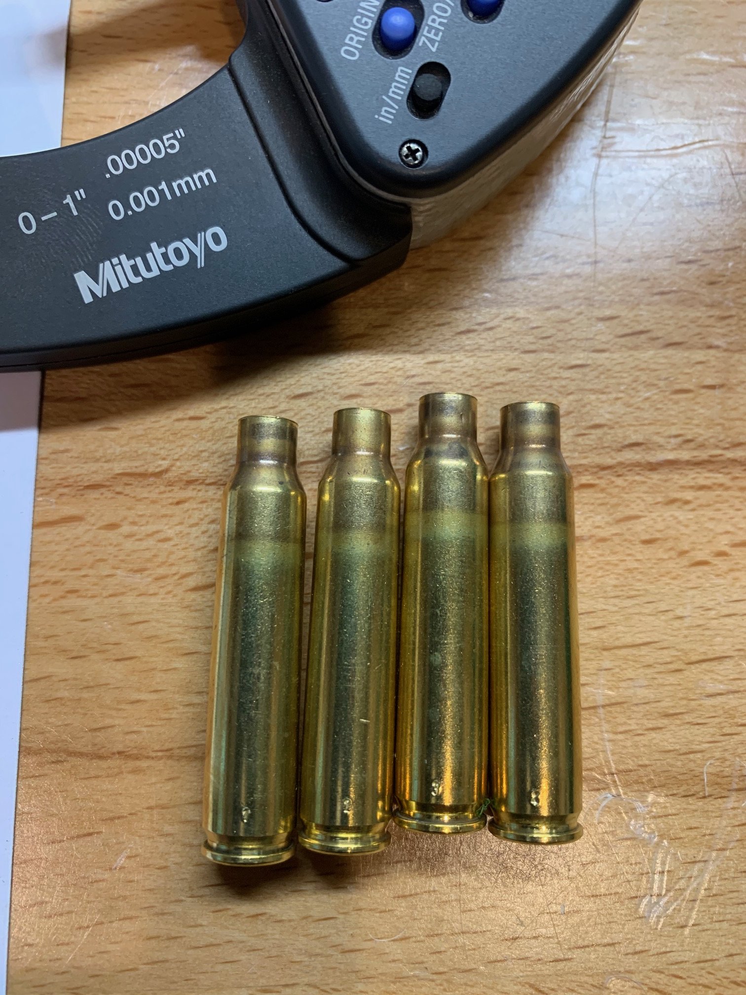

Since I'm about to tumble 223 brass I'll mark & weigh a few before and after carbon removal. Doubt it's even 1 full gr for carbon.

I am intrested to see this but figure carbon is about 0.1 kinda like a piece of wood burnt to ash.
And the over pressure case was the heaviest of all weighed. Probably missing some brass in the flash hole area as well.
