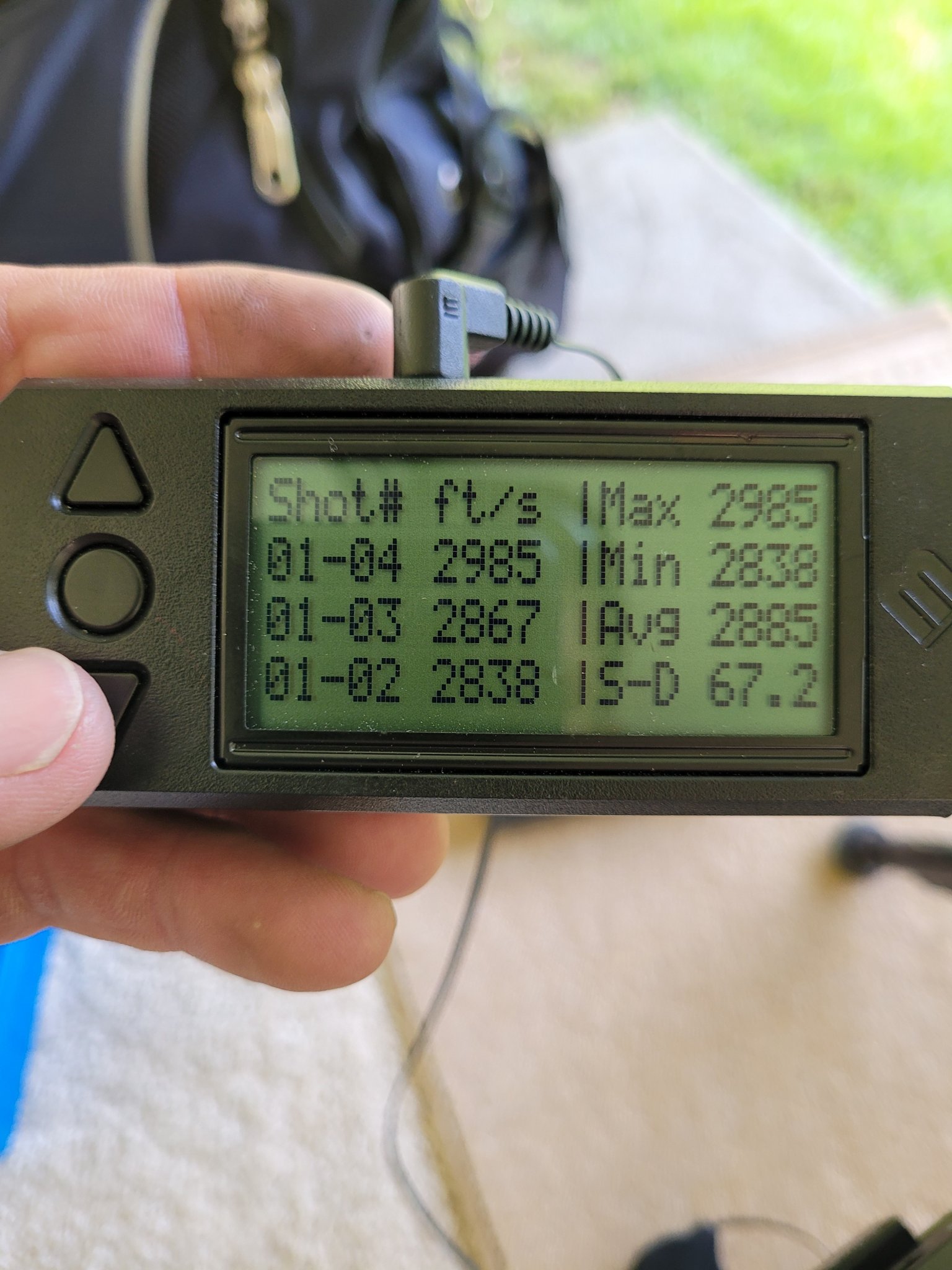

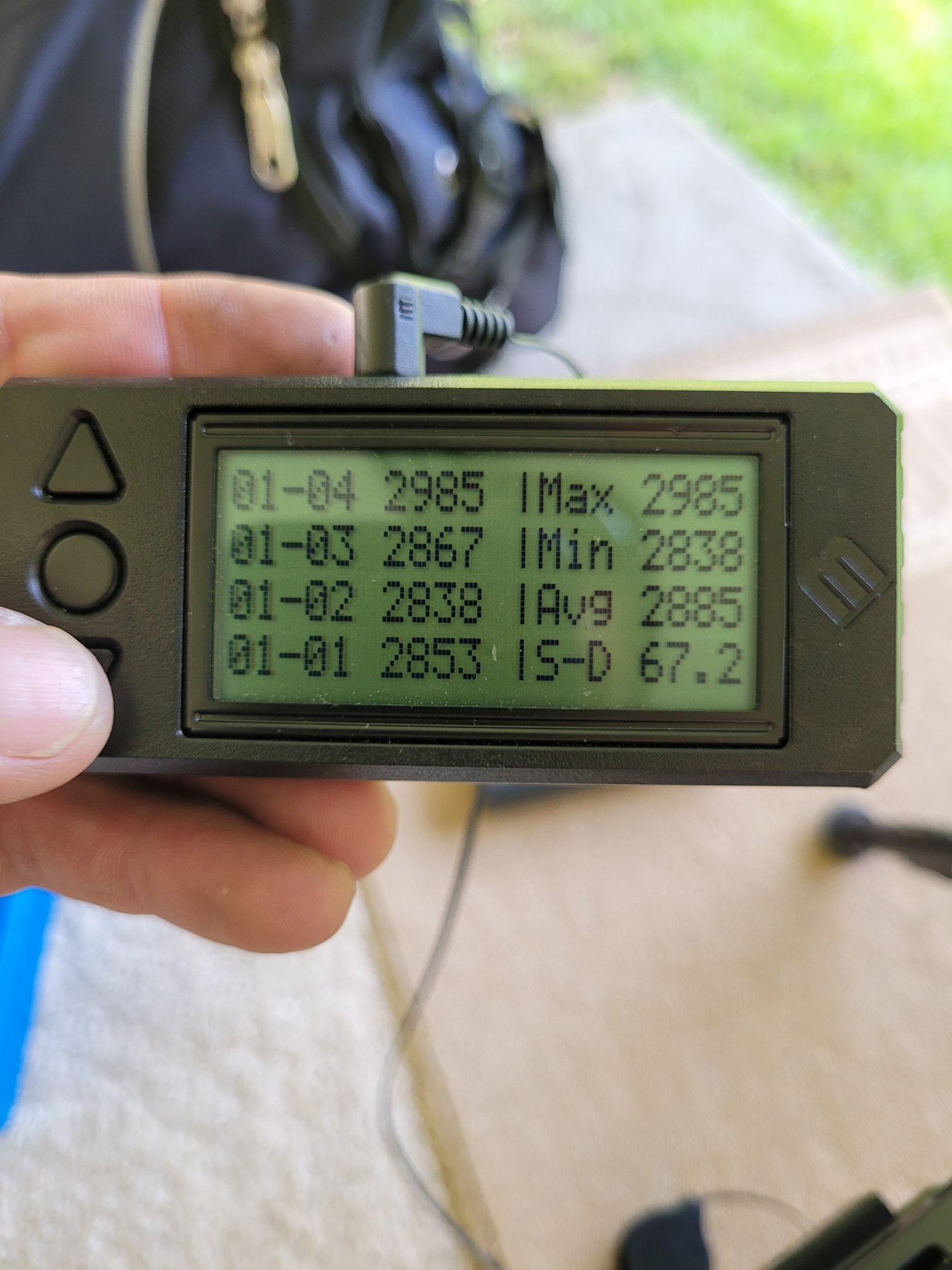

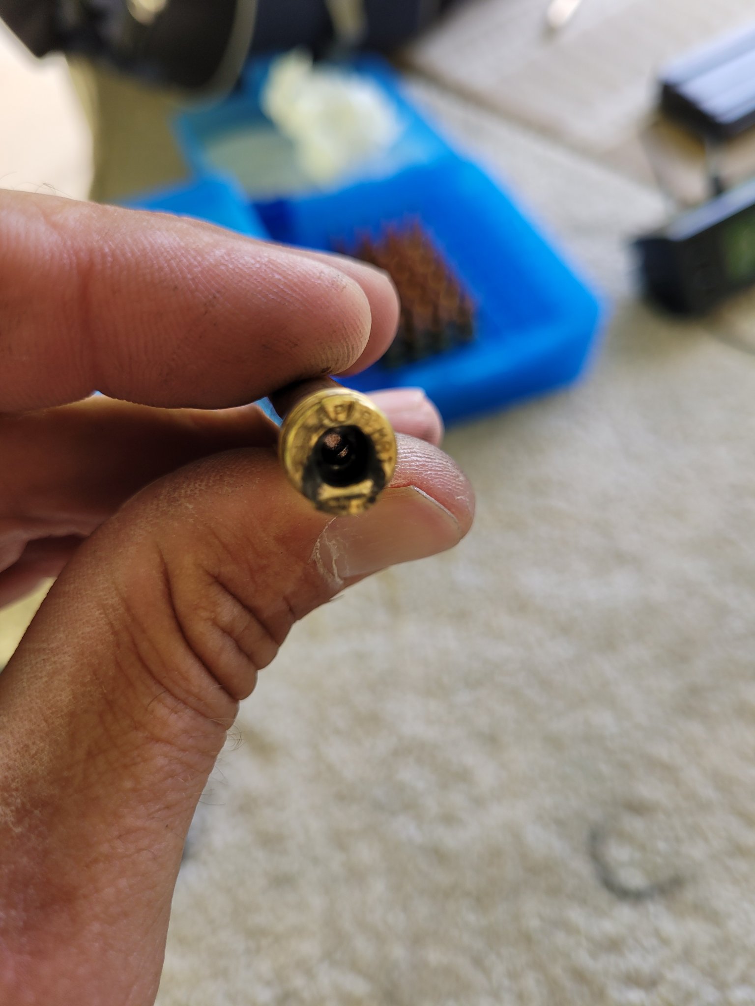

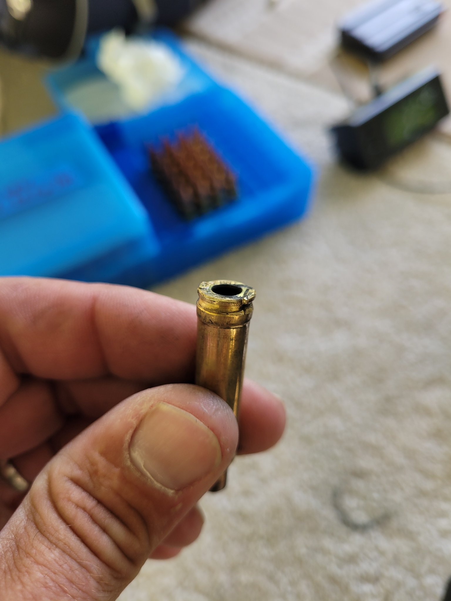

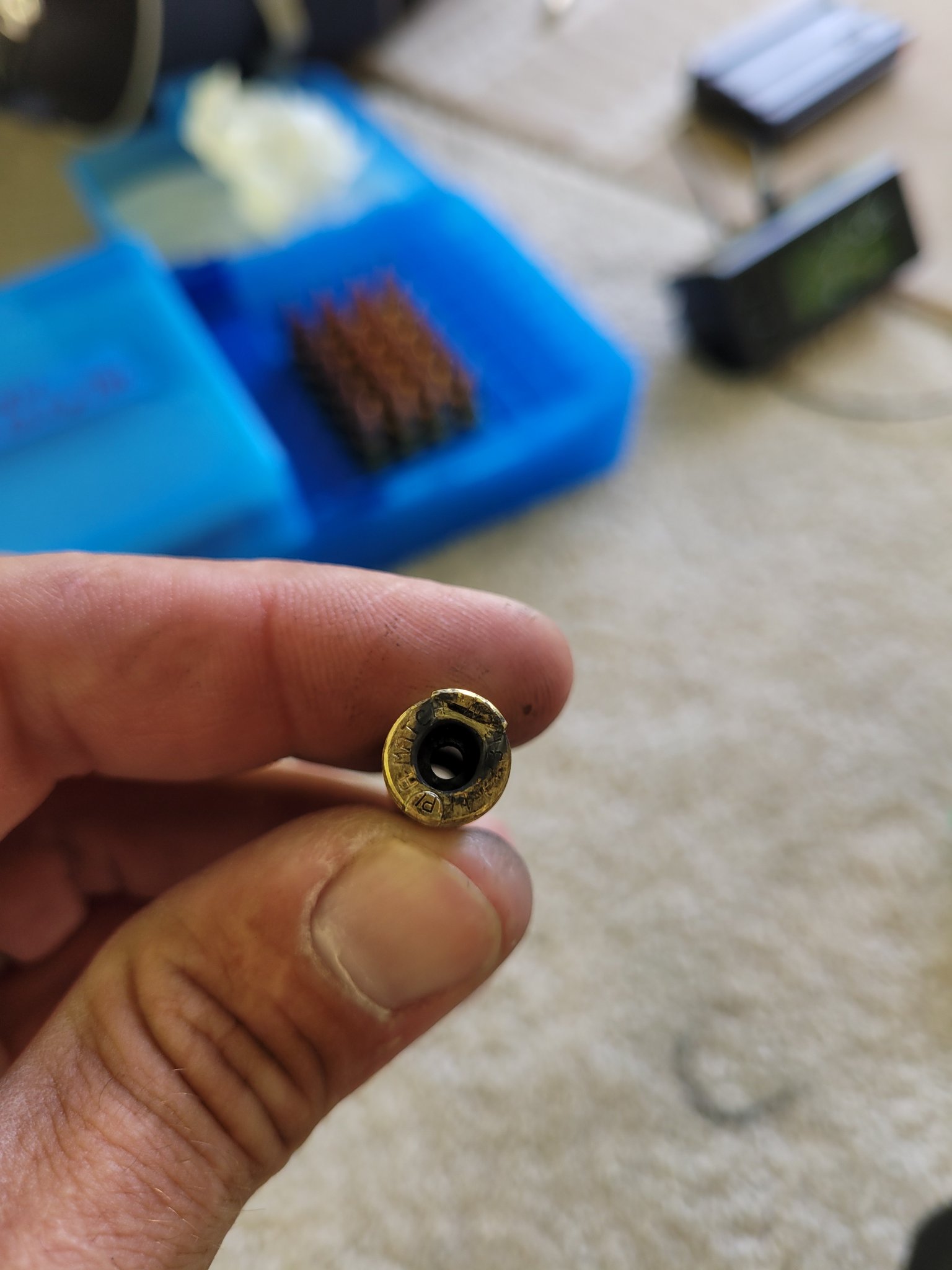

I am at the range and doing seating depth test on a CLE -AR223. I wasn't as sighted in with the 75gr bullet I was shooting as I thought, and my few sighters I loaded weren't enough. The only other ammo I had was the Berger otm (which shoots lights out in my bolt gun), so I decided to use a few rounds to dial in before starting the seating depth test.
I had my crono on and you can see the speed. This is what happened on the 3rd shot with that ammo. I have shot my handloads, (MV of 2907) which run faster and are 2 gr lighter bullet without any pressure signs. I did a pressure check last week and went with 24.2 gr of TAC. Not sure what's in these Berger but I obviously didn't shoot anymore of that and will be calling them to swap out all of this ammo.
Glad you're not hurt. What length is your barrel?
I don't really understand why that happened given the velocity. (Edit to clear this up.. i meant "given the velocity of the first round if it that i shot) .Happy to measure anything you'd like to maybe shed more light on it.
I did not think it was possible to over/under charge a cartridge using modern commercial loading equipment.

My barrel is 18" and I had my 8-1/2" can on it with a qd break.
2985 FPS from an 18" barrel! Two Thousand Nine Hundred Eighty-Five Feet Per Second.
That's 137 FPS faster than Black Hills 5.56mm MK262 Mod 1 when fired from a 20" Colt barrel with a 5.56mm chamber. Berger clearly labeled this ammunition as "223 Remington" "Match Grade Ammunition"
The Berger box lists this ammunition as having having a muzzle velocity of 2750 FPS fired from a 20" barrel. So that
2985 FPS is 235 FPS FASTER THAN BERGER'S OWN STATED VELOCITY.

Yeah that's pretty fast from an 18" barrel, I did have the can on it but that's right at the speed I get out ofbmy bolt gun and it's another 4" longer and has the same suppressor on it. I'm kind of used to 3000fps but I'm also used to my bolt gun. My load that I determined to be safe pressure was 24.2 (TAC) which is a grain under what I shoot in my bolt gun. That's a different bullet as well. 75 gr vs 77gr. But the MV for my hand loads are right at 2900 with that same barrel. That's my highest speed avg with very hot temp btw.
So @Molon , you think its just a ton of powder in some of these then correct? That's the cause and only cause of this very high pressure and the resulting superspeed. I did re-read your findings that you posted and had forgotten the amount of powder you were talking about being in some of these. It's just hard to imagine that big of a powder difference in match factory ammo??? I of course think you are right, just don't understand how that would happen in a production of ammo...

I can't really wrap my head around them calling this 223 ammo when it's clearly loaded to mimic MK262.
All the 223 77 OTM match I've checked speeds on are at least 150fps slower than the Berger.
Speed = pressure. There is no way they're getting MK262 speed with 223 pressure.
2985 FPS from an 18" barrel is 137 FPS faster than Black Hills 5.56mm MK262 Mod 1 when fired from a 20" Colt barrel with a 5.56mm chamber. Berger clearly labeled this ammunition as "223 Remington" "Match Grade Ammunition"
The Berger box lists this ammunition as having having a muzzle velocity of 2750 FPS fired from a 20" barrel. So that 2985 FPS is 235 FPS FASTER THAN BERGER'S OWN STATED VELOCITY.
Reactions: bunsen27
Agreed 2985 is crazy. Even 2750 seems impossible for true 223 Rem pressure.
