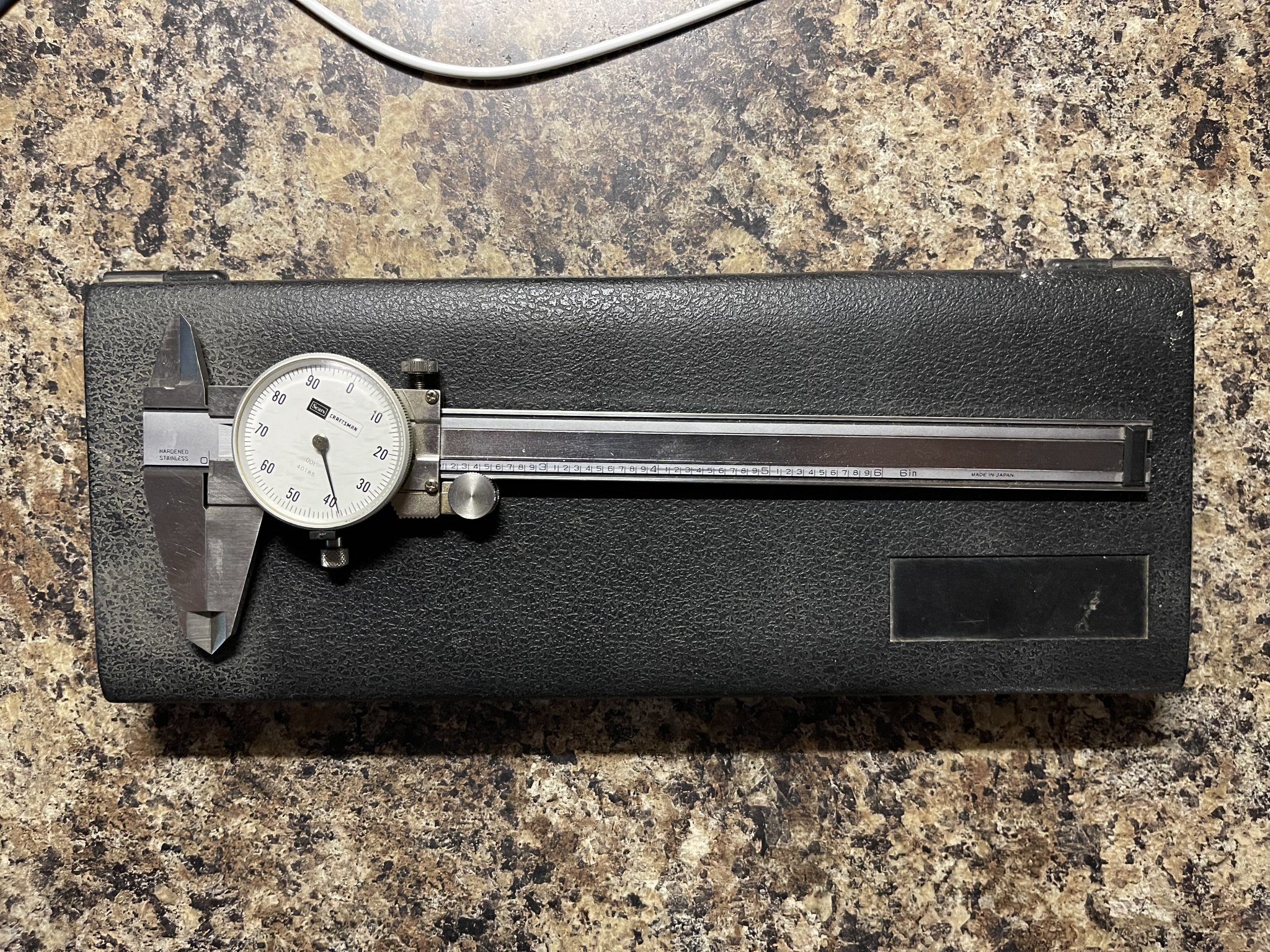

I have a Craftsman dial caliper that my dad gave me that “lost zero”. These are stainless construction and are made in Japan.
The dial won’t reset to the 12 position, and every time I open and close it stops at different readings within .004
Can this be repaired? Thank you

There are calibration shops that can do this and get it back to where it needs to be if something inside isn’t jacked up and parts can’t be found. It can be as expensive as buying a new mid-quality unit. What’s good about using a calibration/repair shop is that those calipers will come back tested and certified.

Loosen the screw at the end of the pointer and turn the dial until the zero lines up. Tighten it up.
Check them and see if they return to zero. If so, keep using them.
He can try that but if it is closing to within 0.004" to either side of zero there is probably either an obstruction inside of it, a gear going bad, or some other mechanical issue I would be willing to bet. Dropping them is usually the culprit when one of my guys come to me with them like this. Of course, no one knows how it happened. I'm usually a fan of just sending it out for repair, inspection and re-certification so that I have a fairly high degree of trust in the equipment. But I make my money off of equipment like this so I may be over the top for the intended use he has for these. Still, with calipers being +/-0.002" accuracy to begin with he could be 0.006" off on a measurement in either direction at any given time, and that is a lot, Could be more if incorrect force is applied while measuring. It is also noteworthy that just because it does return to zero that does not mean that they are accurate along the entire measuring distance, which is more common that most think. They really need to be given a good cleaning and inspection just to be sure.

Usually this happens when a dial caliper has been dropped, or gotten some grit up inside. In a shop environment, it seems to happen to all of them eventually, quality built or not.

To reset the position that the needle comes to at zero, dial calipers used to come with a small piece of shim stock that you put into the gear train to "slip" the gear positions. It's a real PIA to get right. If it's not going to the same exact position for zero, that's another issue. I learned early on that whenever you are using dial calipers, you always keep them CLOSED to prevent any chips or grit from getting into the gears.

There is a thin brass tool available for jumping the gear on the rack, works pretty good. You can send them in to companies who repair calipers and other measuring tools & dial indicators etc. But it may be more expensive to send them in than buy new. Get a coolent proof Mitutoyo and ya won't have that problem. I still have a few old dial calipers, but have changed to digital many years ago, they are more versatile and stand up to adverse conditions better.
