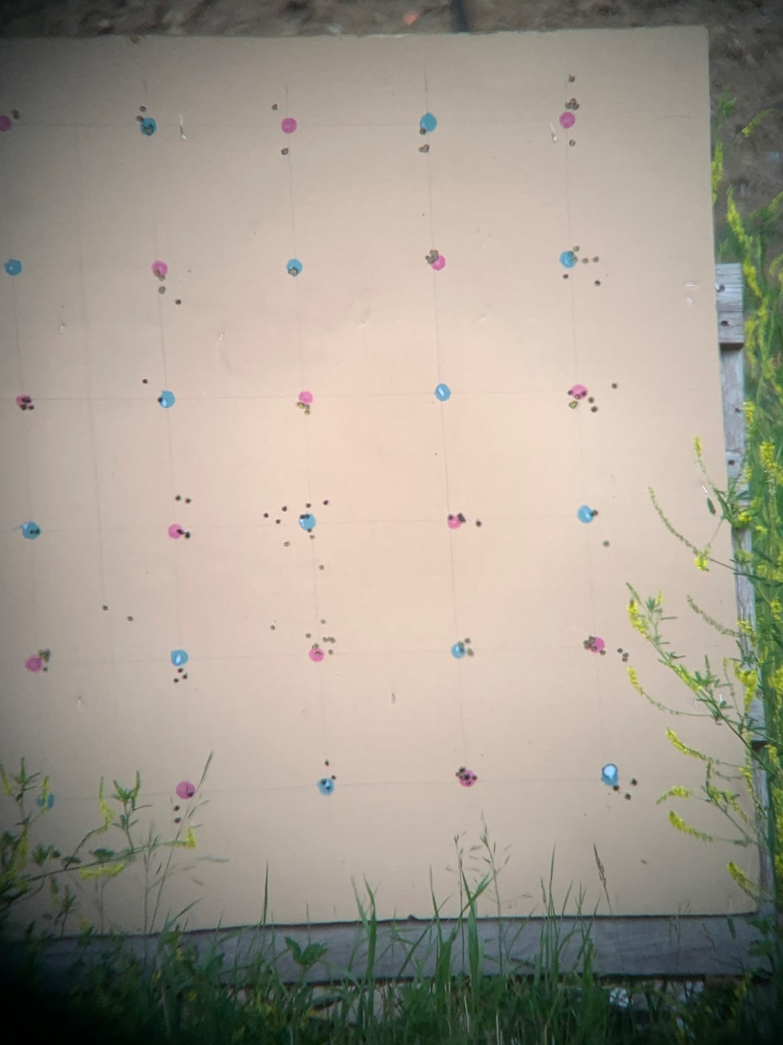

@wind gypsy got a picture of the zero board from a 1 day club level PRS match he attended this year which I'll show below. Seems to be a mixed bag, though I'm sure some guys show up with new loads they're trying out. But not ALL of them.
If the zero range was removed from PRS matches do you think competitors might change anything? Can't check zero before or during the match, it has to be on and stay on.
