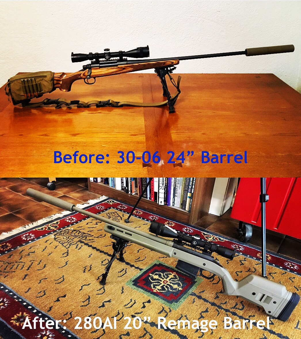

I went through this with my 24” 30-06 hunting rifle and my Ultra 9 can. It was getting close to new barrel time and I wanted to shorten the package for hunting. So I went to a 20” 280 AI Criterion remage barrel to make up the loss of ballistics from 24 to 20”. Which I did. I also use the loss in weight to go to a heavier/ stiffer barrel. I was able to use the same weight 168 VLD-Hunting Berger bullet which had a higher BC in 7 mm over the 30 cal. I took a Wyoming antelope at 638 yrds this past season with it. I am very protective of my hearing and this is more than comfortable for hunting. On the range with berms , building and canyon walls around, I use ear pro. I recently upgraded from a Harris to a TBAC Bipod. LOVE that pod!
