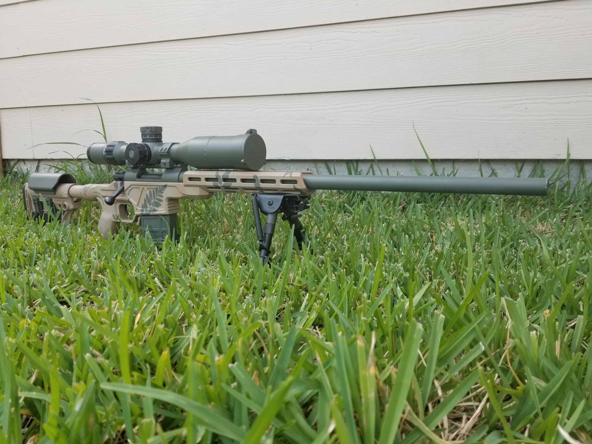

    I've always wondered about scopes mounted within 2mm of the barrel.
    Slow motion video of high speed cameras show how much the scopes bend/oscillate under recoil.
    Scope slap?
    I’ve seen a few people dent their objectives from barrel whip, usually on rifles like the one above where they’re really proud of how close it is to the barrel.
    More of an issue on larger calibers / magnums, probably would be fine on 223 or 6 / 6.5CM.

    THis is a big 50 but its very illustrative
    That's pretty fucking awesome that they were able to capture this on video, thanks for posting. I've always thought if anything was going to flex under recoil it would be a mount and not rings as I find rings to be a more sturdy or rigid but that's just my thinking and nothing to back this up with. In the video though, we can see the rail where the mount is on being the one that flexes the most and comes up from the back.
    Idk though, I don't mean any disrespect and I'm not trying to argue with you spife, but unless someone shows me proof of this happening on a 6.5 creedmoor like mine, I have a hard time believing that I will encounter problems because of my objective making contact with my rifle under recoil.
    I’m not an engineer, but I don’t see how that video is in any way illustrative of 99.9% of scope/base/rail setups. The scope and base are on a long cantilevered rail in the video. If the rail were firmly affixed to a receiver underneath, there’s no way it would move like that.
