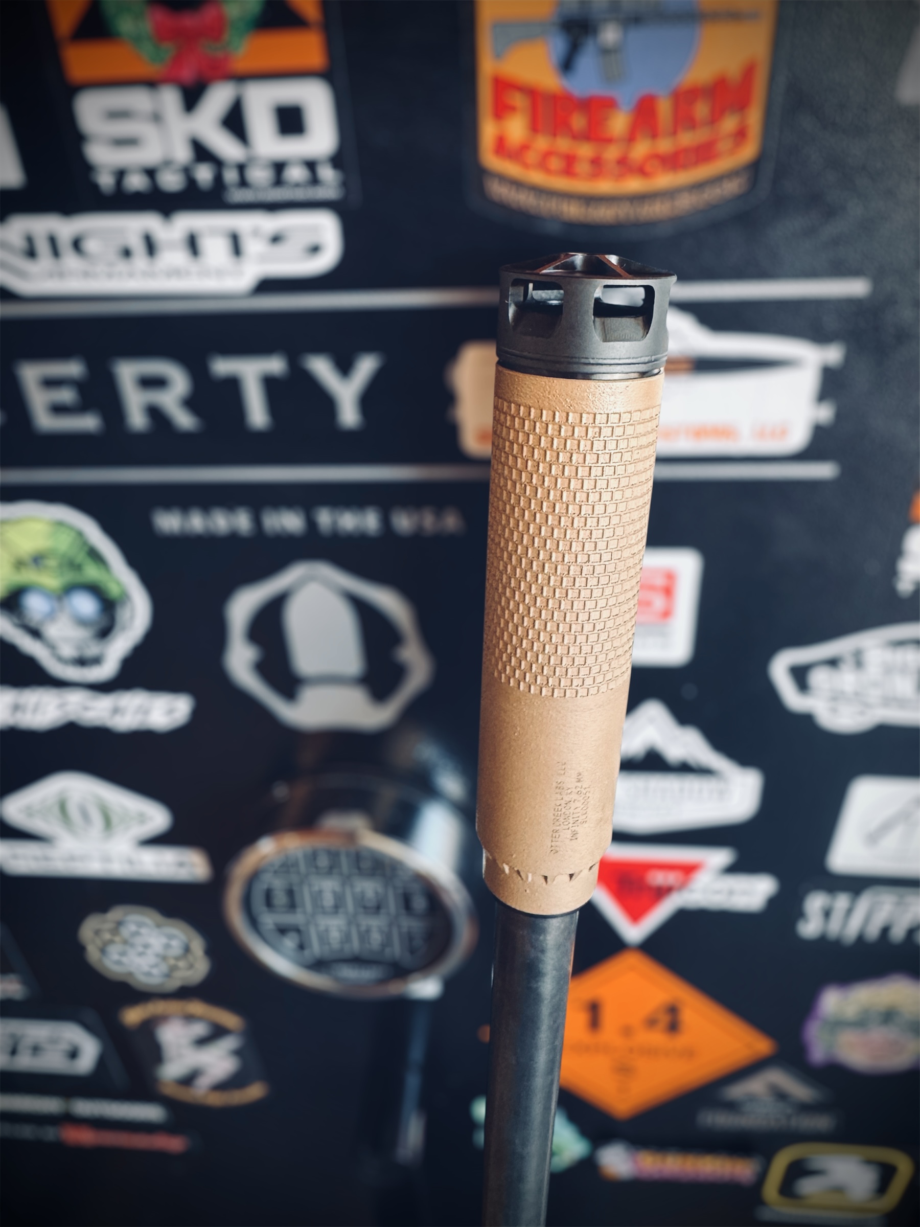

No experience with the Velos, but I have the B&T SRBS 762 Inconel. I’ve only ran it on a piston AR10 in 308 (REPR MK II) The B&T comes with a direct thread adapter, but it is hub compatible as well. I’m running a hub adapter on mine with a Liberty precision brake. I’ve put about 100rds through it at distances between 300-600yds and it’s performed great. I have no issue stringing together 6” groups at 600yds with it and I’m by no means a good shooter. I also have the SRBS 556 version and it’s performed good as well.

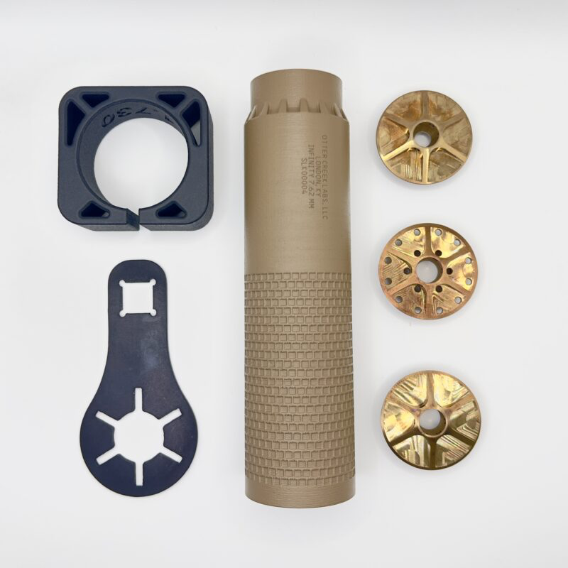

Otter Creek Labs Infinity 7.62 - It has 3 different end caps that come in the box to adjust the back pressure and flow rate based on what host you want to use it on.
Id also second this. I use mine for PRS and love it. Shot a buddy’s on a Saturday for entire match and by the following Friday I had one bought and in the state, 3 days later I had it in hand.
The vented end cap works really well to remove that “push” feeling in recoil impulse.
Rearden DTA keeps oal down and has yet to walk loose on me. Add a Liberty MBEC and it feels just like a brake without the noise as a traditional brake.
