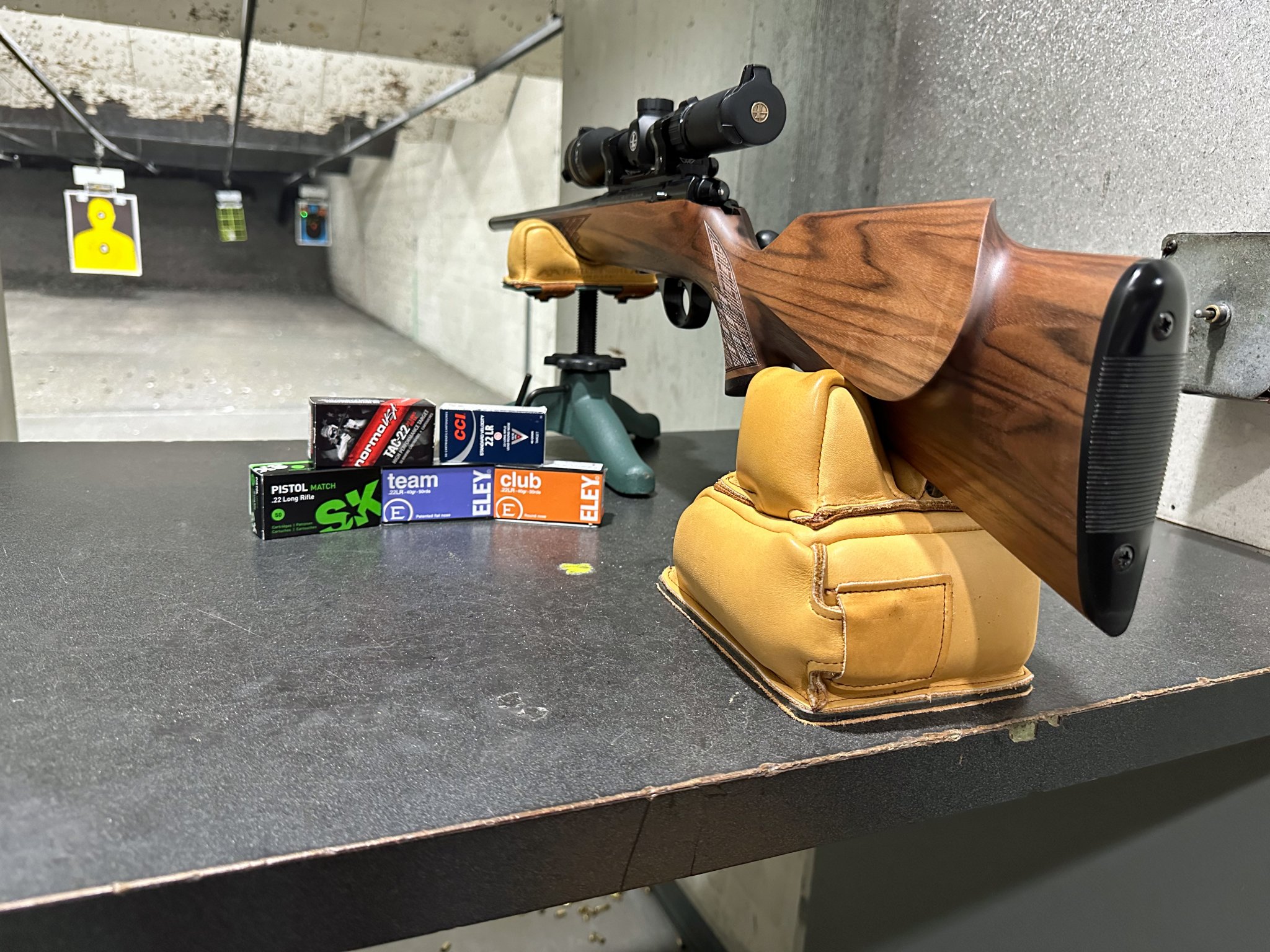

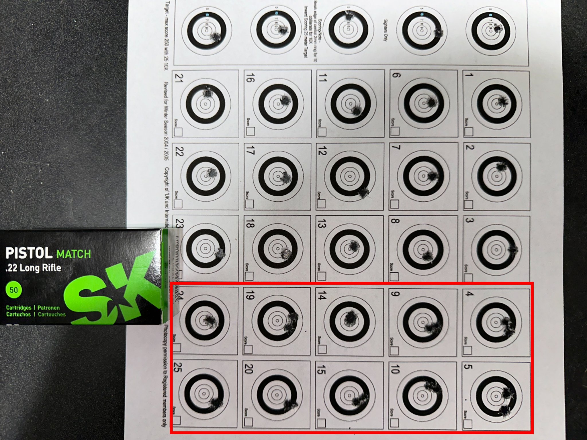

    Took my Anschutz 1712AV to the indoor range today, was having some fun shooting some different ammo at printed paper targets; Eley Club & Team, Norma TAC-22 and some SK Pistol Match. The Pistol Match had me really thinking this rifle really doesn't like that ammo. Since I had another 10 rounds of that box left over after running through all of the targets on the sheet I decided to shoot the bottom two rows again (red rectangle around those rows) and see how much of a shotgun pattern it would print. Well, this just doesn't make any sense, it shot nearly the same holes for 8 of those ten rounds. I only have a 3-9x33 scope on it, so shooting with it on 9x power and holding dead center best I could at that magnification.
    Could it be some weird optical illusion or scope image aberration causing it to look centered on the target but not actually centered? Pictures aren't in chronological order, I shot each box of ammo in this order: Club, Team, SKPM, and Tac-22.

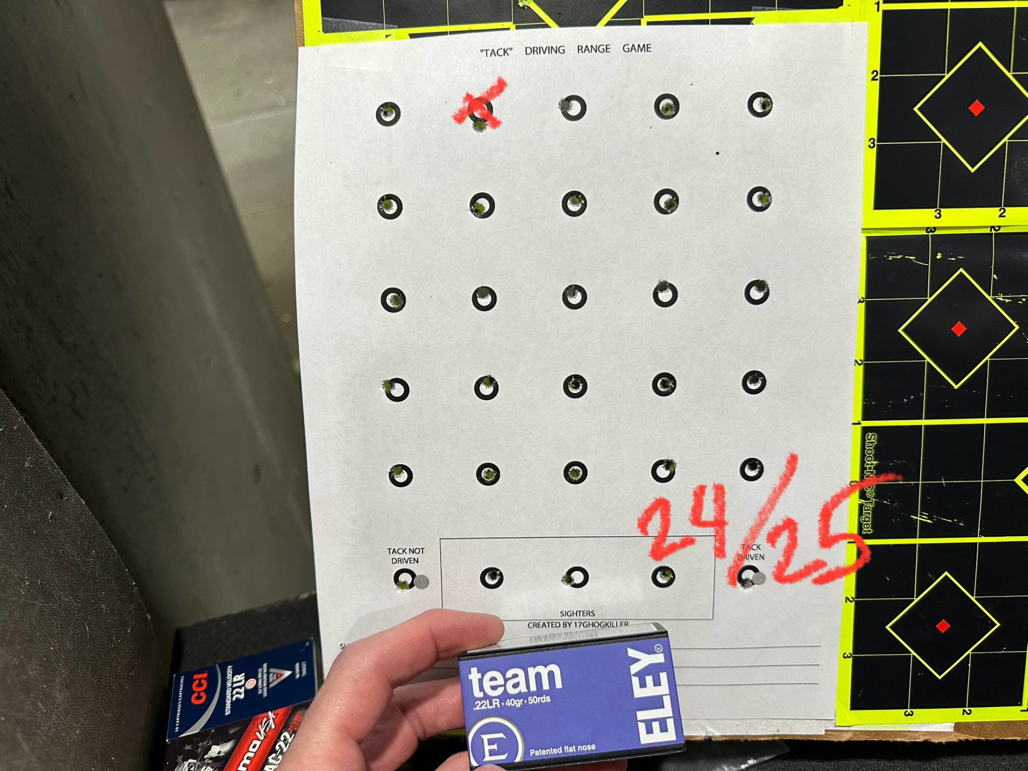

    It seems to like Eley Team pretty well:

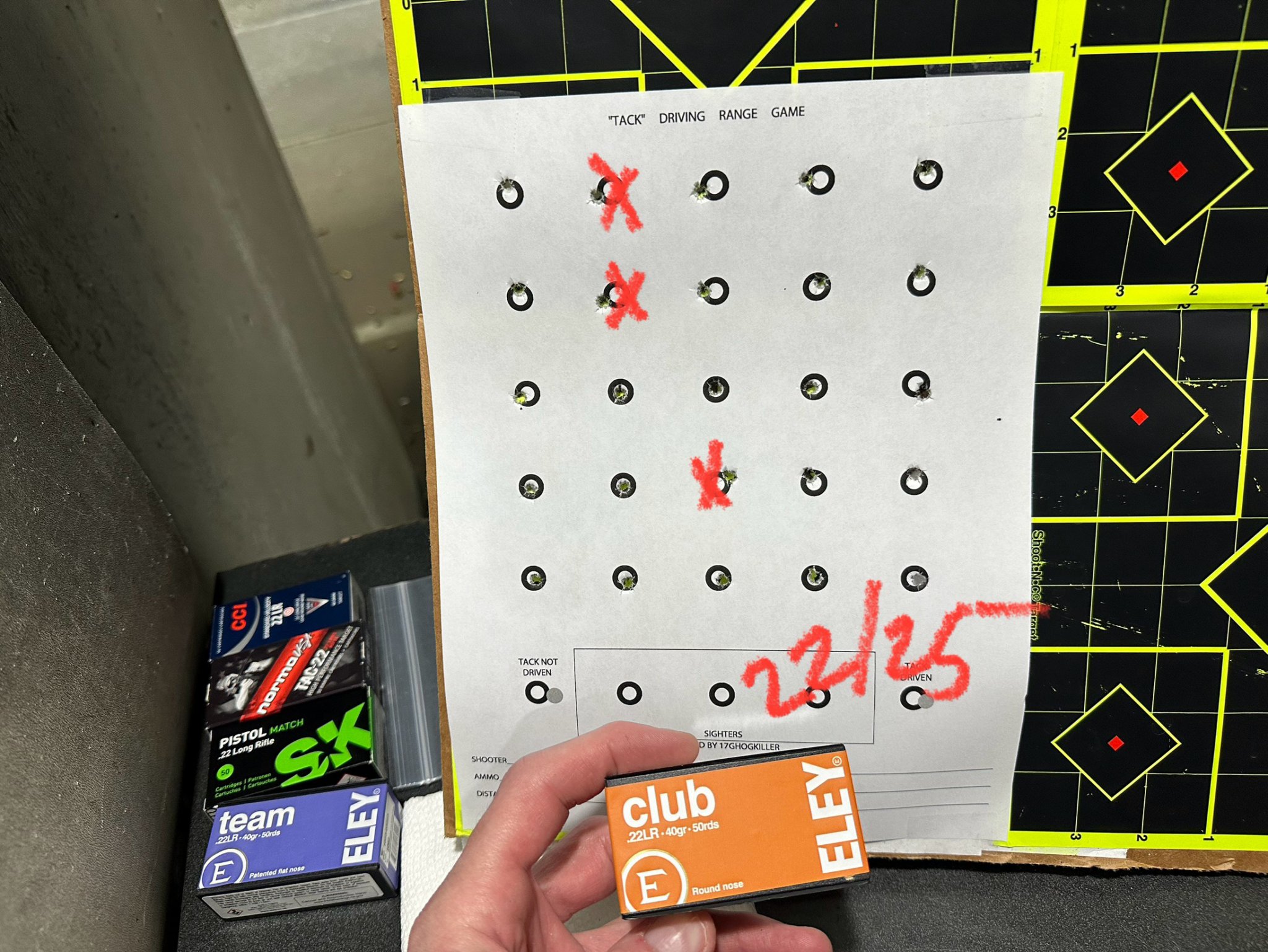

    Club did pretty good, I adjusted the scope windage after the first two rows. Club was the first ammo I shot today and never adjusted the scope again.

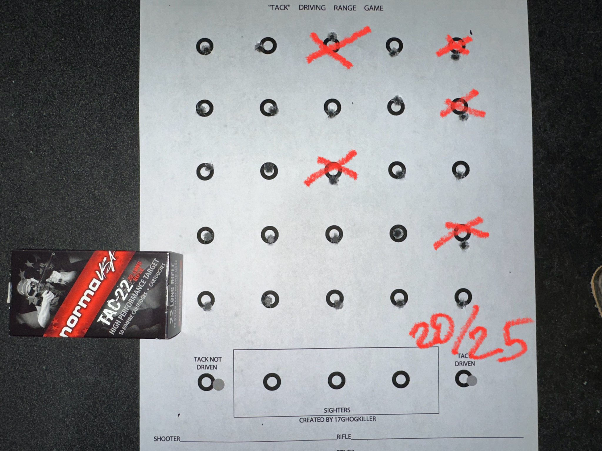

    Norma TAC-22 wasn't too consistent.
    The rifle, posed for picture before any shooting, didn't actually put any CCI-SV through it today:

    It's been my belief that SK Pistol Match is just the next lower grade of SK below Rifle Match, followed by Standard+ then Magazine. I have two lots of SKPM. A half case of one lot and a full case of the other. The half case (that was the limit from Champs at the time) is better than two lots of Rifle Match I have, the full case of PM isn't as good...this box was from that full case. So it didn't surprise me that it wasn't as consistent as other ammo, but to have it nearly match the holes on those ten targets is what made me think there's something else making it "print" this way. I shot the targets left to right for each row, and each row top to bottom. When I decided to shoot the bottom two rows again I shot the bottom row left to right, then the row above it...also left to right. So, the rifle was moving around for each row...the front rest and rear bag stayed where they were the whole time other than adjusting for aim. I never moved or adjusted the height of the front rest the whole time I shot today, just adjusted the rear of the rifle on the bag for elevation of the aim. Hope that makes sense.

    The SK PM results had nothing to do with it being a so-called pistol round. Pistol Match is made on the same production run as SK Rifle Match and SK Standard Plus using the same components including powder.
    What should be kept in mind is that SK ammos are entry level .22LR match ammos which means they are more affordable than top tier varieties of match ammos. With entry level ammos, including less expensive Eley varieties such as Club, Target, or Sport, there may be a wider variation in performance than in better grades. In short, some boxes or rounds within a lot may be much better or worse than others.

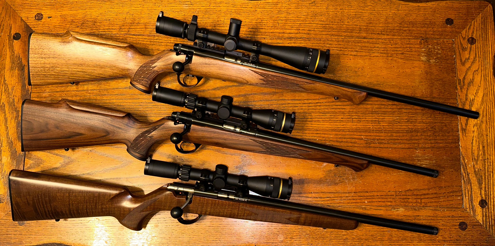

    I have three Anschutz rifles; 1416AV, 1712AV and 1712 Silhouette, all three shoot incredibly well. The 1712s both had ejection issues when they were new, don't know if that was a break-in issue or if it was an operator issue. They would fail to fully eject spent casings, where the casing would land in the action. It happened pretty regularly, once or twice in a 5 round mag...that issue has all but disappeared with both of mine, maybe happening once in a hundred rounds. I put 200 rounds through the 1712AV yesterday and it happened once.
