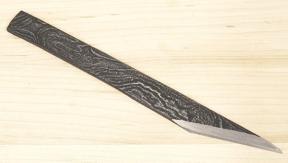

    Blade Grinds vs Actual edge: The blade is ground hollow, V, fat, flat. The edge is always an angle, even the wee kiridashi who;s blade is flat on one side and a lower angle on the other, but still razor sharp.
    I'm currently working on something like this. It;s all free forge so far, just need to planish the angle in. It's for a lady who wants to put it inside her thigh. I'm thinking of highly polished whatever on the scales about 5" long with a slight curve and maybe 3/8" in diameter...I'll just smile and let her figure out if it has multiple uses ???????
