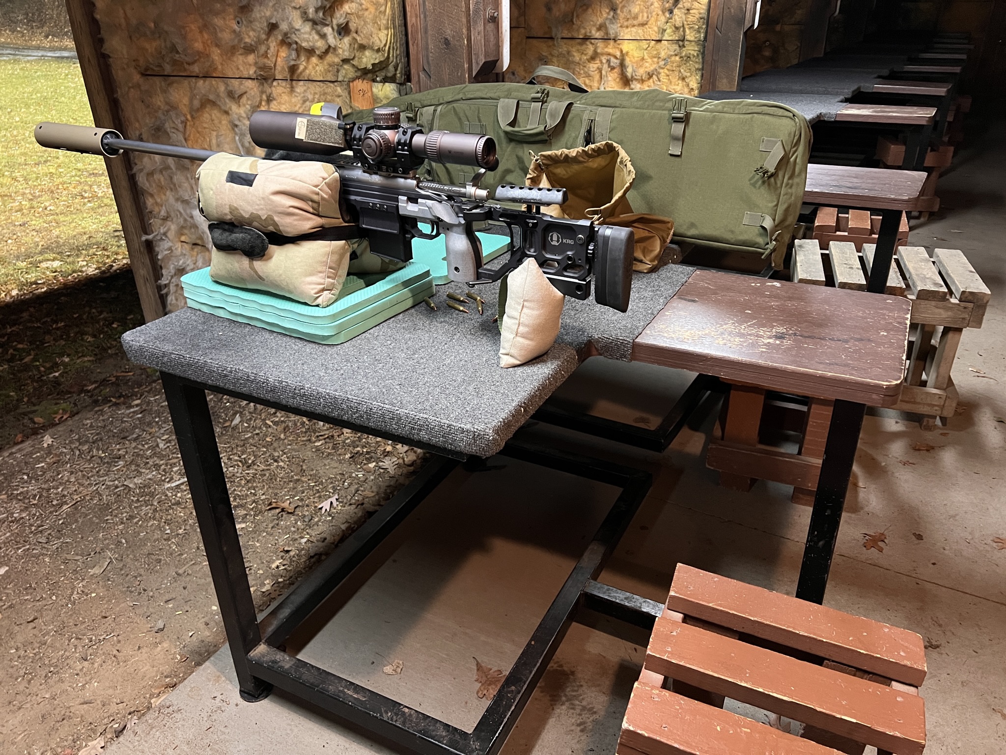

The bags don't allow me to get up from the shot, without securing the gun somehow.
Rifles in my bag setup don’t move when I walk away.
My bag was made by a now-defunct company called Doggone Good. Armageddon acquired the design and, as mentioned, makes them now. They are might be a little different than the Bulls Bag @Baron23 posted in that they squeeze the gun as you push it into the bag, locking it in place. But Baron says below they seem to operate the same, and I believe him. I should’ve better qualified my above statement.
If you really want to lock it in, the owner of Doggone Gone said to place that drawer liner stuff, the rubber bumpy rolled sheet, under the bag and also under the rifle (in the notch).
I shoot low-recoiling rifles so I don’t do that.

Buy a better front and rear support. I suggest that Armeggon bag and @Enough Said ‘s Comprimise rear bag, but whatever you’d like.
Then, relax, become a meatbag. Don’t want the gun to bounce off of your rock-hard pecs lol.
Square up to rifle, do not sit at an angle like everyone at the range does. Again, this is to allow recoil to push you straight back, and all this helps you spot your own shots.

They are a little different than the Bull Bag @Baron23 posted in that they squeeze the gun as you push it into the bag, locking it in place.
Ah, no I don't believe that they are different. The Bull Bag def lock the gun in...IMO, best way is to pull out the bottom two parts of the X apart but I suppose just pushing the gun down into it would do the trick also.
Now, I can't attest to this, but the owner of Bulls Bag was pretty vehement that Doggone Good copied his basic concept, that his design is patented, so theirs is inferior to his.... but....I mean, its a fucking X bag. How many ways can you make one?
Oh...and the DOA shooting bench...I get a chance once a year to participate in some crop damage permit whitetail hunting and the guy whose deal this is has two of them that we set up on a flat bed trailer. They are older...and I can't swear that they are the same brand name...but they look identical. Swivels, right? and seat height can be changed by pulling the pin and moving it up and down (and yes, reinserting the pin).
Same, right? They are brilliant for what he uses them for which is shooting the shit out of a bunch of deer that are just destroying corn and soy bean fields.
Cheers
Reactions: carbonbased
Now, I can't attest to this, but the owner of Bulls Bag was pretty vehement that Doggone Good copied his basic concept, that his design is patented, so theirs is inferior to his.... but....I mean, it’s a fucking X bag. How many ways can you make one?
You are right, I should not have said that I think they are different since I haven’t used a Bulls Bag. I’ve fixed my prev post.
The bags are made a bit differently, however. Look at the seams on the edge of the X. Not sure if it makes a whit of difference.
Edit: one thing I’d warn someone away from is using any fill material that absorbs water. Seems like some Bulls Bags use cat litter? Not sure what AG uses in their model.
Mine is filled with a polypropylene regrind which can be found where plastic is recycled (check yellow pages under lastic), which is apparently ground up 5 gallon buckets.

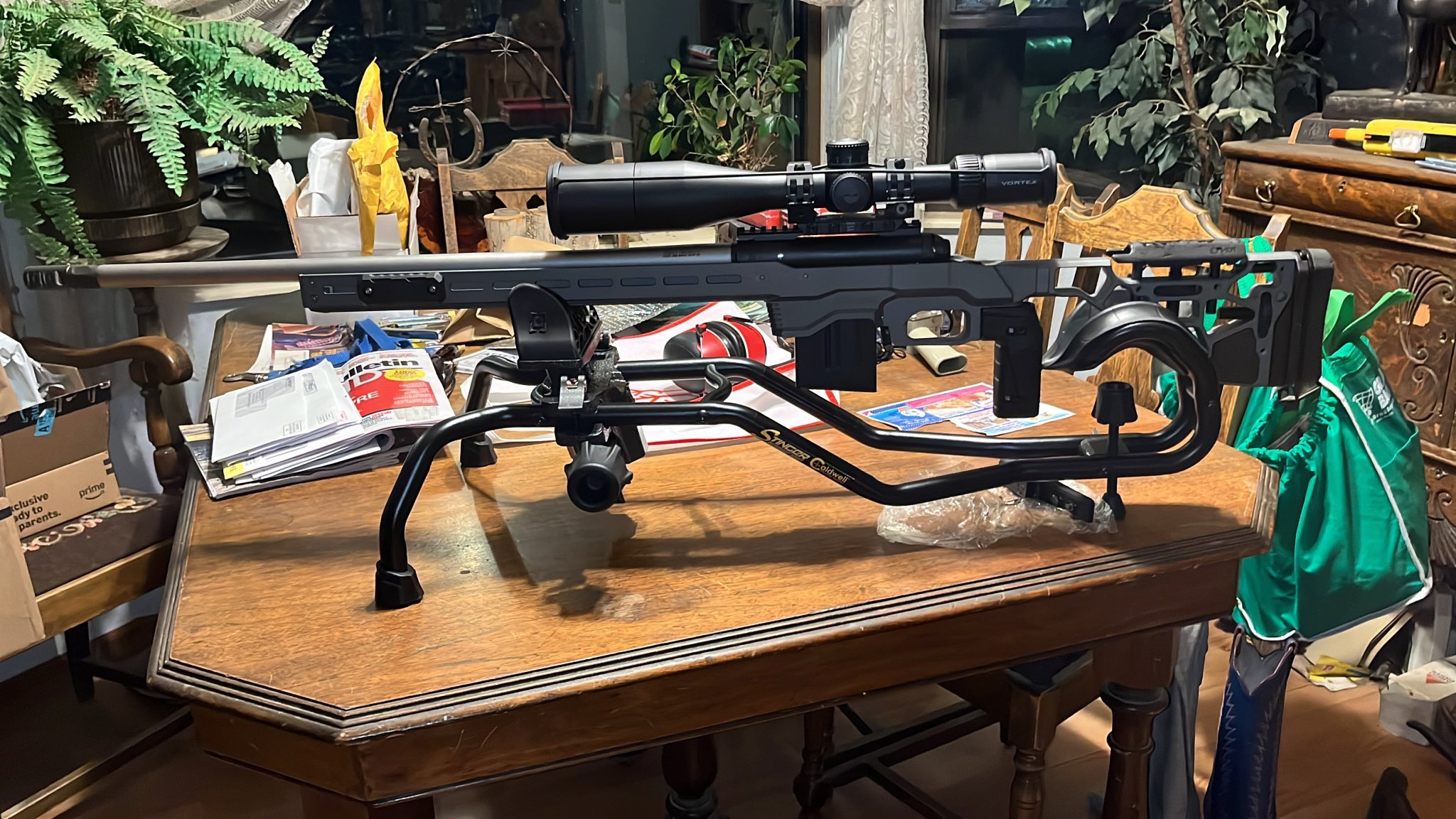

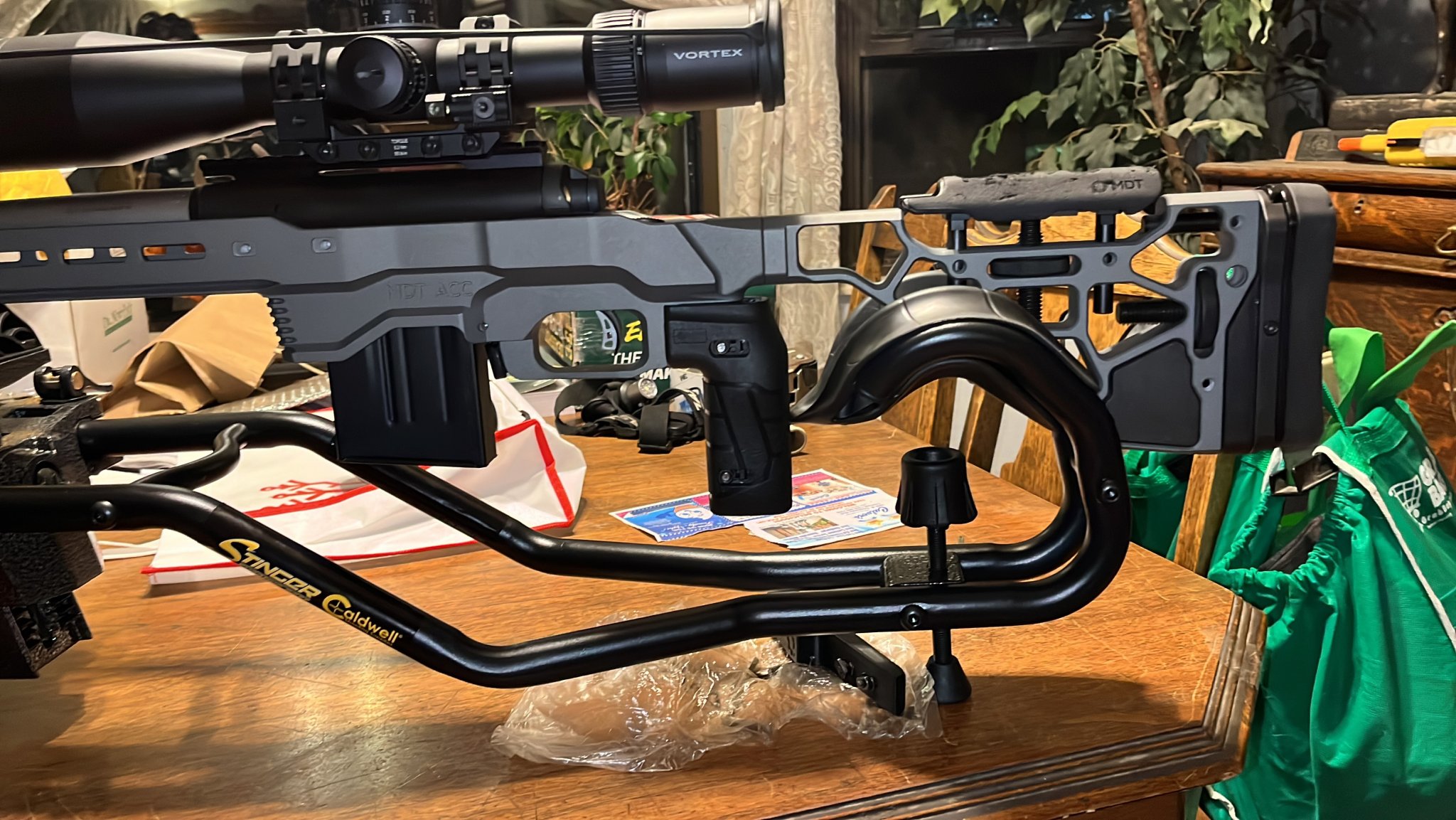

Right now, I have to be able to remove my gun and get off the the table for my friend to swap his onto the table in a few seconds. I'll have to figure out a way that we can better share the same space, but offer a bit more stability, and be able to switch pretty quickly.
I did get the Caldwell Stinger yesterday, and I assembled it. It's actually pretty nice, but sadly it doesn't fit my MDT chassis very well. I tried several configurations, trying to see if I could find a way to use it. I removed my front weights and I removed the magazine (I don't use it right now anyway)...and tried to slide the whole gun backwards on the device. I even considered cutting the rear pad on this thing, so see if I could get more clearance.
Sadly, it's also just a bit wide where it curls around at the back. It prevents good hand/wrist form, having to arch my wrist to bend around it.
I may just go get a bipod today and try that. Not sure what the long term solution will be here.
Well…the x-bag bag I use weighs 14lbs and the rear bag is maybe a pound. The green risers are foam knee pads so they weigh almost nothing.
It would take 10 seconds to remove that stuff from a table, tops.
Nothing is going to be as light as a bipod.
You can shoot off a backpack too. Fill it with something soft. Look at Henry at 9Hole Reviews on YT (the Asian guy). He often shoots off a backpack out to 1000+ yds.
Either of my DIY table ideas are pretty cheap and better than those poly folding tables.
That Caldwell looks like a piece of crap lol

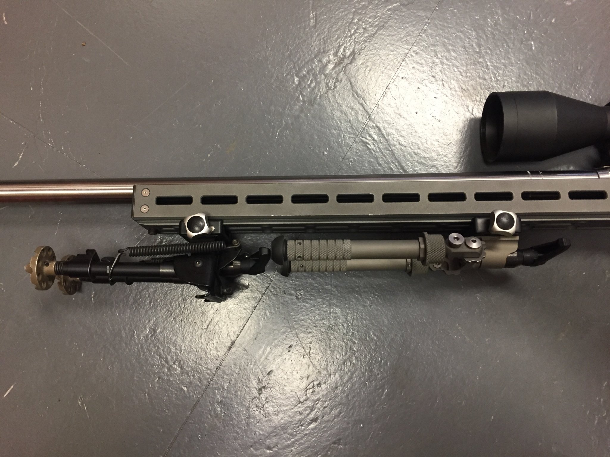

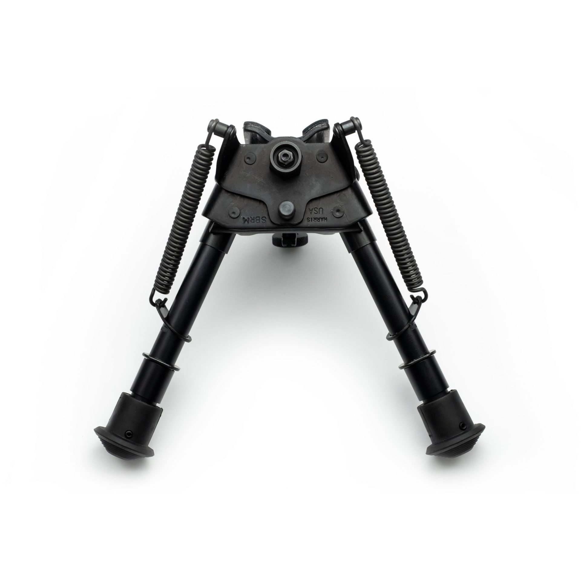

Also, bare minimum buy a Harris bipod with notches (not the infinitely adjustable-height one). But if you do that you’ll need a bunch of mods to make it work with your setup as they attach to sling swivel studs.
Otherwise an Atlas CAL, some flavor of Accutac, a TBAC, or my fav, the LRA are all good choices, albeit expensive.

Yeah, I agree this may take some time to work out. I'll look a bit further into some options.
The Caldwell thing is actually of decent construction. If I had a standard rear stock, I would keep it. It's almost good enough to keep as a gun vice, but if I'm going to have a vice....I probably should have one that actually sinches the gun down better for those purposes. :)
Return the sybian. Get your money back.
You have a rifle with a nice chassis, get a seminice bipod at least to take advantage of the chassis.
Go buy a 6-9" swivel harris with notched legs, your local place probably has one on the shelf.

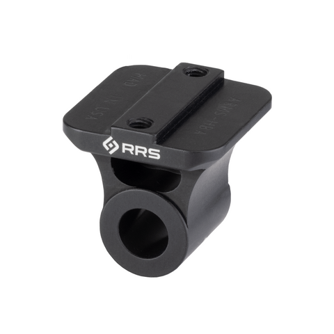

Replace the harris flimsy sling stud only mount swivel with this new adaptor piece.
Put this second clamp piece on that first adaptor to make use of your swivel bipod with your chassis built in arca rail.
The two together will look like this, you will be able to mount the bipod anywhere along the length of your chasis forearm with the build in arca clamp but you can also mount it on any picatinny rail too, its a two in one clamp.

Thanks for the images. Ok. Yeah, my friend has the same MDT Chassis and he uses the ARCA Rail to mount his bipod. I think he was able to buy a bipod that may have already come with the ability to mount directly to the ARCA rail. Should I be looking for something specific in the features of the bipod, other than the ability to attach it to the ARCA rail?
419 does make a mount and sell a clamp-bipod combo, its just arca though instead of arca/picatinny both so I sorta prefer the rrs version personally.
You would want the hbrm-s arca option
