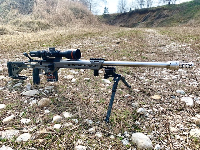

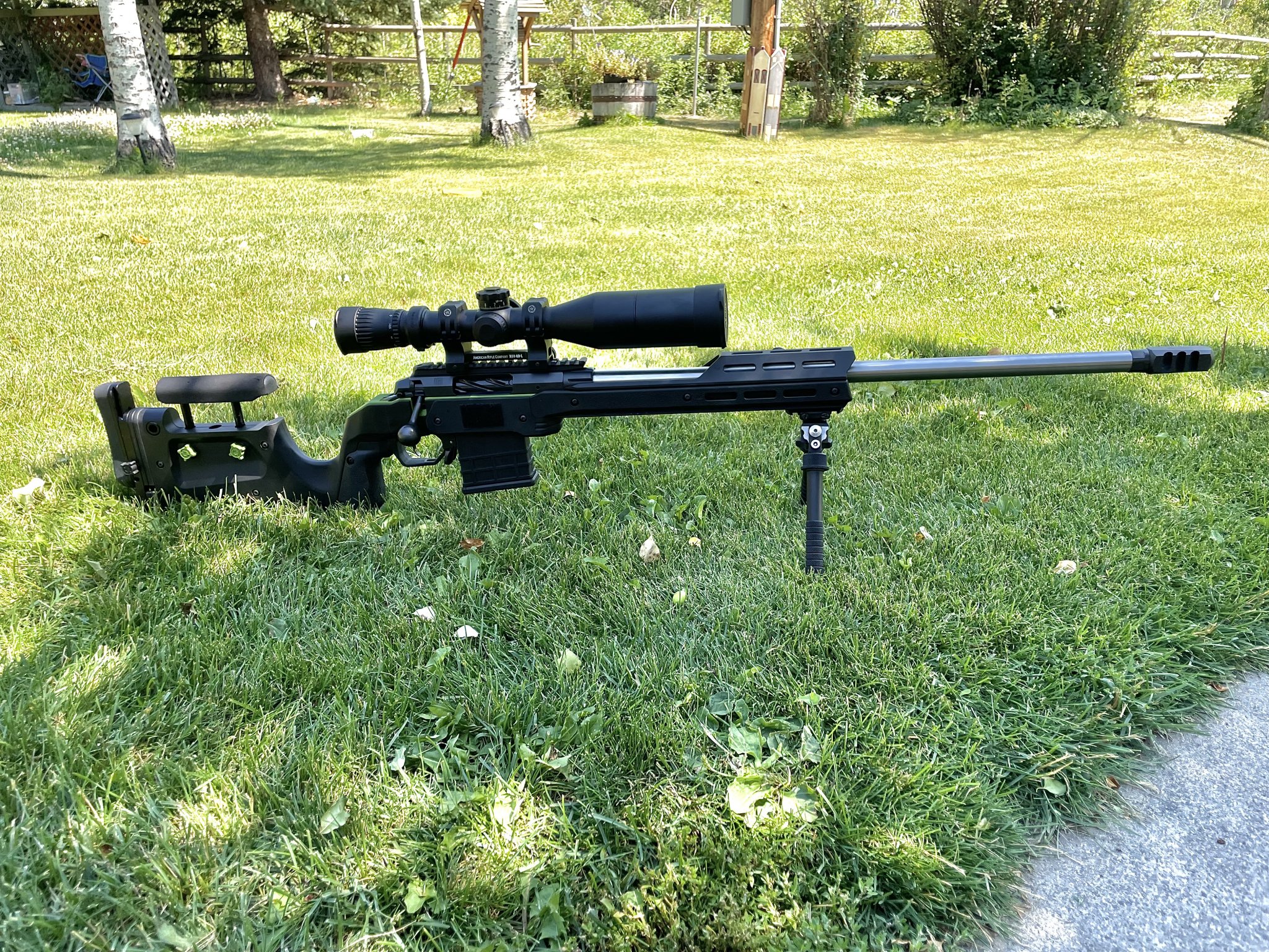

Here is my Canadian build.
Ultimatum Deadline action.
IBI 1-7.5” twist 6.5 Creedmoor spiral fluted barrel.
Ultimatum and IBI are one and the same company.
You can buy the barreled action assembled.
MDT ACC Premier chassis with the SRS Short buttstock.
I needed a 12.5” length of pull otherwise I would have gone with the ACC Elite chassis.
MDT Ultimatum Compatibility Kit (shorter mag latch and a thicker washer for the rear action screw. ($50.00) Canadian.
I went with a Trigger Tech Diamond 2 stage but you can save a few bucks by going with the Special.
I wanted to keep the build all Canadian so I topped it off with a Tangent Theta TT525P.
If you want to go with a custom action there isn’t much available in Canada unless you want to wait a long time or spend a crap ton of money.
You can also look on the equipment exchange on Canadiangunnutz you can look for actions for sale. As long as you pick an action that accepts Savage small shank barrels you will be ok to assemble it yourself.
Here is a pic of the rifle at Dead Zero Shooting Park in Spencer Tennessee this past Friday.
Here is a link to the thread I posted about my visit.

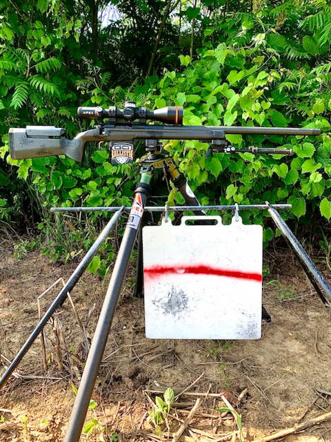

Here is 2 different ibi barrels, one on an ultimatum deadline and 1 on a lone peak
Then here is on of my ks arms barrels on an impact.

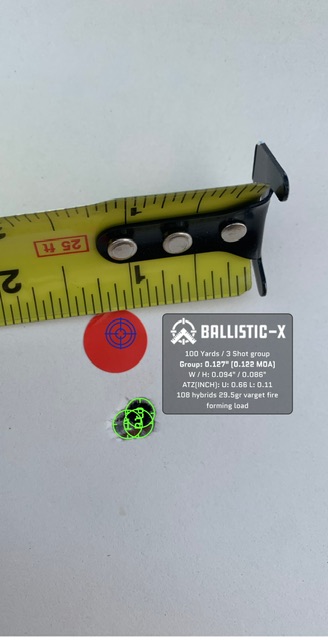

Here is a another mostly Canadian build on the slightly cheaper side. Ultimatum gen 1 action that I bought used off CGN, IBI 1:8 223 barrel, MDT elite brake, MDT XRS chassis with enclosed forend and adjustable butt.
Really like the Ultimatum action. I’ve wanted to try one for a long time but when Ultimatum went dark a while ago I held off. After IBI bought the company I was finally confident to get one because Ryan is a great guy and I have confidence he’ll do great things with the brand and support his products.
Wait a minute for his new HMB action if you’re on a budget. That action plus an IBI barrel and a XRS chassis would be a great all Canadian budget conscious rifle.
