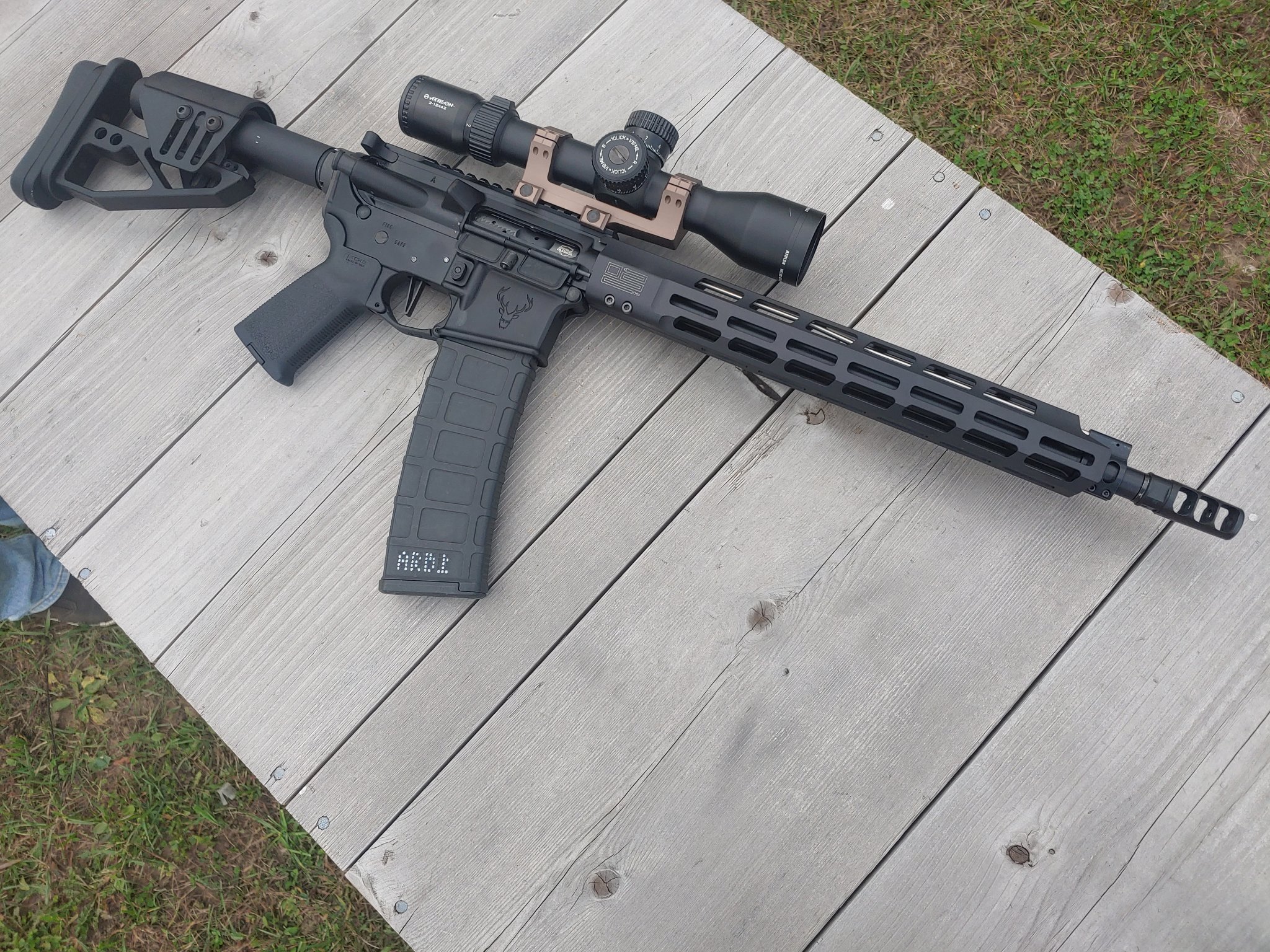

Yes, that's a 14.8" barrel with a rifle gas system. I bought it as a cheap experiment just to see how much tinkering it would take to get it running. Turns out the answer is zero tinkering. Just a standard rifle with a low mass carrier, whatever spring and buffer was installed from the factory and a .09 ish gas port. I'm only about 100 rounds deep into it, all either mil spec equivalent or lighter loaded 55gr ammo, and it consistently ejects between 2-3 o'clock and locks back using Pmag 30's, 40's and a D60. I'm not anywhere near trusting it or recommending it for anything besides a range toy, but I am pleasantly surprised.
Yeah the contour is definitely reminiscent of the BA Hanson.
Recoil is pretty light for not having any spring/buffer tuning and only a very mild brake. I can't see an adjustable gas block helping, it's gotta be running borderline undergassed already.
I can't really comment on the exact amount of dot bounce while looking through a scope mount, but it appears minimal.

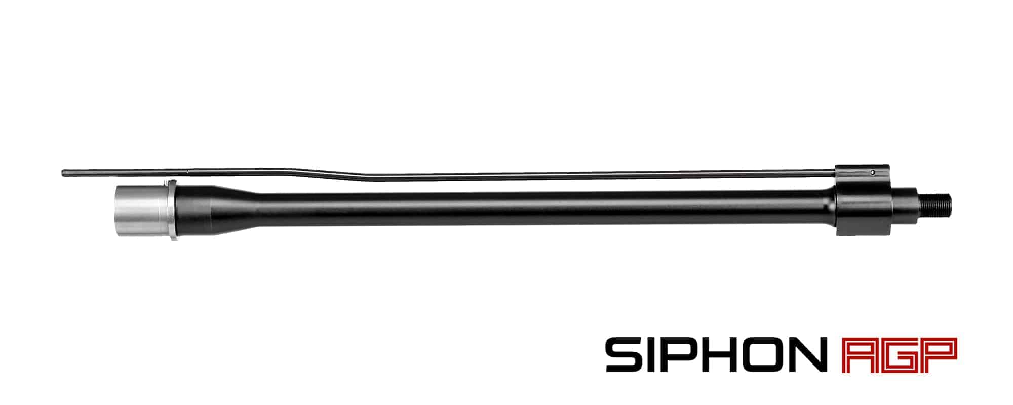

MicroMOA experimented with an angled gas port on a handful of his barrels and realized you can get away with a noticeably smaller gas port size. But he said that it was a PITA to drill the angled gas port.
MicroMOA went out of business right after I got into AR's, but I do remember them having some pretty unusual lengths, contours and gas system combos.
It's different for sure. I've been contemplating how this barrel could work for over two years now, finally gave into my curiosity and bought one.
Your post has piqued my interest as well... from what I can tell, the barrel uses a "normal" gas block ? ( Which begs to ask the question... would an angled gas block help more ? )
I can't help but wonder how much the angled gas port helps felt recoil v. a gas port size "tuned" for "mild" cyclic operation.
That comment is not intended to imply angled gas ports don't work / help felt recoil and allow for less pressure dwell time.
I have always felt gas port size's could be better optimized, or at the very least more carefully chosen for a specific barrel length and gas system length being used.... and the intended use of the AR. And most certainly, I think that in context to Large Frame AR's.
If, I had the time and money, I'd love to do a "Filthy 14" abuse test with a barrel just like this ( Last total round count was 67,500 ? and no cleaning )
I am super curious how "sluggish" it could get and still run.

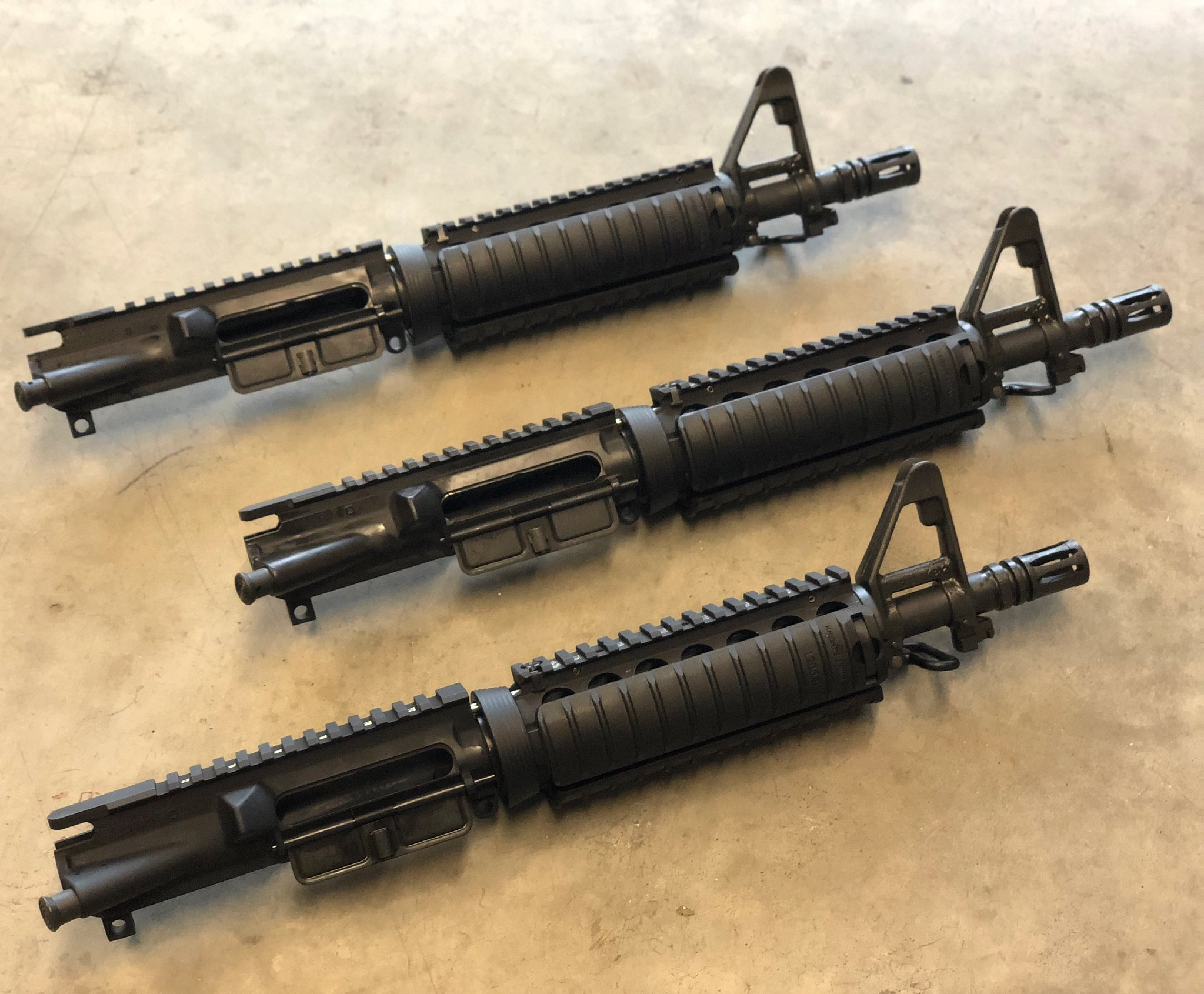

Years ago..... when dirt cheap surplus 5.56 roamed the Earth...
I tried a Colt 20" HBAR barreled RLGS with as heavy rifle length buffer weight possible , with a Tubbs CWS 4.2oz setup added to the BCG, and a Tubbs 5.56 Flatwire recoil spring... I couldn't get it to choke on any brass cased ammo, even PMC Bronze 55gr. ( Never been a fan of steel cased 223 ) And granted I didn't try it in cold temps... but I was surprised the heavy weighted reciprocating mass just kept on running.
I realize my comment is an "Apples to Oranges" thing to your tested barrel and firearm setup, but it does show, between your setup and mine, how versatile the AR platform can be.
Yeah it's pretty interesting to try things that conventional wisdom insists won't work. I've tried enough odd combinations at this point I'm often baffled at how many mil spec type home builds won't run.
My understanding of dissipators is that they are 16" rifle gas barrels. I have two of those and they work great, but this being a 14.8" barrel makes it quite a bit less likely to function because of it's extremely short dwell time.
Original dissy was a 20 inch barrel cut back to 16 inches and leaving the gas block in place as was

I guess I shouldn't say undergassed, it clearly has enough gas to function. I should say that the dwell time is probably on the very edge of being long enough, and any shorter it would be out of time.
Tony, I think you've found a very nice "Sweet spot."
Just by your short video it obviously cycles well, without choking (based on a single magazine). Once you've run 500 rounds through it, I think you can definitively say, "Yeah, it works."
Your "Dwell spot" isn't much different than a 633/733 short Commando.

Just did some measuring, my 15" intermediate barrel has 3.5" ish dwell length, 16" rifle is about 3.2", 10.5" carbine is 2.8". My 12.8 mid is out for cerakote so I can't measure it. Didn't measure the 13.7, 14.5 or 18" rifles. All that to say this 14.8" rifle gas has 1.8" of dwell time, on the OD of the barrel, probably 2.1" ish on the interior because of the angled port.
GI 633/733s are carbine-length gas system (7-inch fore-ends):
So very similar to my setup. I've noticed that very short barrels with short dwell time seem to be common and more accepted than longer ones. I wonder how much the higher port pressure helps them run vs. the significantly lower port pressure of a rifle gas system.

I shot a lot of handloads through it (maybe 500-1000), ran it is weather but nothing extreme. I ran it for 3 days at the Steel Safari train-up put on by Brian Whalen, its talked about a bit in my blog post on the course:
I ended up using a longer barrel mostly for higher velocity gains for the Steel Safari, but not because this barrel was a problem, I just wanted more velocity for longer targets.

sent this link over to a friend who is a big fan of dissipators but loves the length of the standard M4, and he's already ordered all the parts :ROFLMAO:
Good stuff, and thank you for the testing, seems Siphon AGP has a very solid product to run that well when intentionally put in bad conditions
Can't remember if I mentioned it above or not, but I have one of the 16" AGP's also, in my dead barrel pile. I think it went 11-12k before accuracy became unacceptable. Not that it was ever a Bartlien, but they seem to shoot pretty well across my two AGP samples.
