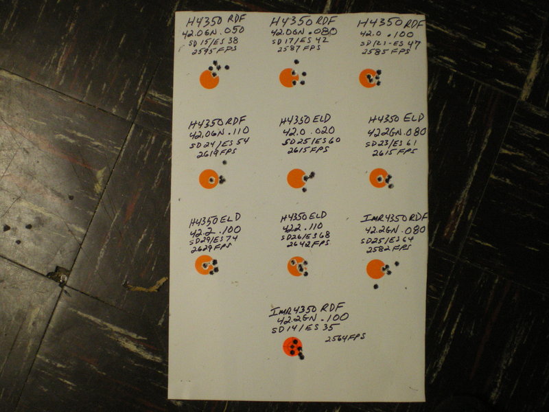

So I chrono a bunch of my 6.5 Creedmoor reloads and I can't get them out of the 20's for standard deviation.
Tikka T3 CTR rifle 20" barrel
Brass full length sized.
Shoulder bumped back .002
No Neck sizer bushings used
Same headstamp brass trimmed to 1.910
Primer pockets cleaned and uniformed
Federal Match Large Rifle primers
Flash hole work done
Auto powder measure with the same powder charge for each round
All bullets seated off the ojive with Forster Ultra Seater Die
Hornady ELDM and Nosler RDF 140gn bullets used
Diamerter of neck with loaded rounds .290
5 shots per each load and bullet mostly IMR 4350 and H4350
Standard Deviations run from low 20's to high 20's with spreads from low 20's to mid 60's. Velocities average 2550 to 2600. But I cracked 2736 with Reloader 17.
Even with the Hornady ELDM factory 140gn out of the 20" barrel gave me avg 2590FPS with standard deviation of 27.0 and spread of 76
Is it possible that the 20" barrel is not capable of obtaining low standard deviations?
I'm going to try different primers first. I have read that the S&B large rifle primers have a lower SD than the Federal Match Primers.
Is there something I'm missing here that I should be doing? Any help would be appreciated.

Well I managed to get some consistent SD in the 8's today with the Nosler 140gn RDF with the ladder test. The Hornady ELDM'S are a work in progress but it looks like the rifle is liking the RDF over the ELDM.
This is what I found today doing my ladder test with the Nosler 140gn RDF with 42.0gn H4350
The first thing I noticed is that the Federal Match primers have a higher SD than the standard S&B large rifle primers. The S&B gave me better SD and spread than the Federal Match primers
5 shots with varying depths. S&B Large Rifle Primers.
.050 off lands
SD 12.2
Spread 29
Velocity 2522
.060 off lands
SD 12.3
Spread 30
Velocity 2537
.080 off lands
SD 8.8
Spread 23
Velocity 2522
.100 off lands
SD 8.9
Spread 21
Velocity 2511
.110 off lands
SD 8.7
Spread 21
Velocity 2519
I'm going to load some to .120 and .130 off lands but it appears in my Tikka T3X CTR likes the shorter I go the better the results with the 140gn Nosler RDF.

Thanks all for the suggestions so far. I annealed my next reloads and am ready for the range. Just waiting on my buddy to get his new chrono. I will report back with the results.
I recently went through this with my load development. I can shoot out to 1500 yds, so ES is more important to me than SD and while I was getting SDs of 10 or 11 and ES of about 30, it was a little too much. I think the most important aspect of a load is finding the flat spot for velocity, i.e a range where the amount of powder doesn't really effect velocity. This will help account for scale inaccuracy as well as changing temperature extremes. I started with an OCW load and found a accuracy node. Next I fired a traditional ladder test at 300 yds to find a flat spot and see if they correlated. After doing that I tweaked the load in .1 increments where I got an SD of 4-5 and ES of 19.
I load on a Forester Co Ax with Redding S type dies using a .290 bushing without an expander. I use Lapua cases lubed with imperial sizing wax. I follow that with a Sinclair expanding mandrel. I then brush inside the necks and finally prime using a Lee hand primer. My components are Berger 140gr Hybrid, Lapua Brass, CCI 450 primers, and H4350. Rifle is an Accuracy International AT with 24" 6.5 CM barrel. Velocities were recorded by a magnetospeed V3.
I also only Anneal every 3 or 4 firings and see my best accuracy on the 2nd firing after annealing. I was talking to Josh at PVA a few months back about this and he said he was experiencing the very same thing.
My guess is you could change neck tension, seating depth or something to match your best performance with fresh annealed cases. Of course this takes a lot of time and components, barrel life and etc. to do the testing. I have a AMP annealer and their recommendation is to anneal every firing and they also state the brass hardens most on the first firing. That being the case I think one might expect to see differences between the first and second firing but who wants to fire the first time after annealing knowing you are giving up anything on accuracy.
Annealing. I never do it and get single digit sd throughout the case life. Annealing is not the holy grail. It is a personal choice in an attempt to increase case life when done right but from what I've seen most don't know what the hell they are doing. For those it is a colossal waste of time and resources. Speed, low sd and es. Don't sweat the small stuff.
BTW, the OP figured it out.
