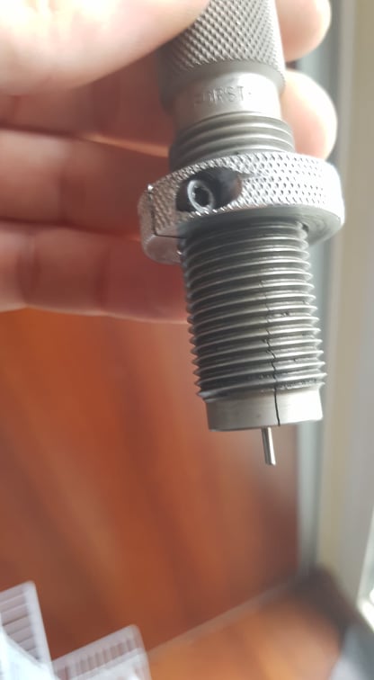

Hi everyone !
I got a problem when I reload my 300 norma magnum cartridges : I break my sizing dies.
I had a forster full lenght sizing die, who broke rapidly (less than 200 brass resized). I thought it was a default of the tool.
Where I leave, my rifle is the only one chambered in 300 norma magnum, so getting a new one is loooooong.

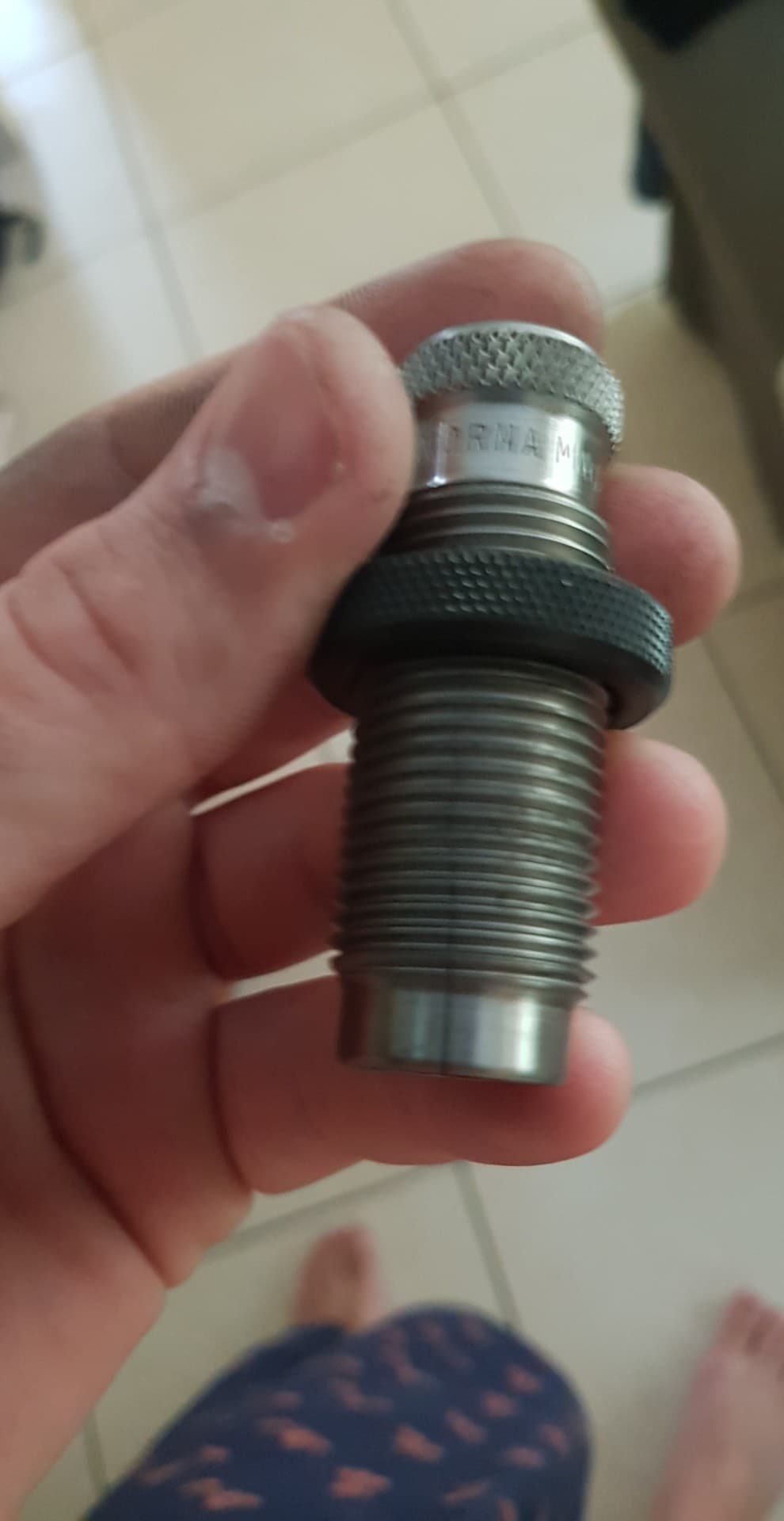

Lucky I am, the friend who sold me the gun had a redding die set (body die + neck sizing with bushings). I love those dies !
But 2 hours ago, I sized some brass, and the redding body die broke in the exact same way than the forster, so it can not be the tool the problem...
Now, I have to order another die, and wait for the shipping with covid-19...
I did not forced on the lever of the press so much, and I use imperial wax, who seems to be very effective.
I need to solve this problem, so I think about differents possible causes, but I am not sure of that...
- Problem with the shell holder ? Maybe this is not well made...
- Problem with the press : I use a basic lee press, and maybe the screw thread who maintains the tool is not enough deep to support pressure of the die when sizing brass...
- Problem with overpressures :
When I fire, it's difficult to extract the brass. It seems to be not so dramatic, and I have no marks on the bottom of the brass or on the primer. The lower section of the brass becomes large, but I have not to force on the lever of the press to resize them.

From the thumbnails it almost looks like the dies are bending and splitting. From that much I am wondering if you are using a C shaped press and putting too much force on it during sizing causing it to flex and crack the dies, or if the ram is worn out and the resulting misalignment is causing the dies to flex. Measure your fired cases and resized cases if you have any and compare dimensions. Check case web and shoulder diameter for comparison, then see if you can compare that to the chamber specs. I still think the issue is with your press though.

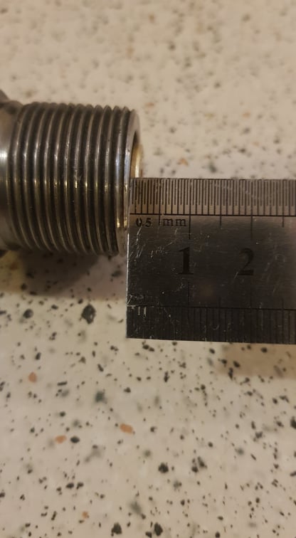

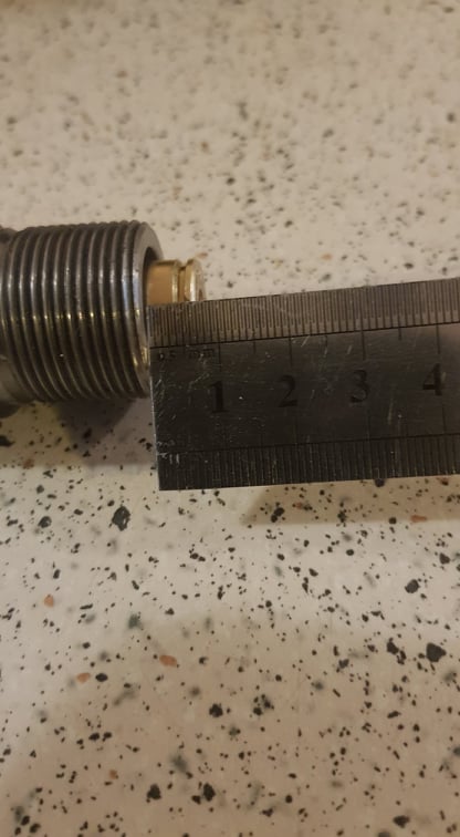

Here's pics of a brass fired and a brass resized entering in another chamber I got.
I don't understand what would be the problem with the chamber, can you explain ? I try to understand it, but this is weird for me...

When I resize brass with this tool, I can feel when I reside the body, and at the end of the movement, I feel the shoulder going down (I think !)
Maybe chamber is too long for the cartridge ? In this case, is this solvable ?

Hi, some news after quite a long time..
I did not mesure cases, but all the setup has change : press, new die just recieved, and new shell holder...
Die broke in the exact same way than the 2 others after less than 100 rounds resized.
Tomorrow i'll bring the gun to the gunsmith to check the chamber.
If the chamber is wrong, is it possible to cut it on an MTU barrel to make a new chamber ?
And if possible, how long will be the cut ?
Thanks !
Thanks !

Hi, here's some mesurements I made this morning before bringing the gun to the gunsmith.
The red arrow represents where the problem is to chamber a fired case.
The only prep. I made on the resized case is redding body die, no cut and collet resized, that explains some differences.
